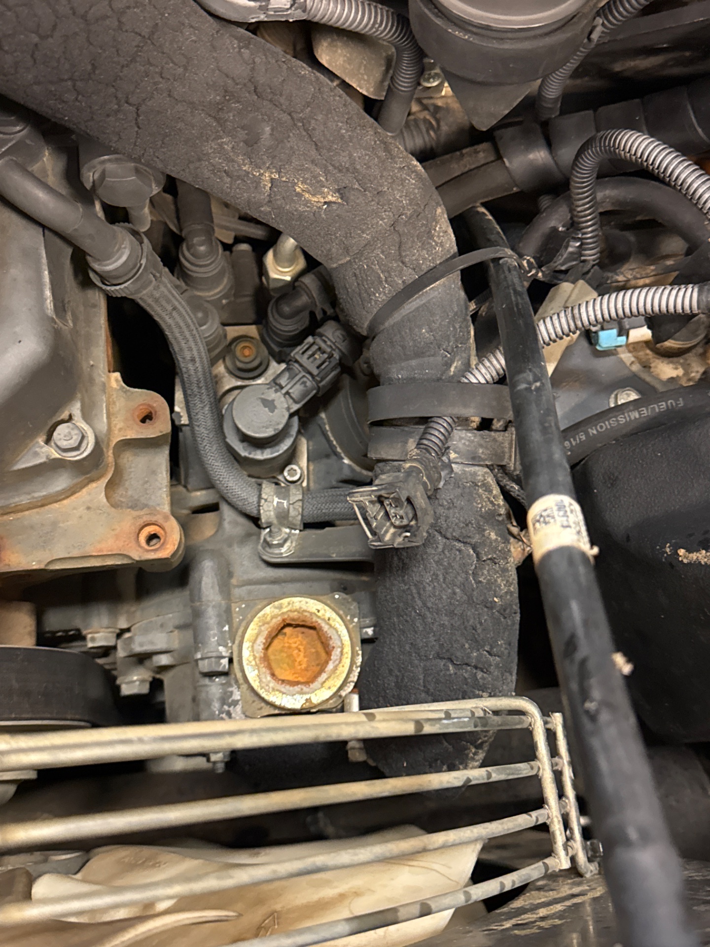

Help!!! I just bought a case tr310 on auction. Got there and they loaded it just fine on trailer after a jump start. Got home and had battery tested and it was shot so got a brand new battery. Engine starts fine and lights on dash all kick on when sitting in seat. I keep getting fault code 9406 and cannot enable the hydraulic functions. The park brake light does not stay on when starting engine and I’m guessing it should bc it automatically sets when turned off. When replacing battery we did break a tiny 16-18 ga wire connected to kill switch but fixed it at that time also.
Have checked all fluids and they are full. There is a loose connector by thermostat housing but can’t find anything it would connect to. Checked all fuses and only found a blown 2 amp ground fuse. Replaced and didn’t change anything.

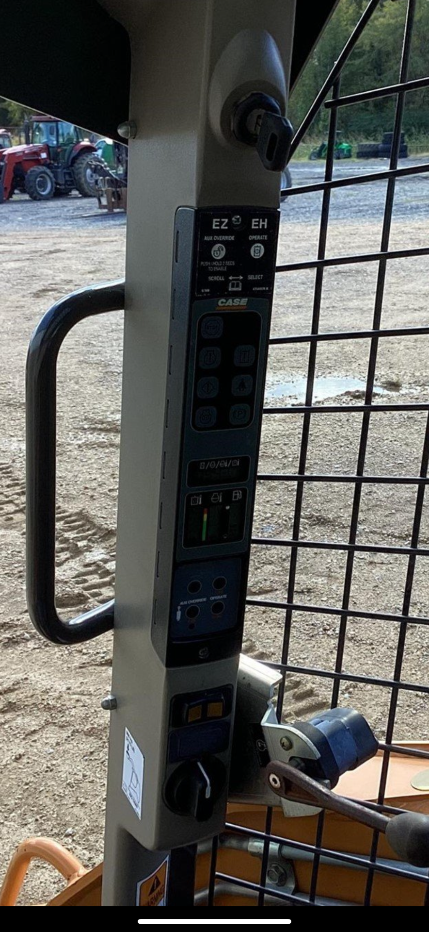

Also since this one has a key switch does it have to be started using key switch. I’ve seen some videos they start using the keypad but this one doesn’t respond.
