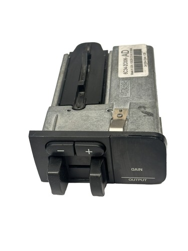

Is the larger truck yours? If it is, put a brake controller on it. You can get a good one for a few hundred dollars and install it in several hours, then you have a heavy duty truck with a brake controller. If not, as the previous person said, have someone else haul it or rent or borrow a truck that is the proper size and has a brake controller. If you were going a few miles on level ground, I would say use either one and go very slowly, but if you have to get out on the highway either would be a large risk and possible liability. Whoops I just reread and saw the 25 miles, ignore my previous sentence.
I have taken the faulty brake controller out if the dashboard and i am trying to fix it. (Bad solder points on the circuit board) I am in a time crunch. I know the prudent choice is neither 1 or 2 but feeling the pressure to get this job.
If your using a bumper hitch with the 2020 GMC 1500 then that's completely out. That truck is rated for 9000lbs tow capacity with the correct hitch. If it has a receiver hitch and you drive carefully, it will get the job done. Go to Enterprise truck rental and rent the proper truck, test drive a used truck from a dealer...lol
Seems the best would be to just fix the F450, replace the part and go

your best resolution is fix the brake controller on the 450, that or again, have someone with correct tow vehicle/trailer, tow it for you!
a lot can happen in a 25 mile trip, most accidents happen close to home you know?/
in my area over a 25 mile trip I will gain and loose a 500 to 1500 + ft in elevation about 12 times, , so not sure what your terrain looks like, but, for me, all them hills here , would kill OEM brakes on a f450 with 13k behind it, I also have DOT check stations in every direction from my place too, HAHA
so, I have to be extra careful when towing larger things!
lots of controllers out there for sale from new to used, that are petty much plug and play, , since you already have one in the truck
a few examples I found on ebay , but there all over the web , it would be about the costs to pay to have your machine moved, so call it an investment, and then in the future you will have more use of your 450, plus add in resale if ever selling!
its worth the extra time to do it right IMO
