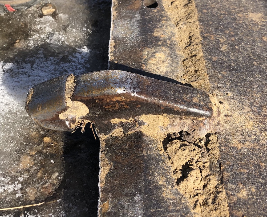

I have an Edge toothed bucket with welded on teeth also crimped on. How in the heck do you replace these teeth ? I emailed Edge no response.
The teeth sit in a pocket and are crimped in.
I was considering cutting/grinding to remove them and get a bolt on set.
Thanks

I think I would cut off a tooth and look at the mount and see if it is compatible with the tooth pocket that you would like to use and then weld them on the mount. That should be a lot less involved than cutting and grinding off the tooth mounts.

View attachment 3519View attachment 3520
cutoff wheel but be careful not to cut the shank. Heat new tooth, install on shank, whack straight on with a hammer to make sure its seated, heat the tooth and use a punch and hammer to crimp the tooth on. Some people tack them too just to make sure they stay put.
