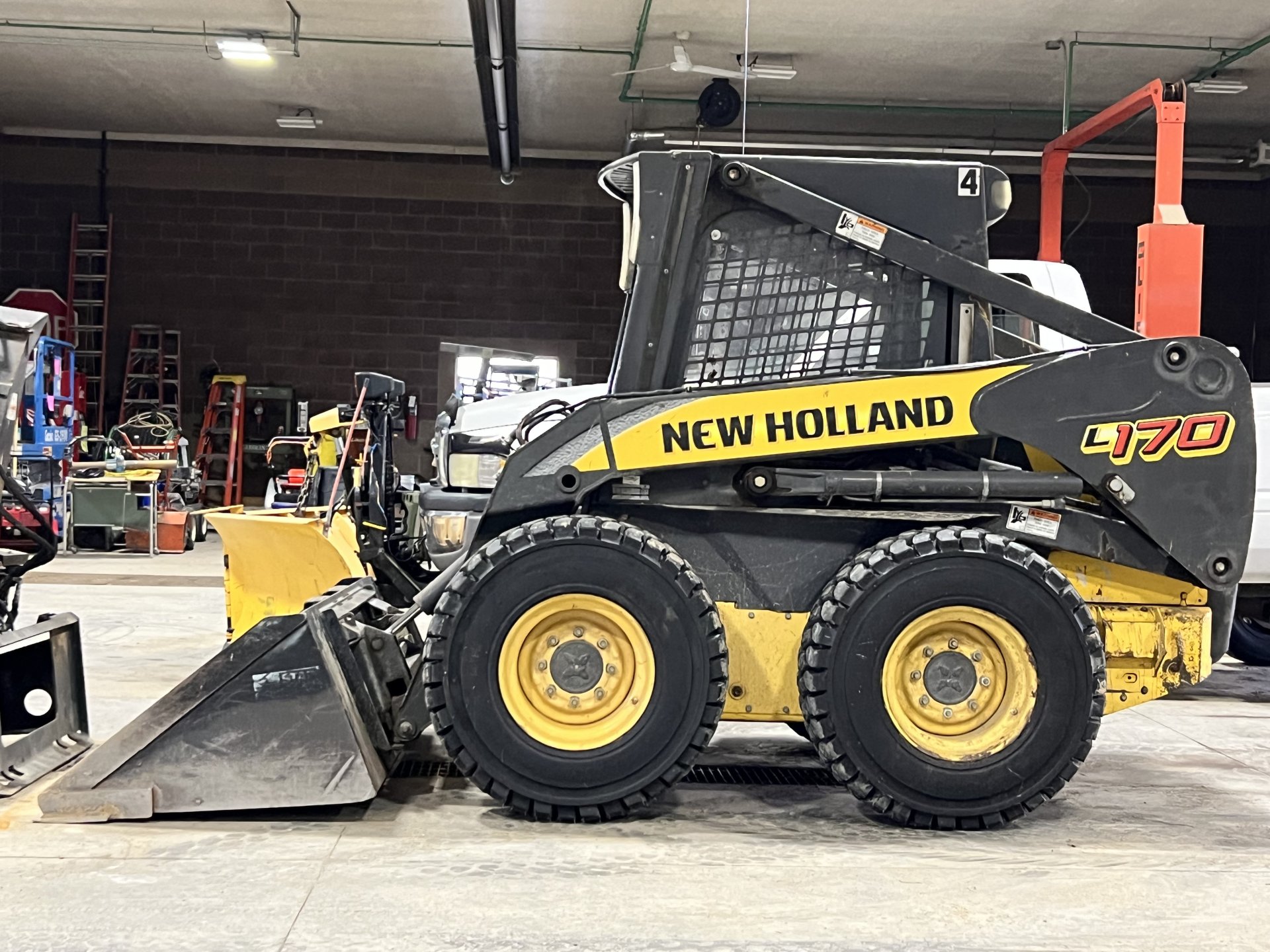

Taller tires will also mean that your bucket will not sit flat on the ground when trying to scrape level with grass or concrete. I swapped 12-16.5s onto a machine that needed 10x16.5s and ended up gouging a lot of grass while moving snow off of sidewalks. Getting new (correct size) tires tomorrow!
Notice how the bucket sits resting at a downward angle
