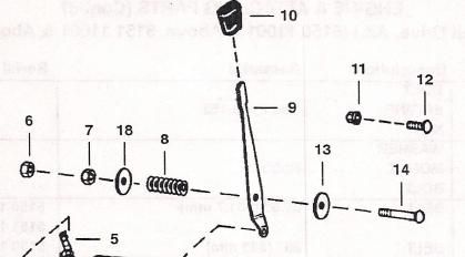

<blockquote data-quote="Bobcatdan" data-source="post: 55281" data-attributes="member: 7339"><p>773 throttles are a little different then pictured, but same idea. There are two allen head bolts on the throttle lever. Those are tighten to set tension. There are wave washer behind it. Depending are where you live, this could be all rusted up. If you do have to take apart, mark the U shape bracket that fits over the top so the adjustment screws stay on the same side.</p></blockquote><p></p>
[QUOTE="Bobcatdan, post: 55281, member: 7339"] 773 throttles are a little different then pictured, but same idea. There are two allen head bolts on the throttle lever. Those are tighten to set tension. There are wave washer behind it. Depending are where you live, this could be all rusted up. If you do have to take apart, mark the U shape bracket that fits over the top so the adjustment screws stay on the same side. [/QUOTE]
