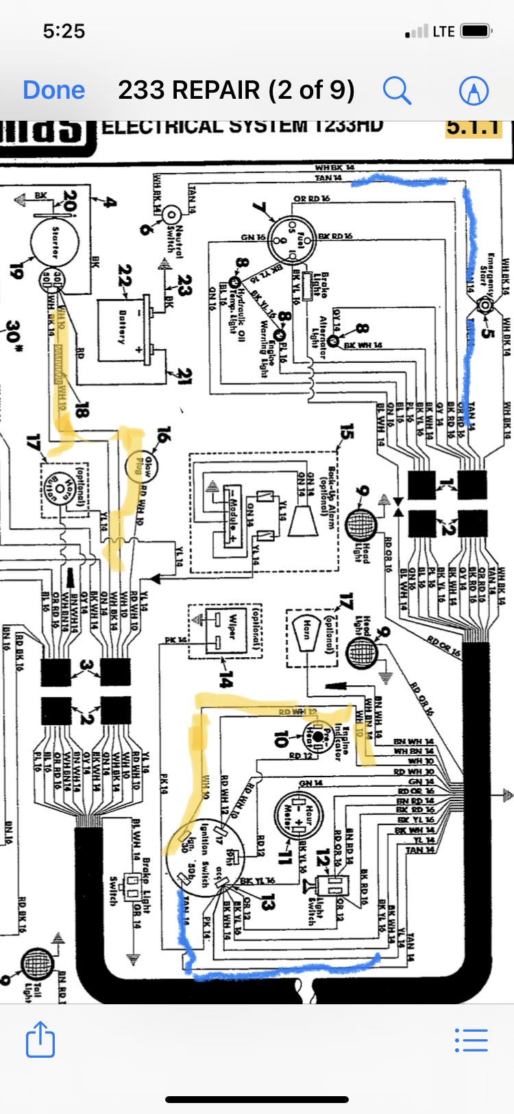

Hi may have misunderstood from drawing key only needs to turn terminal 30 this initiates starter. But if terminal 30 not working then as shown blue marker terminal 50 with emergency start pushed will also initiate starter hope this helps also this is my t233 drawing
