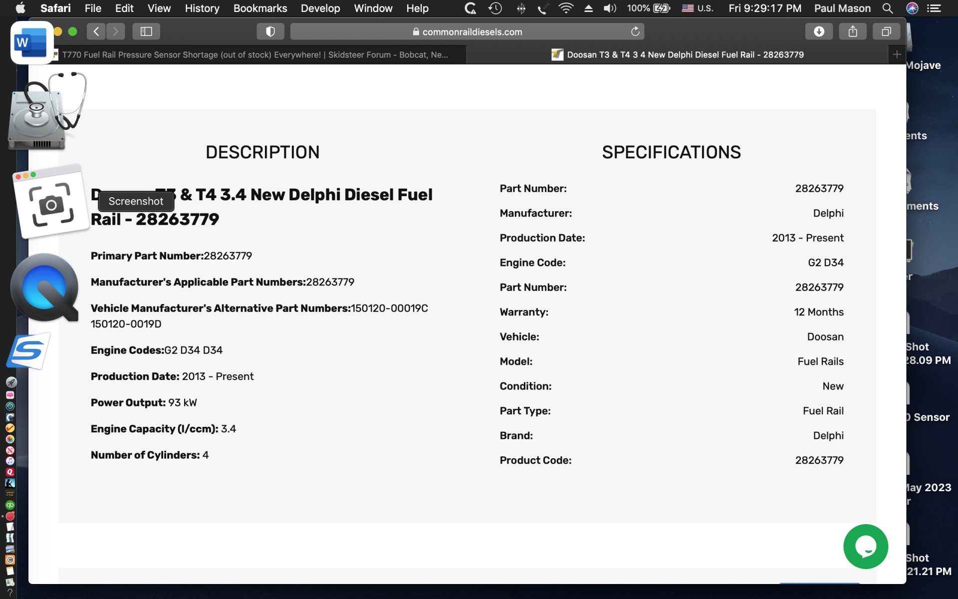

Try 28357705... Again, you might need to modify something for length, but the diameter might be right.
Look up the fuel rail for a Doosan D24... I can find it got less than $500... Not that it's cheap, but it exists.

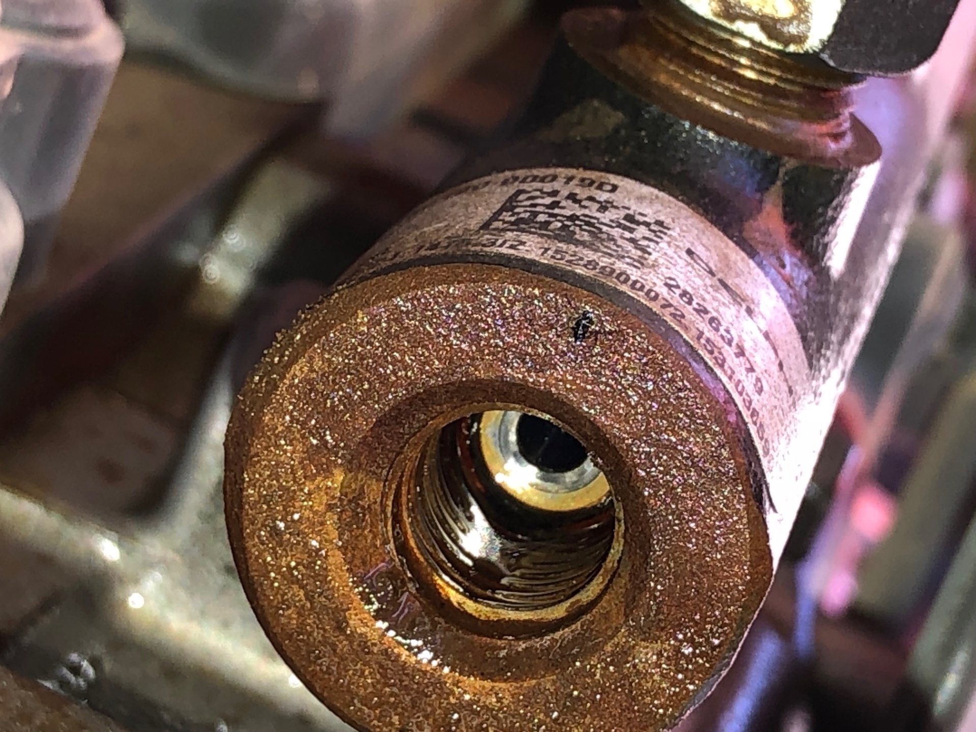

End of fuel rail sensor socket pict. I wish that pict was scaled but that hole is small.

The only thing I've observed through other's research is that Delphi has modified some of the components without changing the part number (see that first eBay listing). Having to do with the number of threads sticking out.
So, what you found might work. Might also need minor changes to make work. But heck, I'd try it. For 50 bucks?
