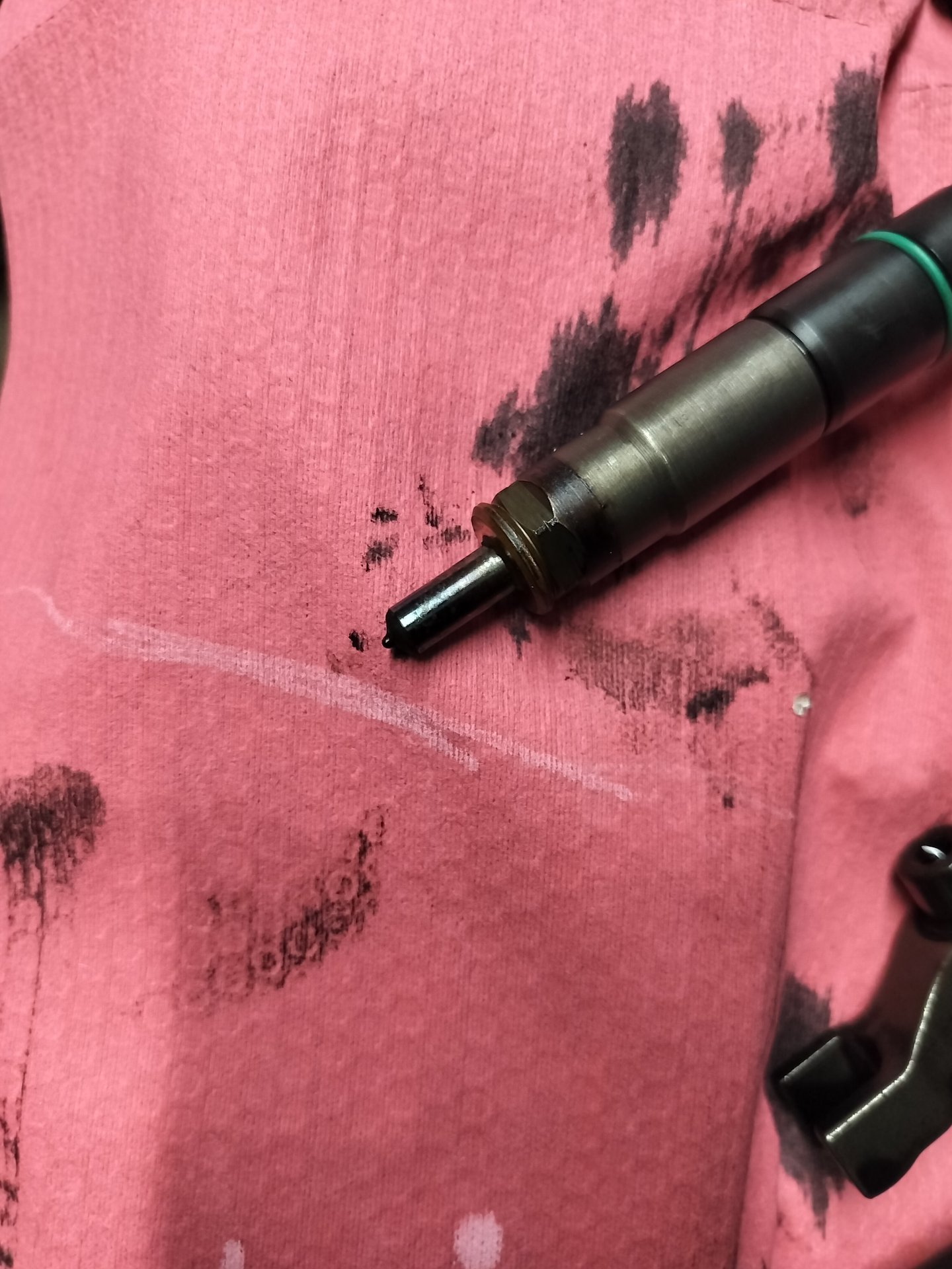

I pulled the injectors they look rough

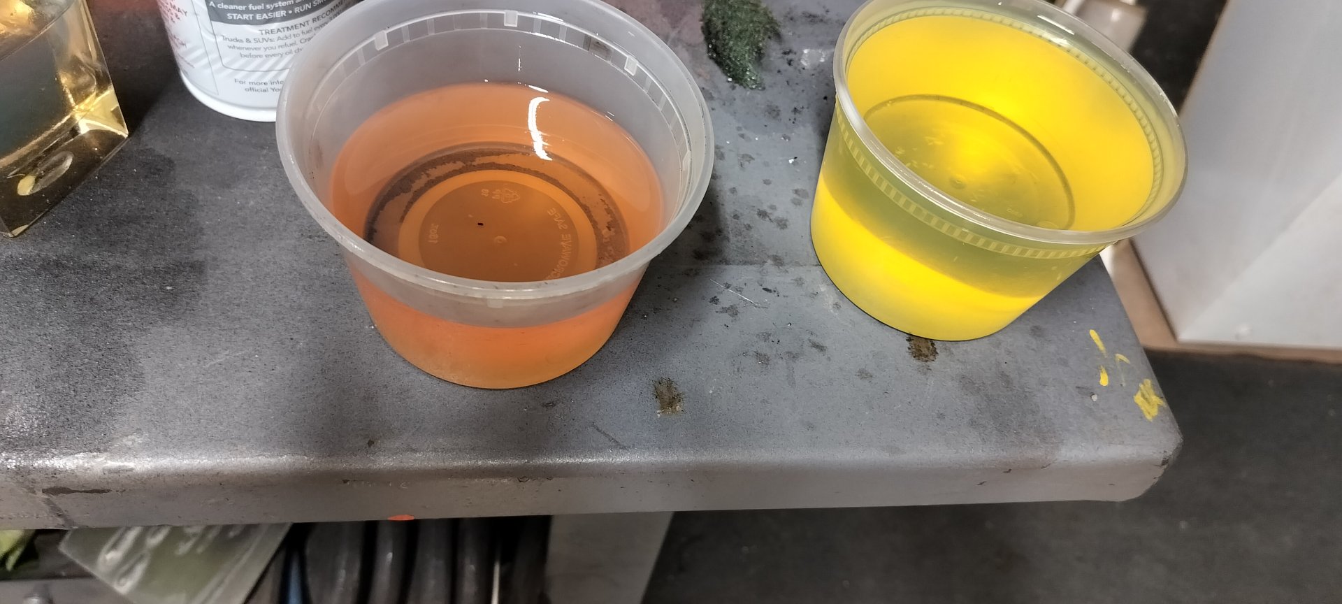

I started back at square one going over everything again I will admit I'm colorblind so when I examined the fuel I thought it had some off-road mixed in with it then my son stopped by and saw the 2 fuel samples on the bench and brought it to my attention that there was something very wrong with the fuel out of my machine

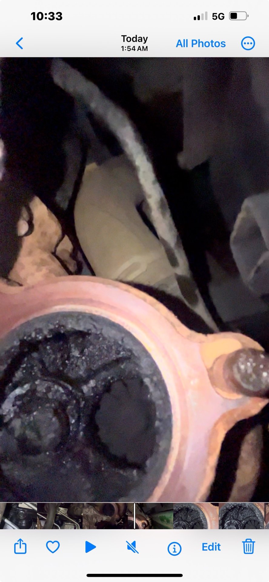

Update on the multi issue situation I bought four new fuel injectors installed them but I believe the bigger problem was the exhaust was totally clogged with black gooey tar stuff it took about 4 hours to clean out the exhaust and the injectors once installed

That “black gooey tar stuff” is what is commonly known as “wet stacking”. It is unburnt fuel in the exhaust that can be caused by too much fuel, i.e. bad injectors, and also too much idling where the temperatures aren’t hot enough to burn it off.
That "black gooey tar stuff" is what is commonly known as "wet stacking". It is unburnt fuel in the exhaust that can be caused by too much fuel, i.e. bad injectors, and also too much idling where the temperatures aren't hot enough to burn it off.
Good information right there I will definitely remember to keep that in mind. The issue with the muffler I didn't think was a sudden impact I was definitely thinking this was a build up of a long term issue that was literally undetectable until all the aspects came to a head. After I cleared the exhaust and cleaned the turbo I was getting a white smoke no more black at all
