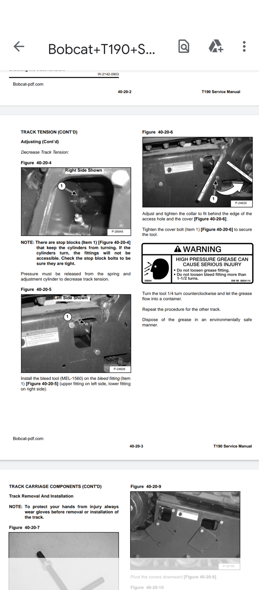

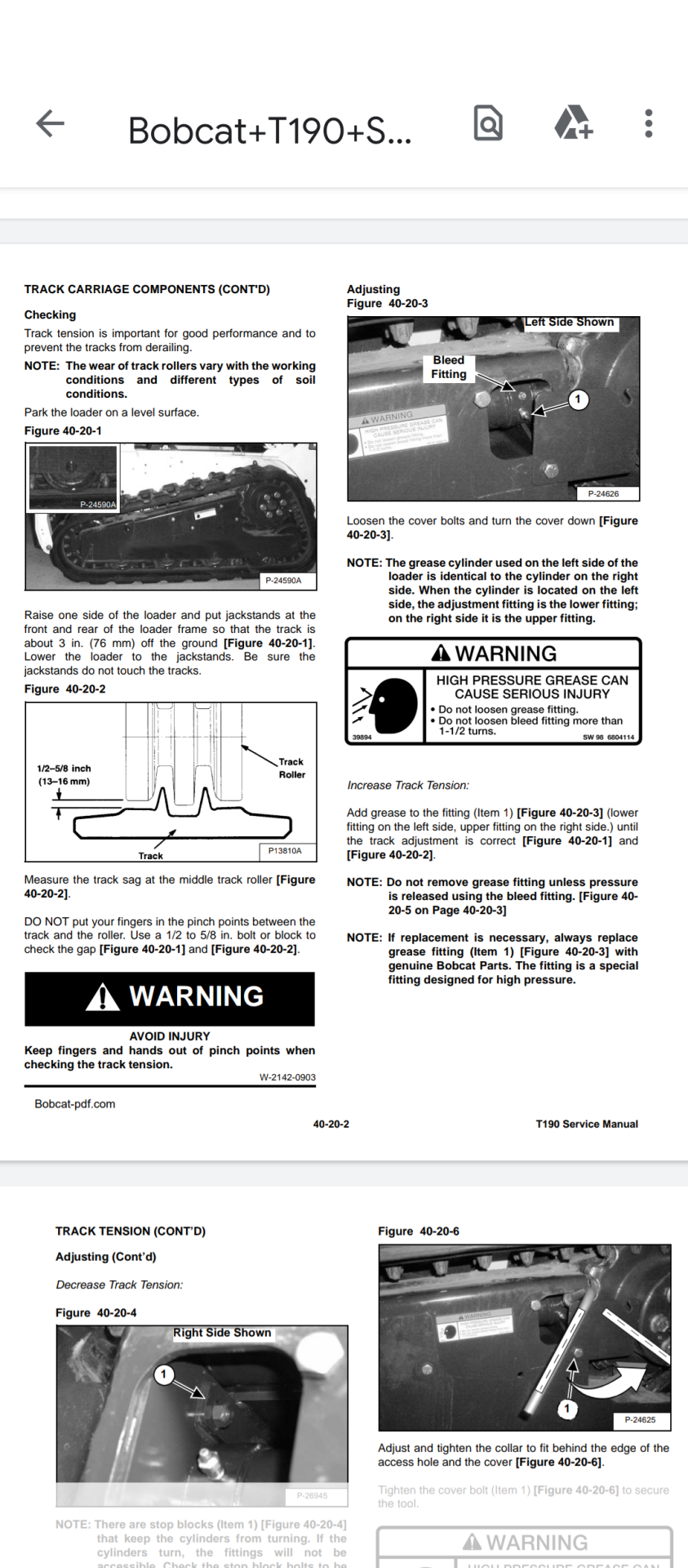

My question relates to the "bleed" and "fill" fittings on the grease tube.
I bled the grease tube down by releasing the "fill" fitting, and of course grease came out in abundance" as opposed to the "bleed" fitting which I'm not sure what the result would have been. I then refilled the grease tube thru the "fill" fitting.
Did this in any way damage the system?
And/or do I need to go back and re-bleed and re-fill according to the service manual
which I have now downloaded on my phone for future reference?

My opinion is that you are OK, after I read your manual pages. I do think that you were supposed to release the pressure with the bleed fitting though. I think this is a safety issue (the special bleed tool looks as though it is for safety and fits onto the bleed valve and acts as a wrench and a drain tube). The grease fitting could have failed under pressure and shot out at you like a bullet. However, it looks like the bleed fitting could do the same thing without the special tool (it has a lip on it that helps hold it in place). Also, hot grease shooting out under pressure could also be an issue.

I had a socket on it when I unscrewed it, and it did pop just a bit as the grease poured out and filled the cavity. What a mess.
Think I'll see about picking up one of the tools for the onboard toolbox to guarantee it'll never happen again. LOL.
