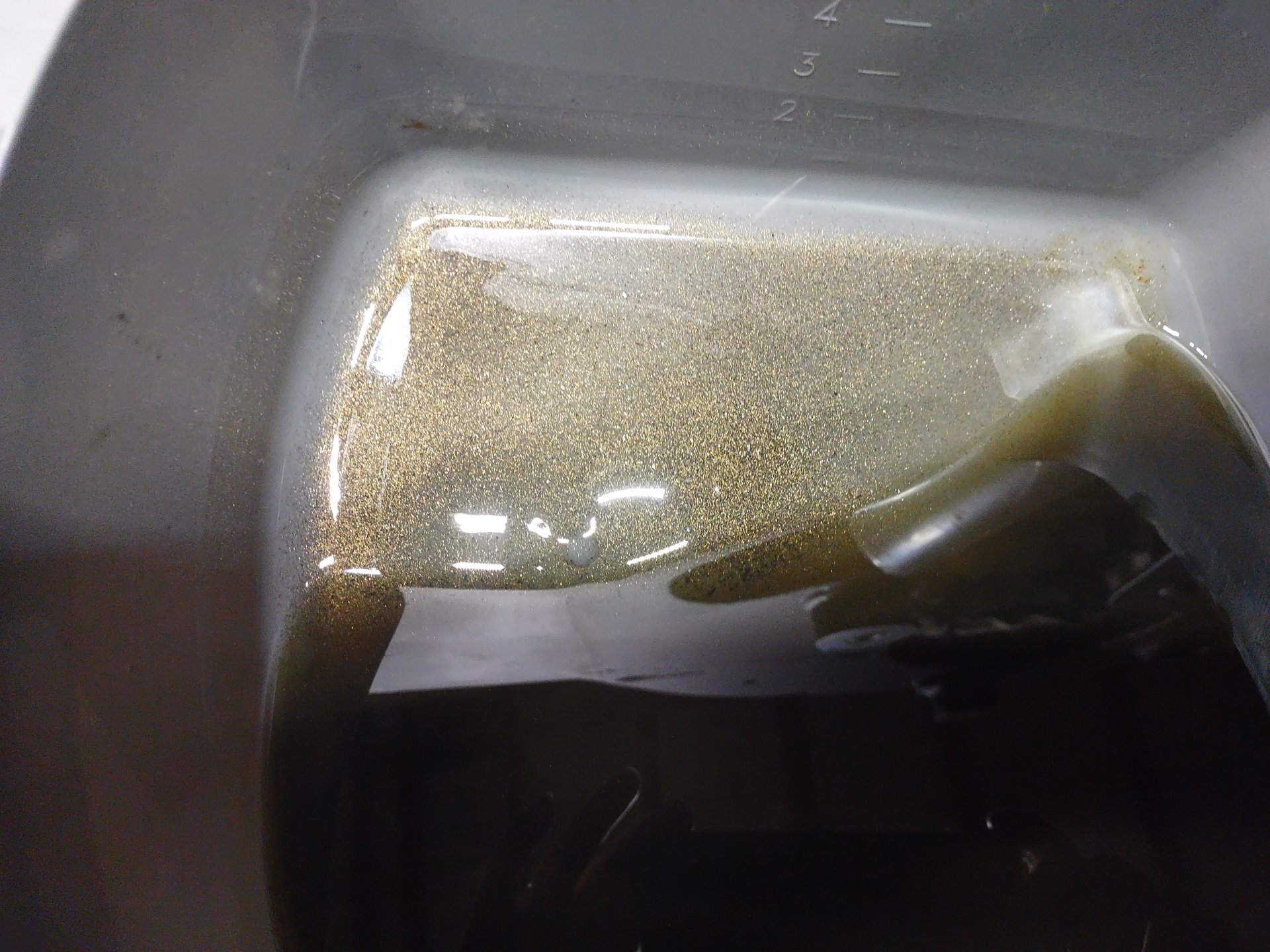

just recently bought a T190 that was rebuilt 3 years ago. While using it for just a few hours the restricted hydraulic filter warning light came on. I changed the filter. Then I began losing lift and tilt functions. The unit moves great. So I Removed the hydraulic filter and found metal shavings
So it looks like I am going to need a replacement gear pump. Where is the best place to get one? Bobcat is out of stock. Does someone a rebuild kit? Does anyone have one to sell?. Pn 6686703
