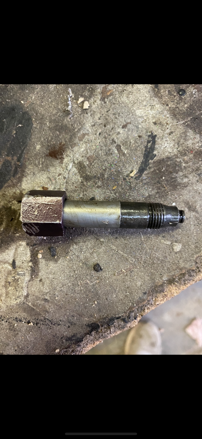

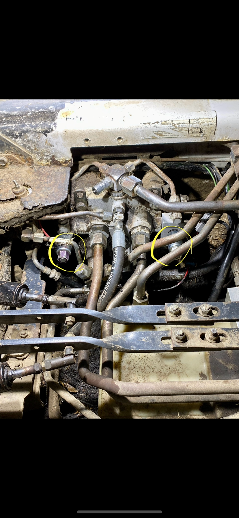

T180. Can anyone help me with a part number on this valve? My auxiliary hydraulics were working sporadically so I trailed down the coils and valves. I replaced the coils but the valve I got from the parts manual is not what I pulled out. Part I ordered was part number 6688743 valve control stem. I've attached a pic of the valve I need and where it came out of.
I've been to local dealer and I'm getting no support.
T180 Serial number: 527513754

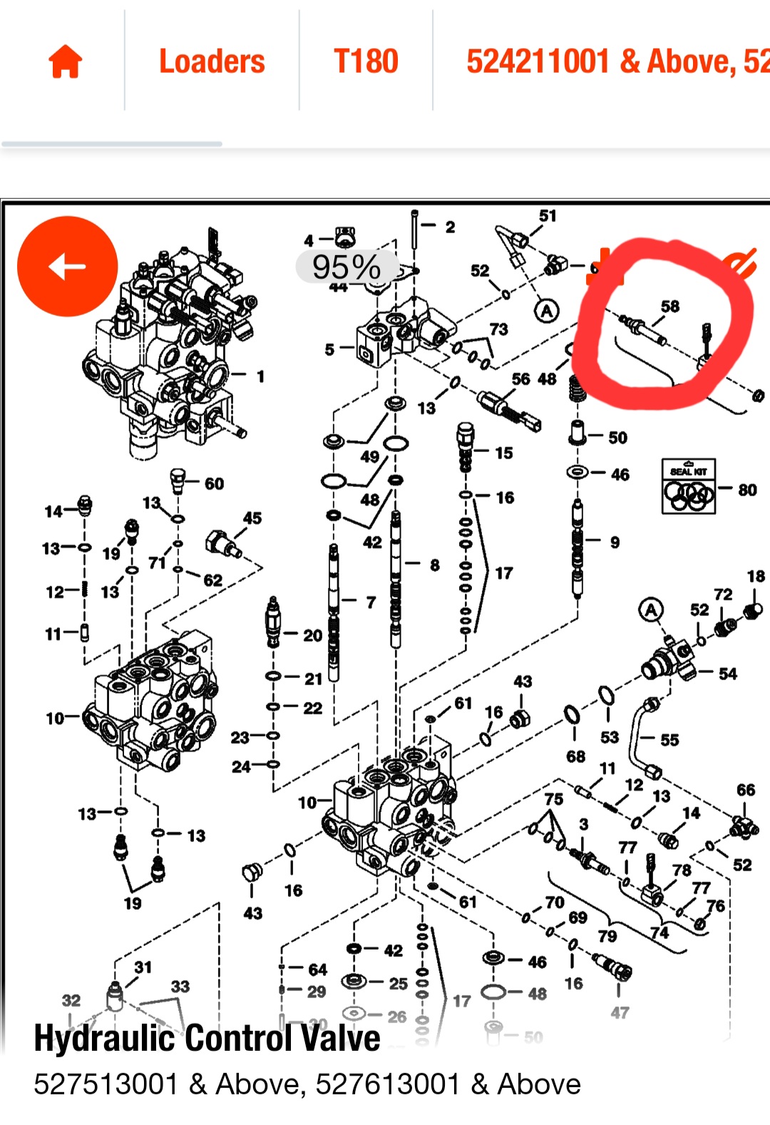

Did you try looking up on Bobcats website on the schematic ? Might give you the needed part number. Sometimes at a Bobcat shop you have a poor parts crew and other shops you drive way out of your way because they really know their parts and actually Help you. I used to drive an hour extra to go to a specific bobcat shop in So. Ca. Was Worth it everytime for me.
Todd
https://partscatalog.bobcat.com/
Put T180, click on it.. then click on serial number to narrow search. Click on hydraulic. Then click the schematic you want to look at. The part and part numbers will be listed below the schematic you click on.
I found the part # you have. See #58 in picture. Looks like a different set up.
