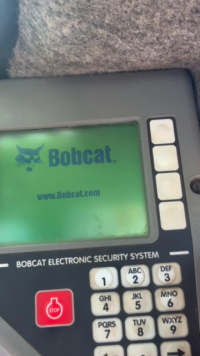

When run / enter button is pressed, the display will light up for me to enter the code, then the screen will flicker and it will shut down. It would rarely stay on long enough to start. Occasionally it did start but would stall again quickly. One time it started and I kept the revs high and it appeared not to stall but I haven’t been able to replicate that to test it.

I just realised I didn’t read the codes with both of the actuators unplugged, or with the joystick unplugged. Went up the hill to do it and now it’s doing the won’t turn on again. (See video) I’m now wondering how much putting the cab up and down has to do with there issue. I’ve looked for any damage to the wiring harness where it travels from the chassis into the cab and cant see any loom damage.
