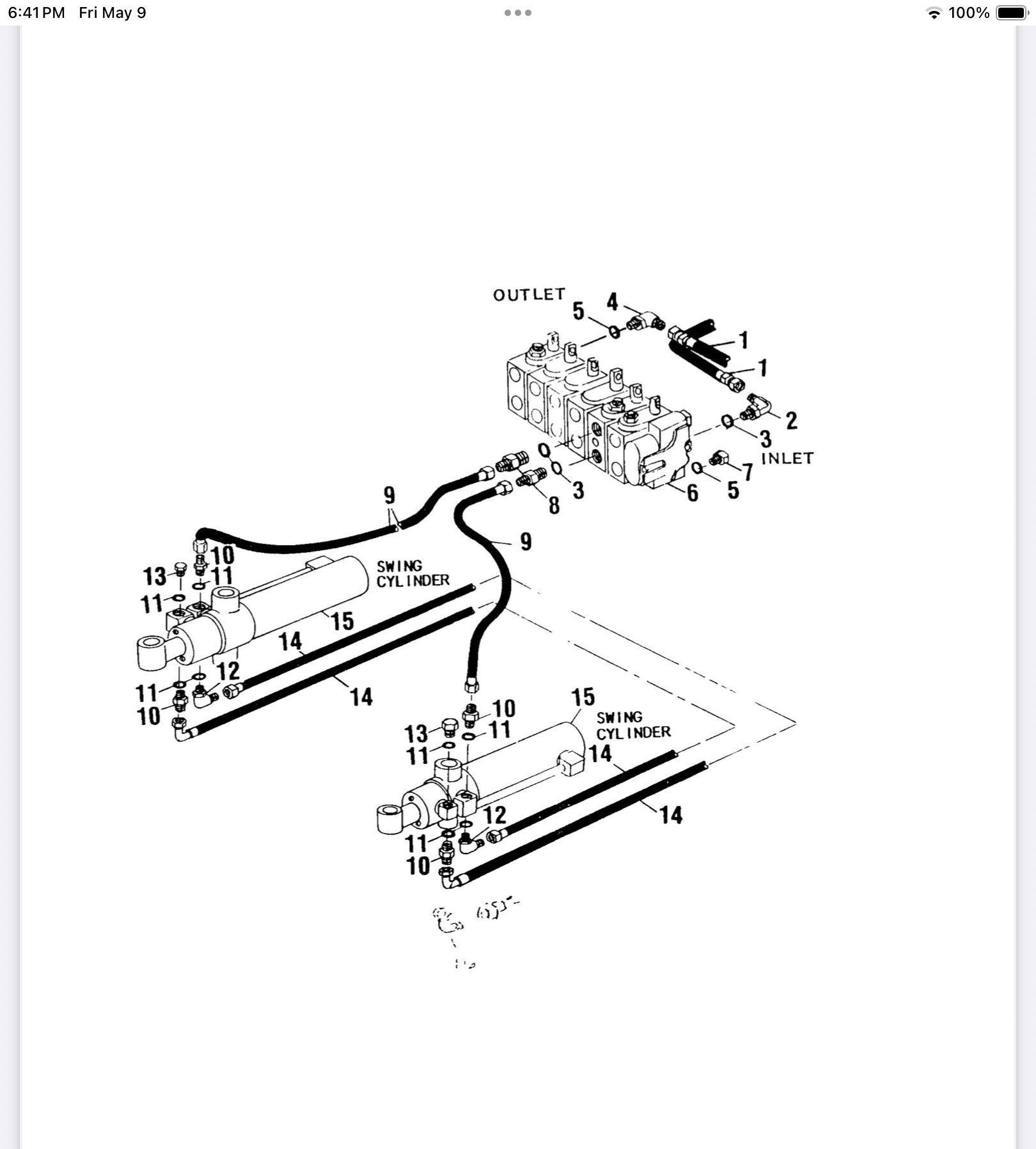

So as long as I'm on here, I just had my two swing cylinders professionally rebuilt. When I re-installed them they work In reverse. I.E. swing left when I activate the swing right valve and visa versa, and I think they have air in them because when they each reach around 70 degrees of travel from 90 degrees (center position) they drop the rest of their travel to zero degrees, and have no power to swing back. This will occur whether I swing left or right. Since the four lines are balanced to each cylinder (left swing- right swing) I'm having trouble bleeding them. Is there some particular procedure I need to follow to bleed the swing cylinders.
It's lines 14 in the diagram
