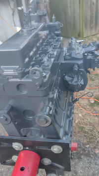

Not a Skid Steer but I purchased a backhoe Kubota L45 with a V2203 locked engine. Found the cam journals shot and the cylinder #1 shot as well along with the crankshaft. Purchased a reefer engine V2203 and just completed the changeover. Here is what I had to do. Went from Indirect injection to Direct Injection. I rebuilt the reefer engine with new pistons, bearings, wear rings, and lapped valves. I had to use my timing cover so governor controls could be used but my gear cover was built for balance shafts and had open areas.

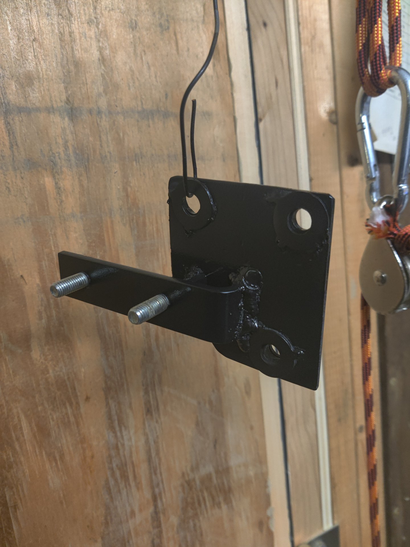

I made a dam from clay and prepped the cover for a JB weld pour and once set, filed to fit the engine and was good to go. I had to use the reefer intake manifold but the holes for the air cleaner mount were offset and I had to make an adapter plate. Also my hydraulic pump was a 3 hole and reefer block was 4 hole, I brazed a piece of steel bar to the block and using the pump as my guide drilled the third hole and tapped it, and put plugs into the two unused holes. I had to drill hole in the block for dipstick and used the old dipstick holder and JB welded to the reefer block.
