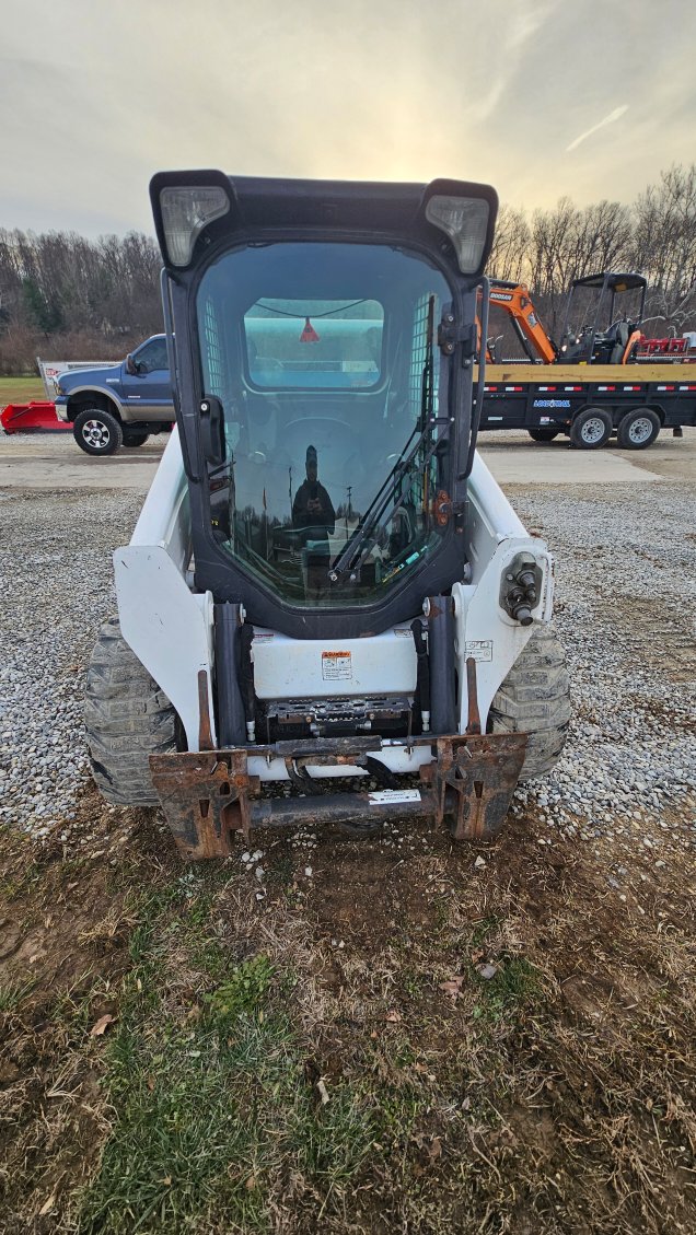

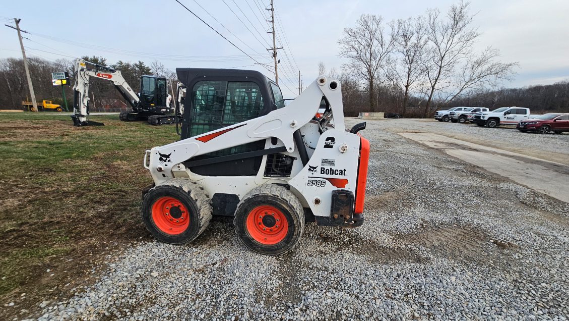

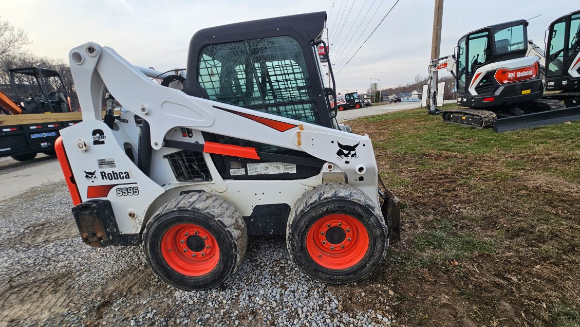

I went to the Bobcat dealership on Monday to look at a 2018 BOBCAT S595. I told the salesman I wanted to operated it around the lot before I went further. It was probably about 40-45 degrees F outside and the Bobcat hadn't been started yet. Instead of letting me get into it to start it, the salesman jumped in to start it. Once started, he said you have to let it warm up for about a minute before it will let you operate it. On my 1998 753 I had, once I started it, I was rolling out of the garage (but it was heated). Do the newer Bobcats make you wait a bit before you can operate them when they are cold?

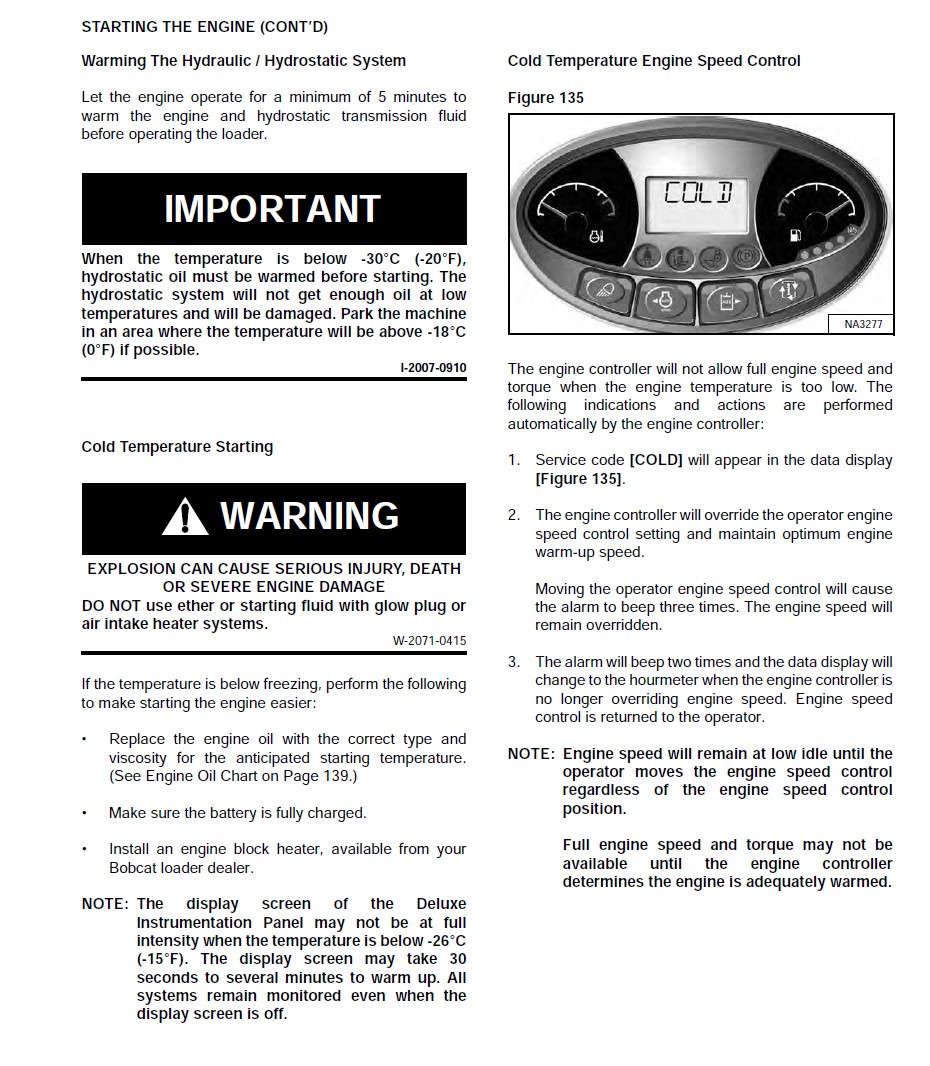

The newer machines will not allow you to move it until the computer turns off the word "cold" on the consul. It's always good to let things warm up, it's cheap insurance.
So I bought the skidsteer, as Reaperman stated, If it's cold outside the new Bobcats won't let you operate them at more than 10% until the engine temp warms up.
