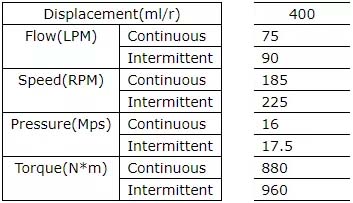

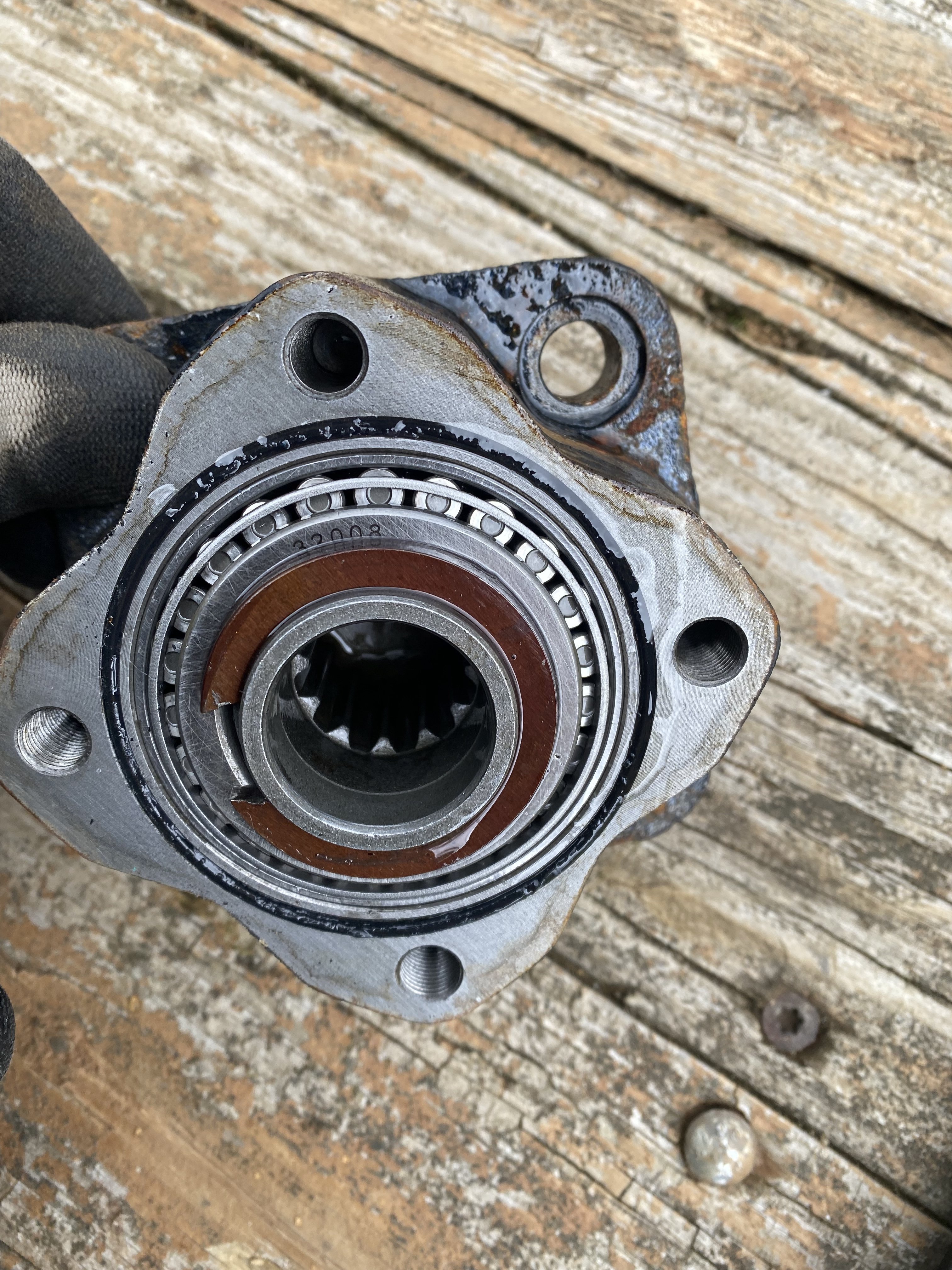

I have a JCT tiller and the motor is bad, I am not having any luck finding a replacement motor. Jct will not reply to my email, that is the only to contact them. Anybody know of a good place to find a motor that will work. From what I can find this motor is a hmsj-400 specs below.

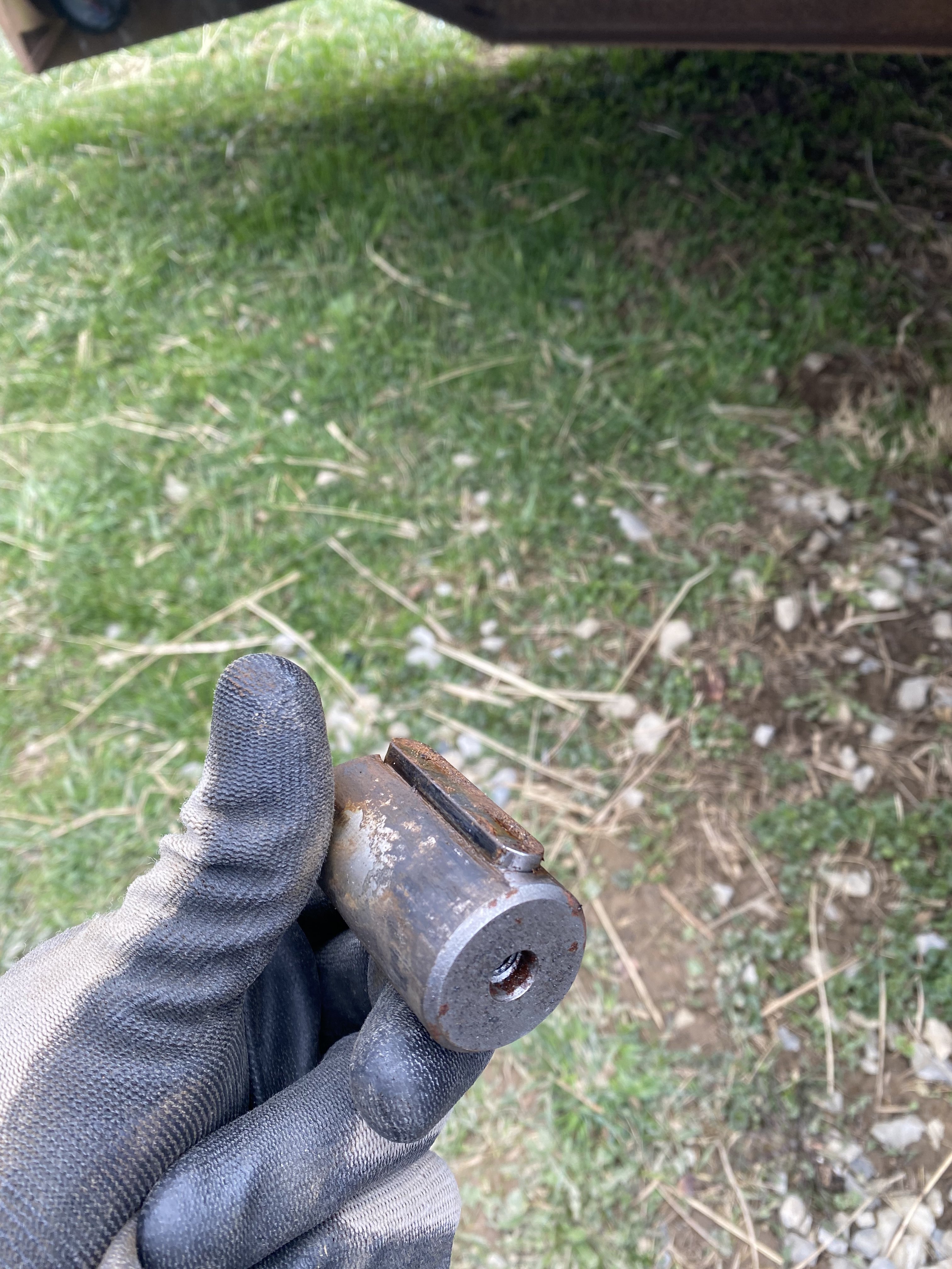

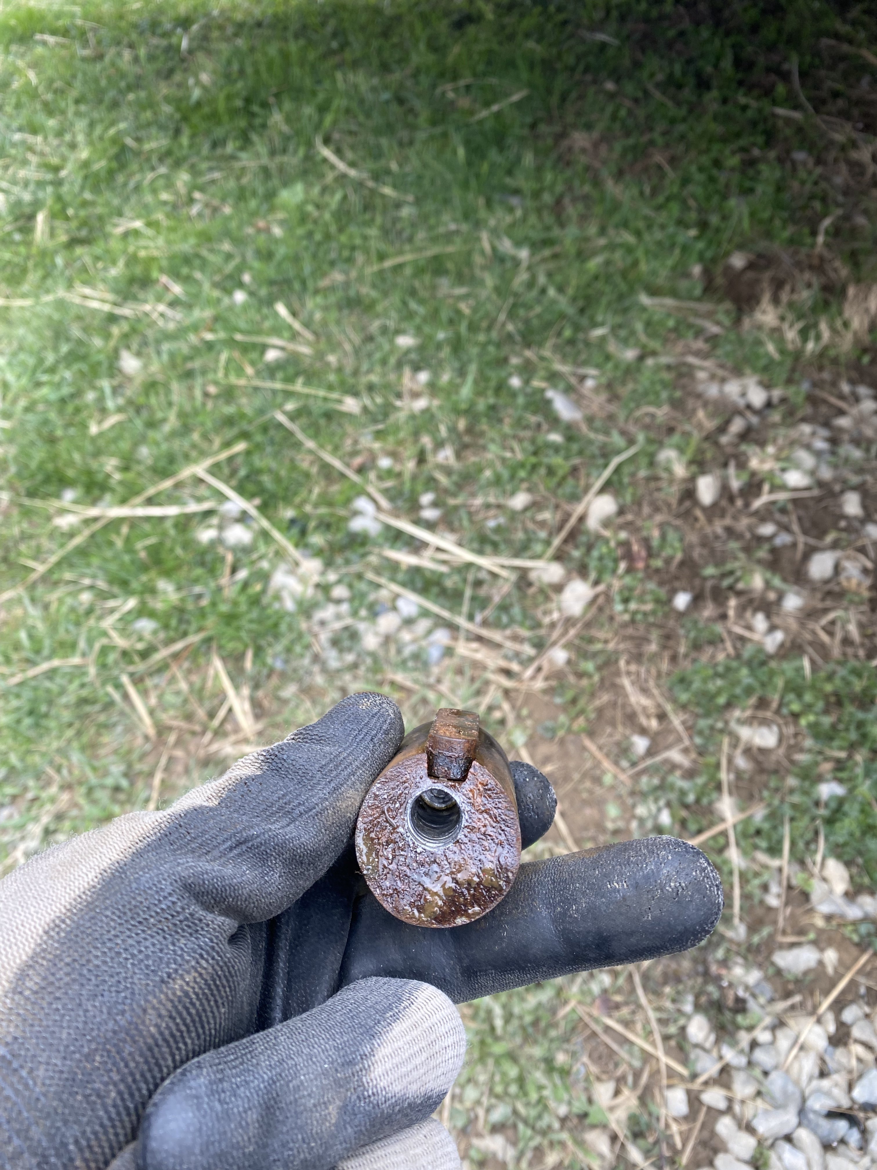

Yes I still have it. Not for sure what they call it but the shaft inside the motor was broken. This is a new tiller never used, my guess the motor broke when they tested it at the factory. Its doubtful I will hear from JCT or that they will warrantee the motor but I would like to hold onto it for a bit longer just incase they do.

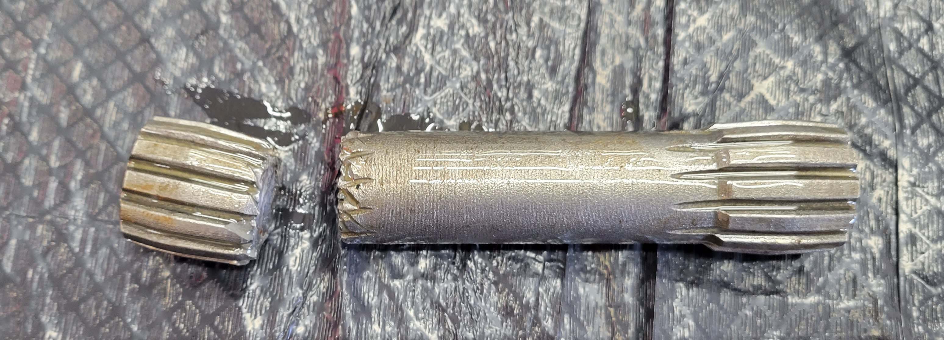

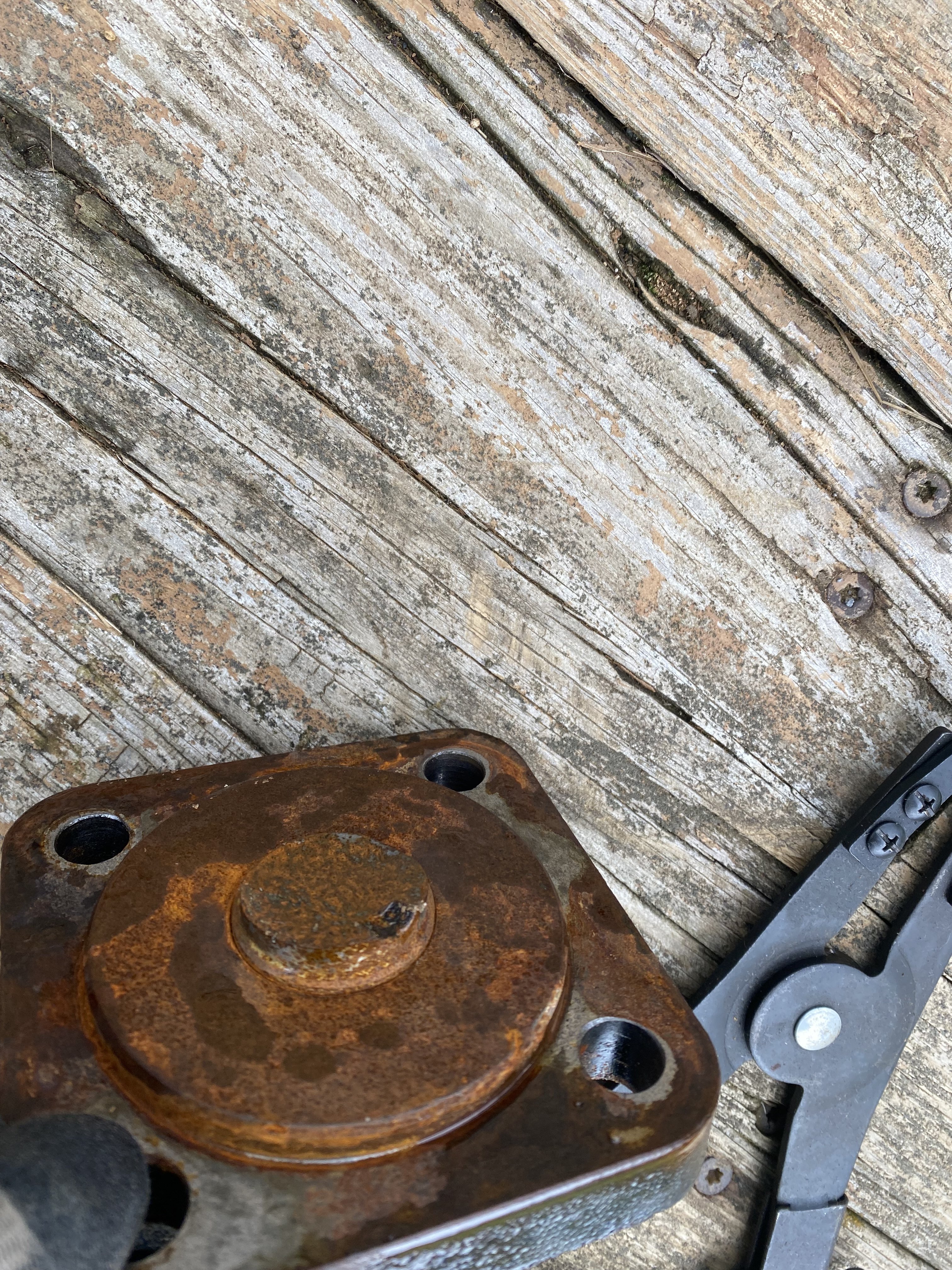

I bought a brand new tiller at an auction and the output shaft is broken. Looks like it fell off the delivery truck or something. It also broke the pillow block at the other end. Not sure if we would be able to put our to Orbital Motors together and make a good one or not. I am unable to get ahold of JCT as well.

(Note to self- avoid "JCT" equipment) I claim no expertise, but the material used for those shafts appears to be maybe slightly better than pot metal.
Yea that shaft was made of crap metal and not even remotely properly hardened. Hard to see in the picture but it is twisted some. I am in agreement about avoiding their equipment. Says a lot about a company who wont talk to you when there are issues. Already got me thinking I might want to go ahead and just replace the bearing on the other side, as that is probably a crap bearing.

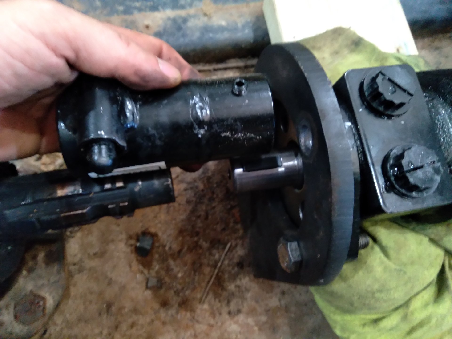

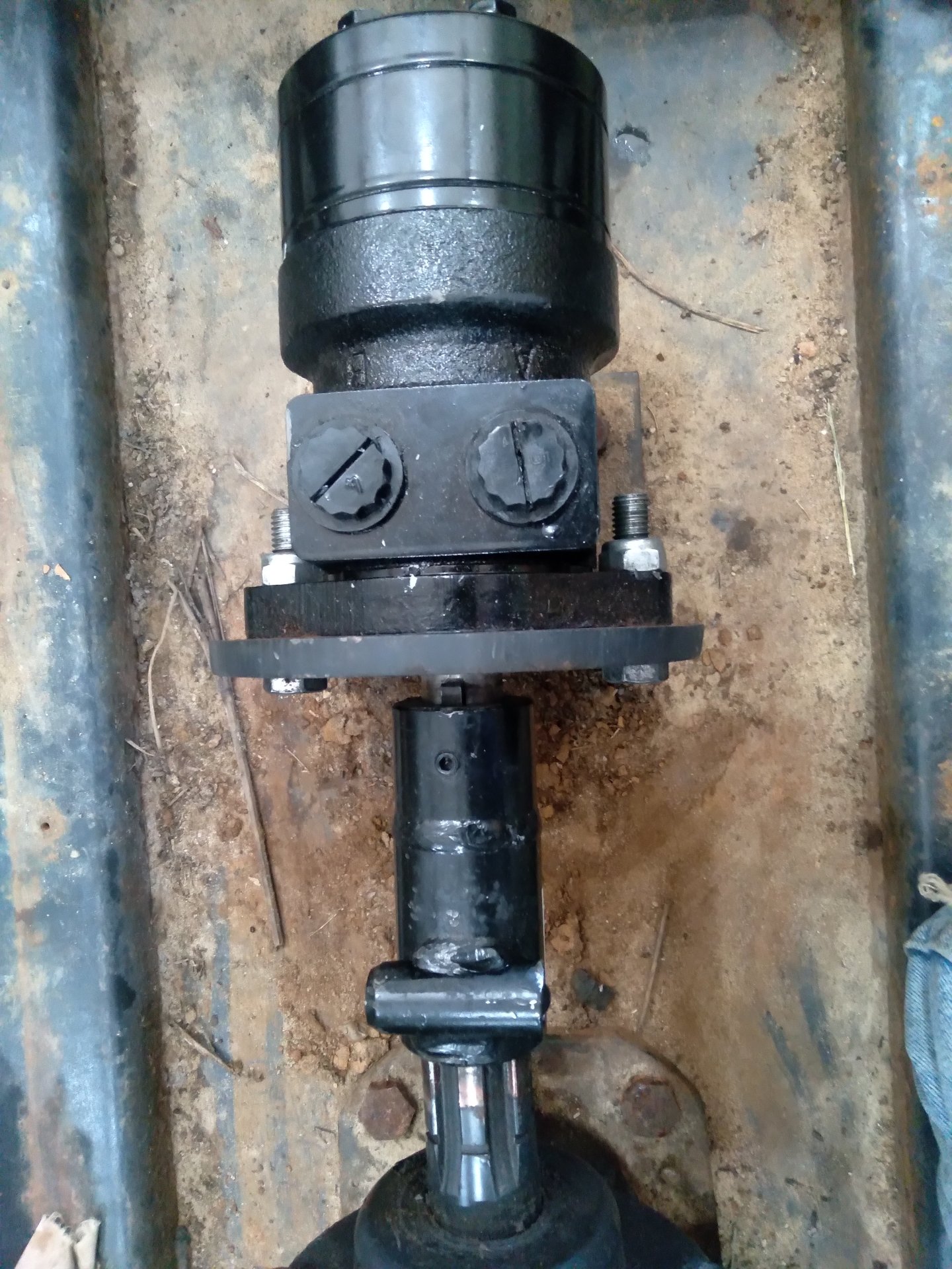

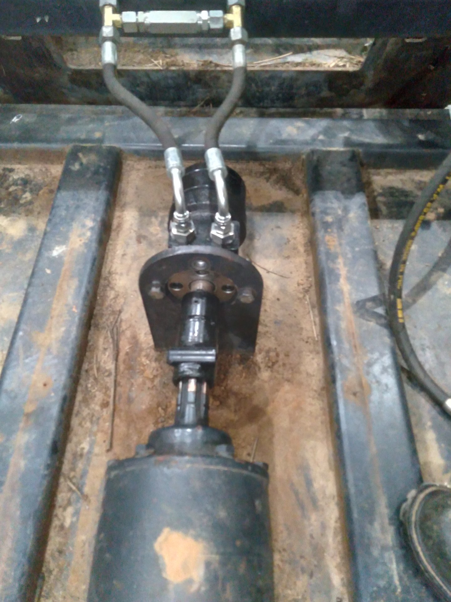

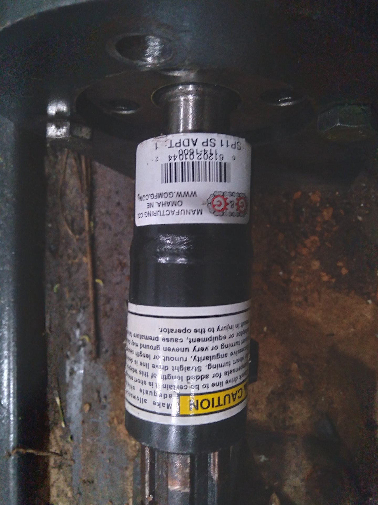

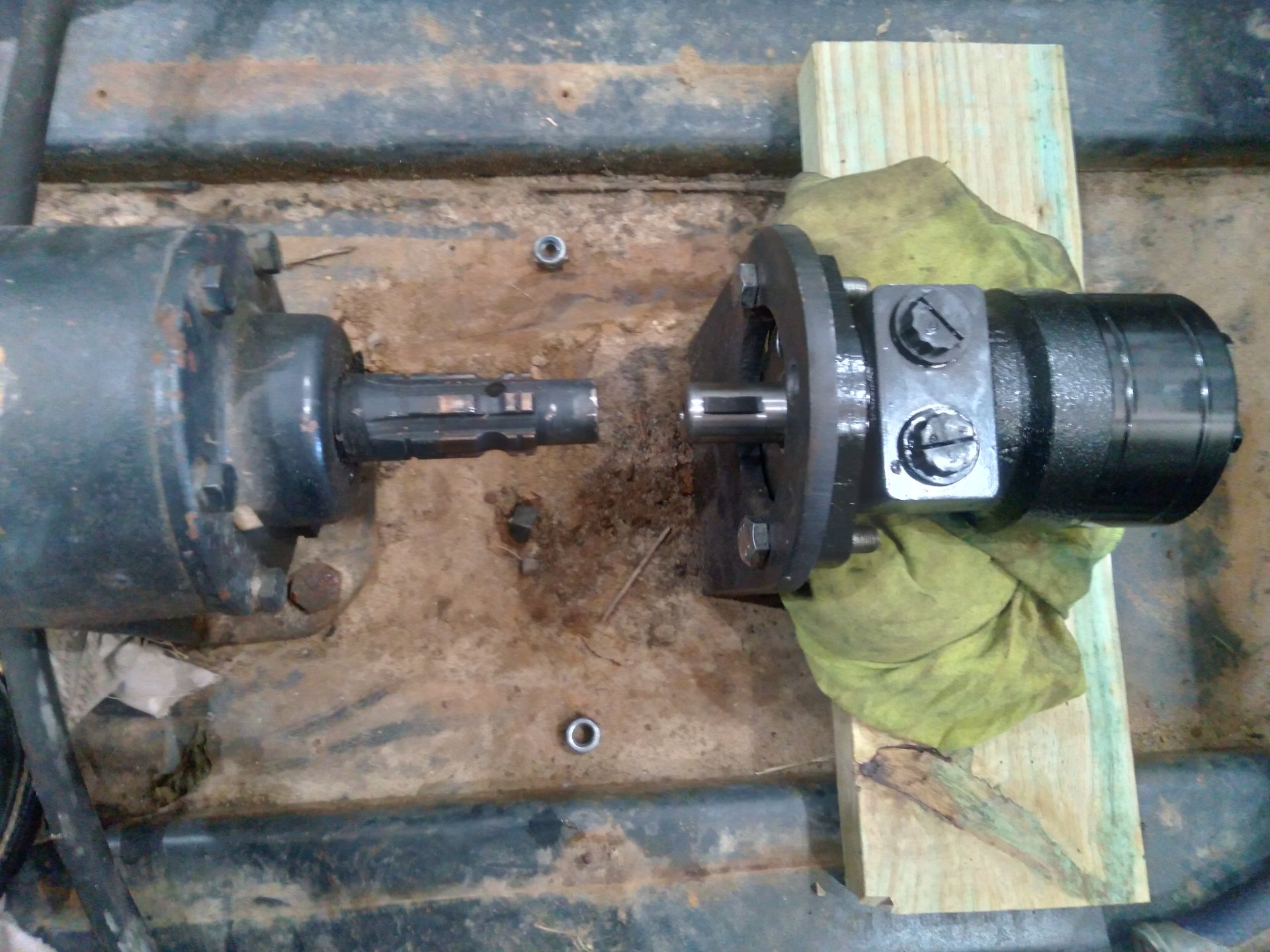

I was able to find a replacement motor for my JCT brush hog that fit into the original bracket (with 2 bolts instead of the original 4). I should have gotten it with a longer shaft, but the coupler just barely bridges the distance. I use the coupler instead of the lovejoy set up they originally had. I don't know if that will be a problem in the long run or not, but so far it is working. Right now I am just cutting grass and high weeds.
The coupler did slide off on me, so I put a bolt (not pictured) through the hole which only puts the coupler on the edge of the PTO type shaft on the gear box, but it puts the other end against the new motor wall so it does not slide anymore.
I needed new hoses as the JCT hoses did not match anything in the US or Europe (guess where it came from).

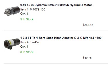

I bought both the motor and the coupler from www.surpluscenter.com for about $400 with shipping and tax, plus the new hoses from a local hose place. The parts I bought are item numbers 9-7078-160 and 1-2459. Surpluscenter sales support were very helpful. Ask them if the motor comes with a longer shaft version.
