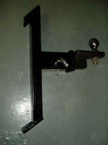

My trailer hitch, about $300 in materials(steel has sure gone up). 2" x 1/4" square tube construction, ready-made receiver tube and a universal plate from BC.
31108115.jpg Trailer Hitch 6 picture by tooleeo

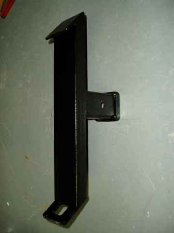

I've seen less expensive plates with a short receiver tube in the middle, but I thought it would be hard to see over the top to hook up to the trailer. Also, mine lays flat when you disconnect, the shorty seems it would be prone to tip over and put your adapter in the dirt.
Looks good to me! Just be careful pushing up hills, i have heard of people being killed when the hitch jumped off the ball and squashed the operator in the cab. If you lock it down i see no problem, just be careful.

Man!, that sure doesn't look like $300 worth of steel?. I'm sure glad I have a metal scrap yard nearby..
I know, huh?
20 ft square tube cut to 10 ft and 1 ft 2"x 1/4" strap=hunnerd bucks(did I get took?)
12" ready-made receiver tube 35 bucks
BC weld-on plate 180 bucks-(did they kiss me, too?)
And as all who do such-satisfaction.......priceless......hehe.
I don't like rusty scrap especially when I depend on good welds and painting----too much prep work.

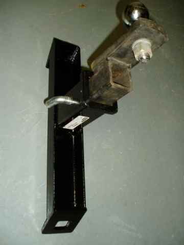

I have 3 sets of pallet forks and I welded a receiver tube to the middle rib on the fork carrier. I did have to put a hole in the rib to put the pin thru the tube. Now I can use the receiver hitch to move farm wagons, bumper pull trailers and gooseneck trailers. I have my skidsteers set up with rear counterweights so going up a slight grade with a light attachment can be a little tricky.

Shane, nice build. My brother has made a few like that. They are way stronger that the ball mount. He has bent the 3/4 plate the ball mounts to trying to pick up frozen down trailers.
I guess my minimalist design is somewhere between the solutions above. Just hang it on either side of the Bobtach and latch the pin. 1 piece of channel, 2 pieces of flat stock and an $10 receiver tube from the local discount tool place.
I wanted a compact solution that I could keep with the loader. I started to make up a mount so I could hang it on the loader when not in use. Since I only have two trailers I just made one of these for each trailer and leave them on the trailers. I thought I might need to add gusset plates to stiffen the channel. My largest trailer is a 12000 lb capacity tandem axle. So far no problems moving it around with a load on it.
