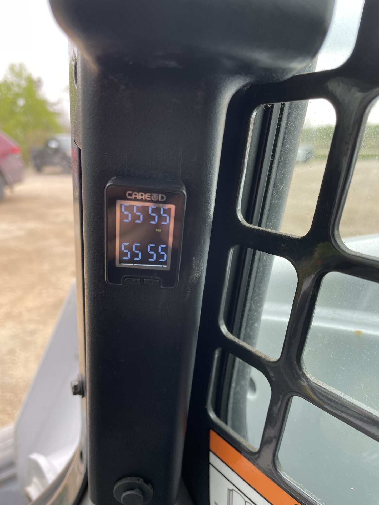

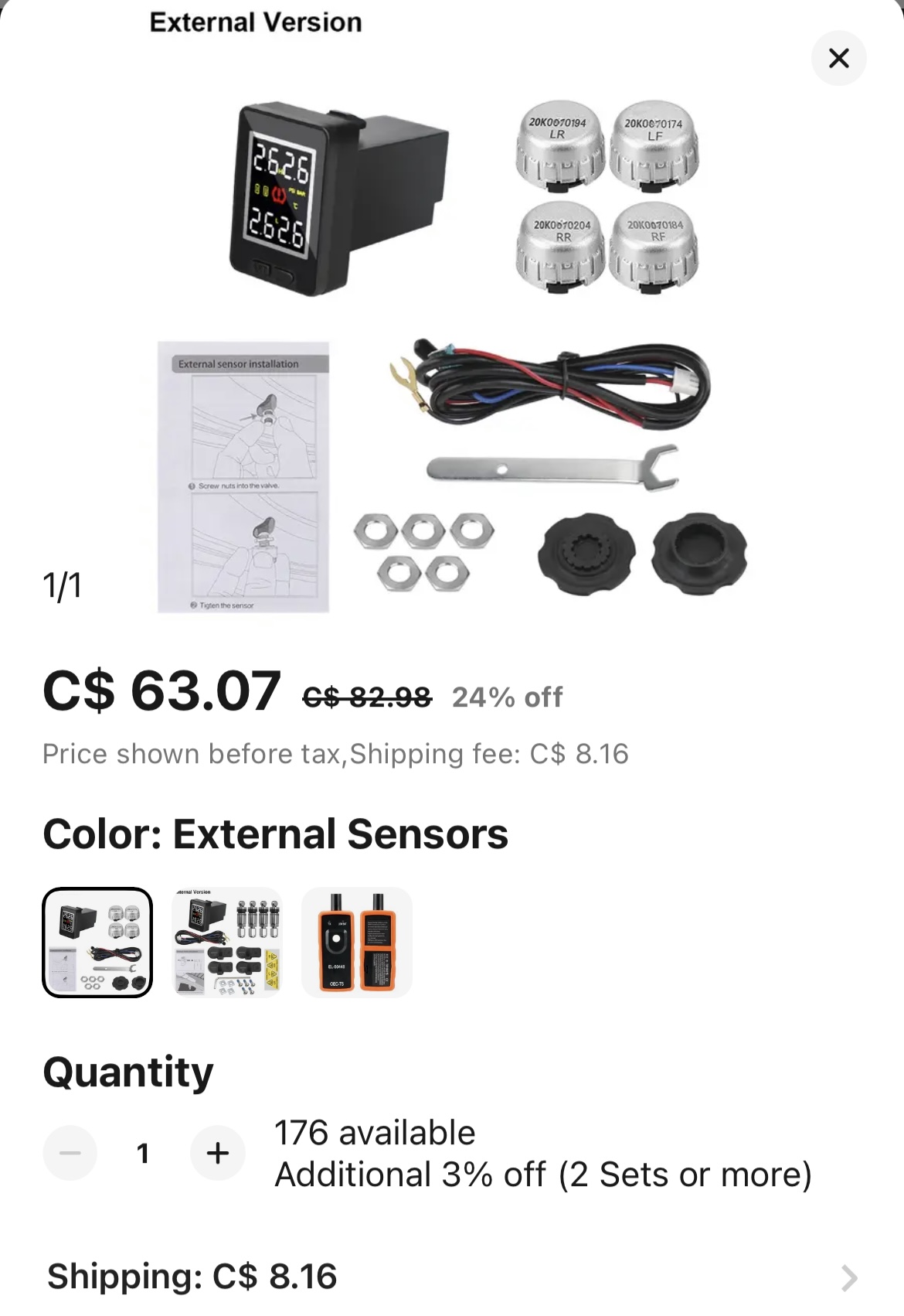

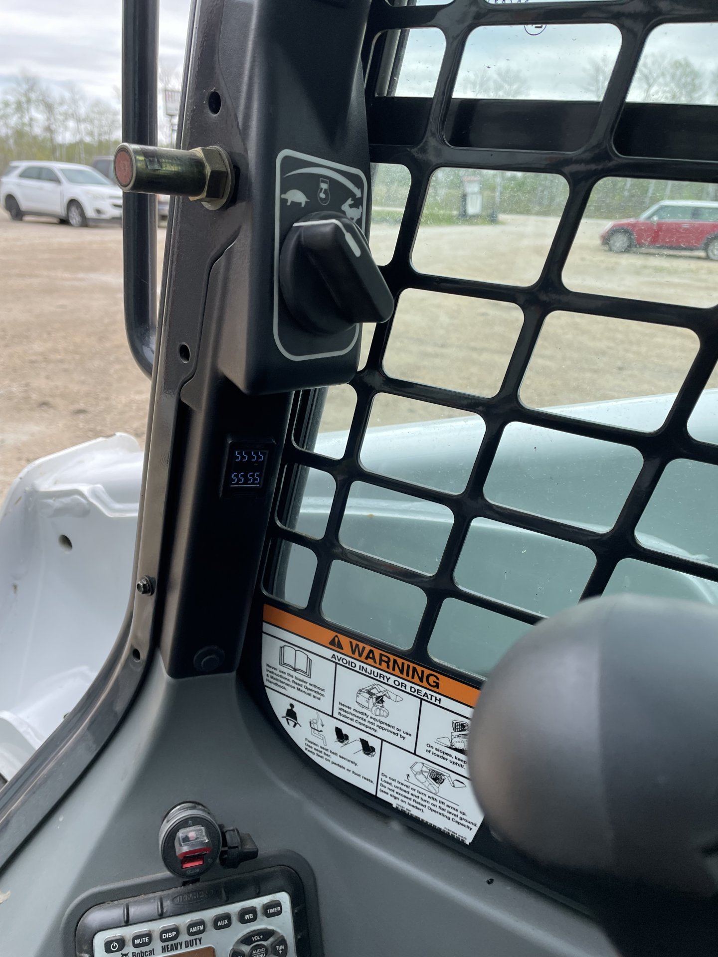

Decided to add Tire pressure monitoring to the skid steer and found a simple sytstem that actually works. Adjustable high and low pressure limits with alarm that can be silenced. The only down side is the sensors are the valve stem caps and subject to damage if you’re in deep mud/brush Which is fine for me. For $72CDN with shipping, 20 minutes to install it was worth it. Picked up from Aliexpress. Figured I share something that works in case any others looking for something to monitor their tire pressures. When I get focused working it’s usually “too late” before I notice a tires gone down.
