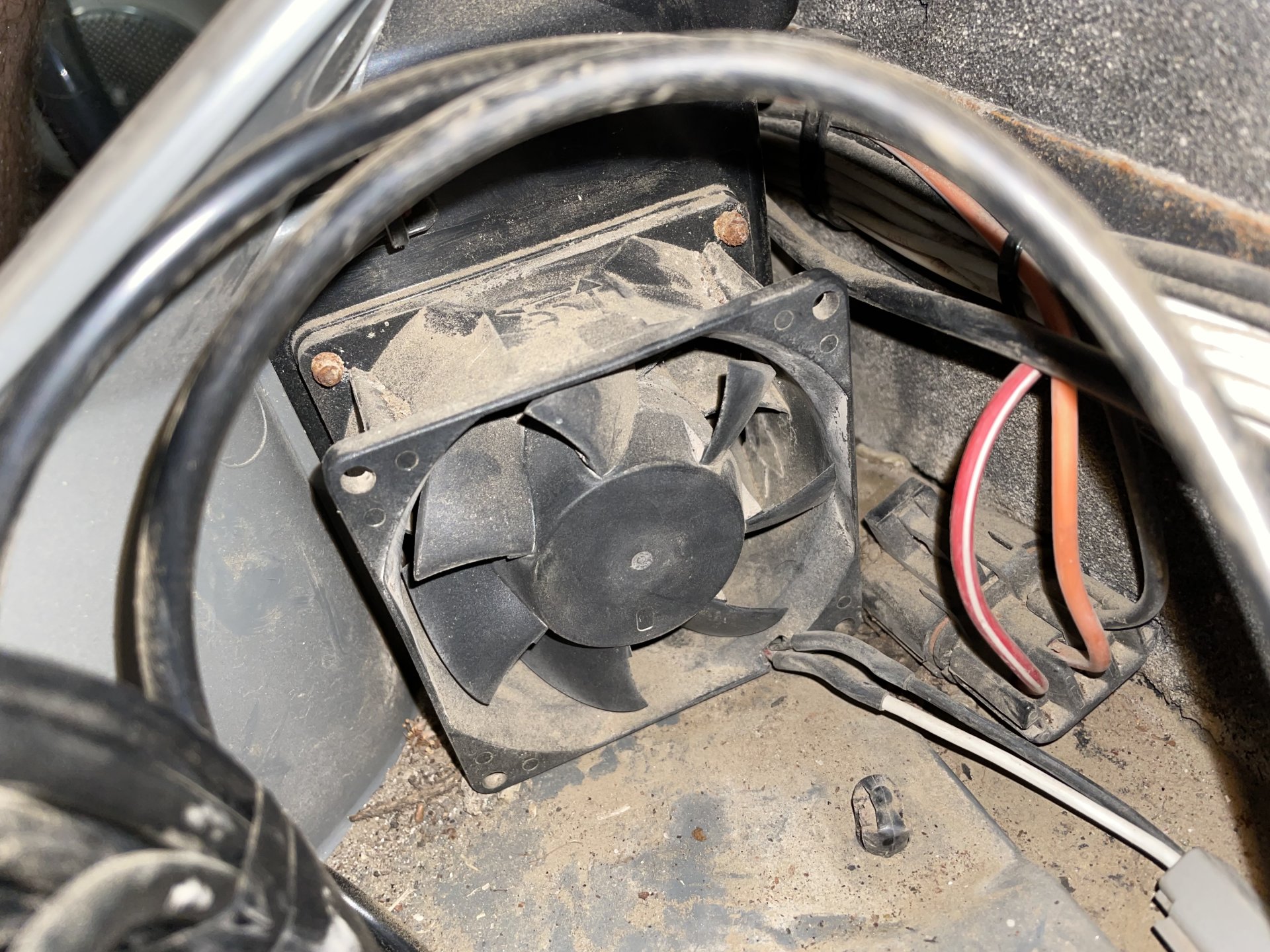

Does anyone know what this fan is for? It’s under the right side plastic cowling. It doesn’t run and was unplugged. Any ideas?

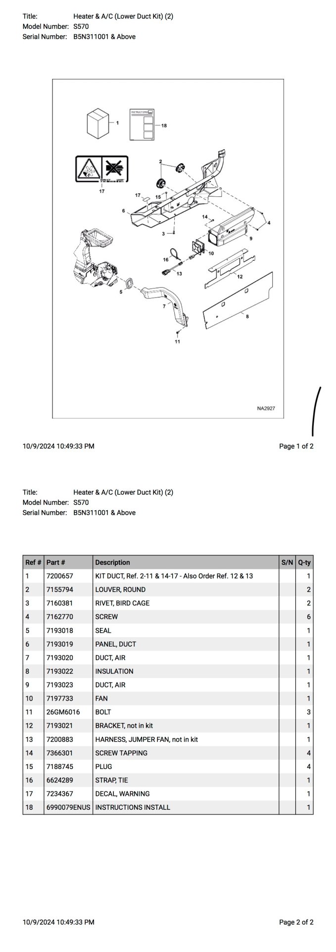

In the parts catalog it is part of the HVAC system. See picture below, but may not be the same for your specific machine.
Here is a link to the parts catalog so that you can look for your serial numbered machine:
https://partscatalog.bobcat.com/
