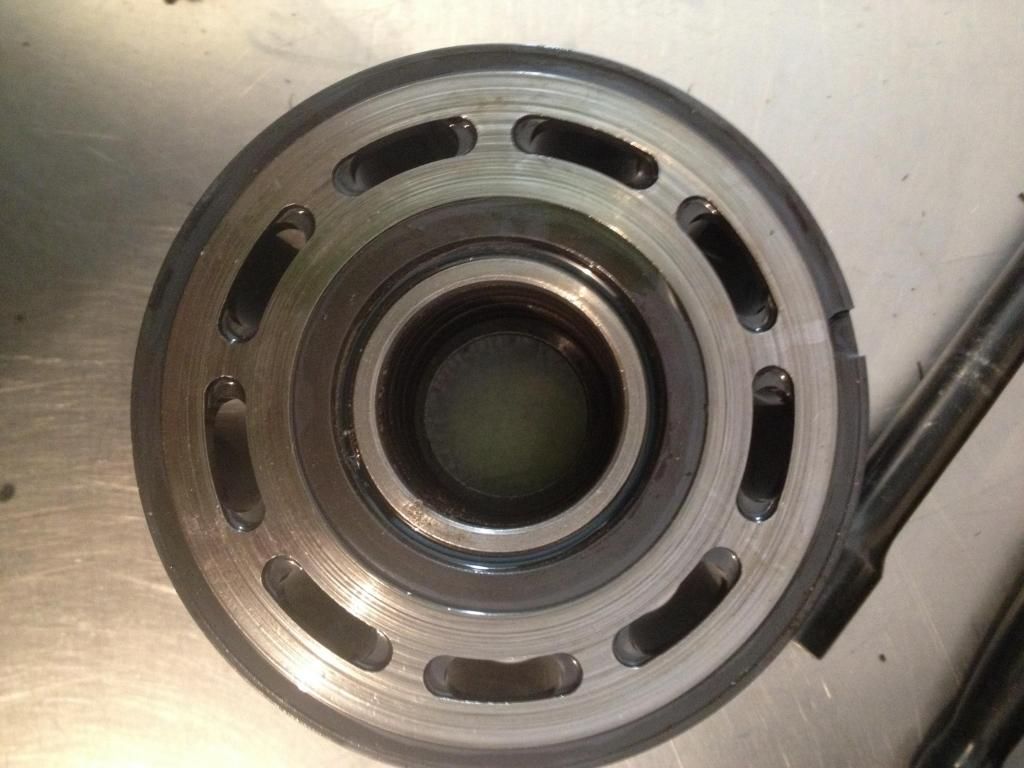

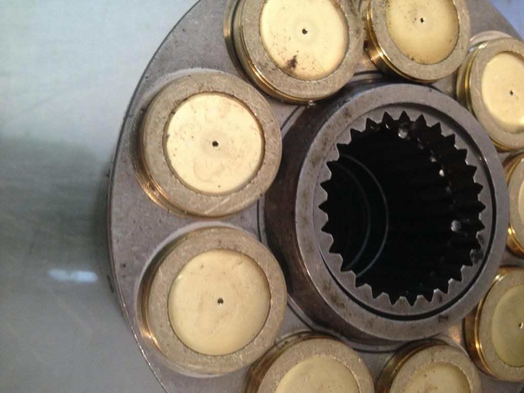

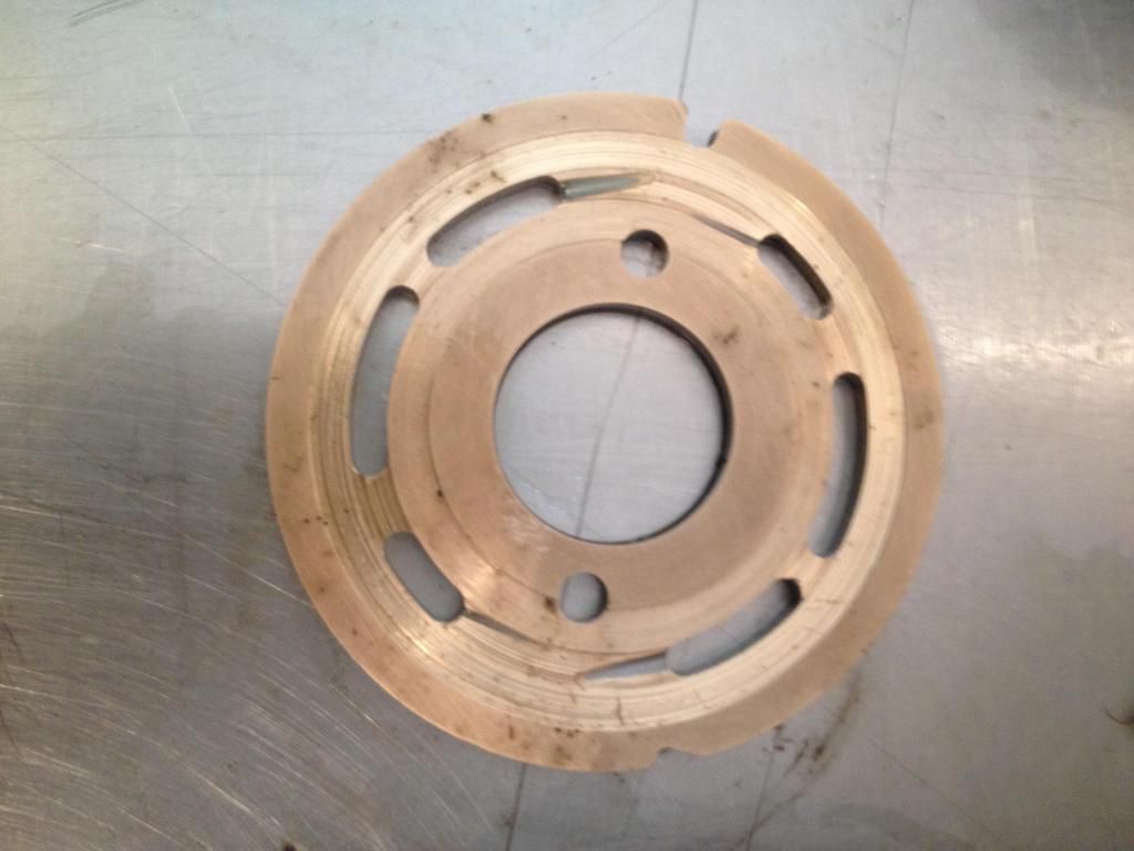

<blockquote data-quote="Salbendidi" data-source="post: 83417" data-attributes="member: 9115"><p>I agree. Would you install additional filters? If so where would you reccomend? I pulled the cooler this am. Gonna try flushing it. Dad owns a transmission shop and has a home made bomb for flushing coolers. Should work. If not a new one it will be. As far as the wheel motors I feel they can be cleaned and polished from what I understand. It's spring loaded. So polishing your flat surfaces on glass with 600 should be fine. As far as this Pistons and bores go they look good. Maybe some new rings. If they are clean and this is unsuccessful you will on,y loose time. All other lines are being back flushed. Am I on the right track? Any concerns with the control valve?</p></blockquote><p></p>
[QUOTE="Salbendidi, post: 83417, member: 9115"] I agree. Would you install additional filters? If so where would you reccomend? I pulled the cooler this am. Gonna try flushing it. Dad owns a transmission shop and has a home made bomb for flushing coolers. Should work. If not a new one it will be. As far as the wheel motors I feel they can be cleaned and polished from what I understand. It's spring loaded. So polishing your flat surfaces on glass with 600 should be fine. As far as this Pistons and bores go they look good. Maybe some new rings. If they are clean and this is unsuccessful you will on,y loose time. All other lines are being back flushed. Am I on the right track? Any concerns with the control valve? [/QUOTE]
