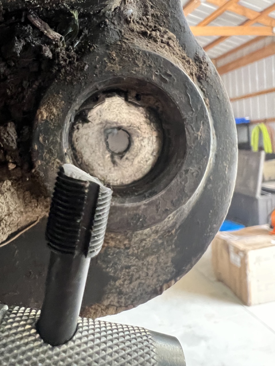

Hey everyone,
Recently did pins and bushings on my S185. I accidentally damaged the threads on the little plate where the grease zerk goes on the backside of the tapered pin on the lower Bobtach attachment. I went to touch those threads up and broke my tap off... cheap metal. Lesson learned.
Anyway, I can't get this dang broken bit out. Super hard and apparently very brittle, struggling to weld to it or get a drill bit in for easy out.Was just going to order new... problem is, I can't find this part anywhere. Anyone know what'd I should be searching for or can recommend here?
This is the small plate/disc held in by the snap ring on the inside of the tapered pin. (Pic attached)
Thanks in advance!
    284.8 KB
Making progress.... just a steel plug. Found one that says not compatible with my model. Wish it had measurements.
Bobcat part for the incompatible is 7170613.
