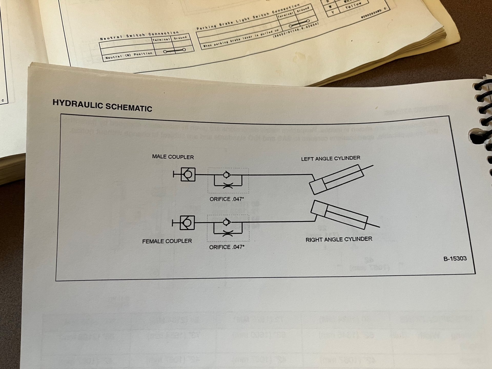

I was able to find the hydraulics schematic in the manual and unfortunately it looks like there isn't a relief valve between the two sides so we're just relying on the machine's relief valve. What Jim A said makes sense though, now that I think about it I would expect a hydraulic line to tear completely open when it fails, pinholes makes it seem like fluid is working its way through lower quality inner layers.
