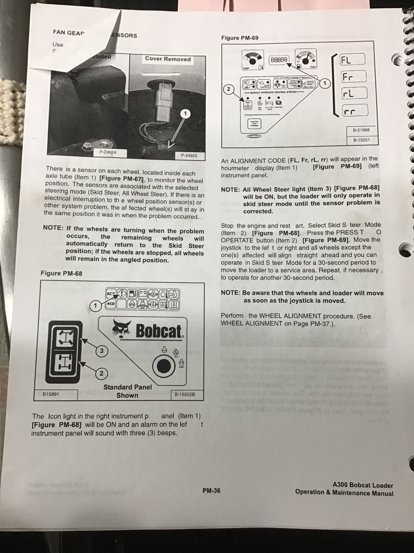

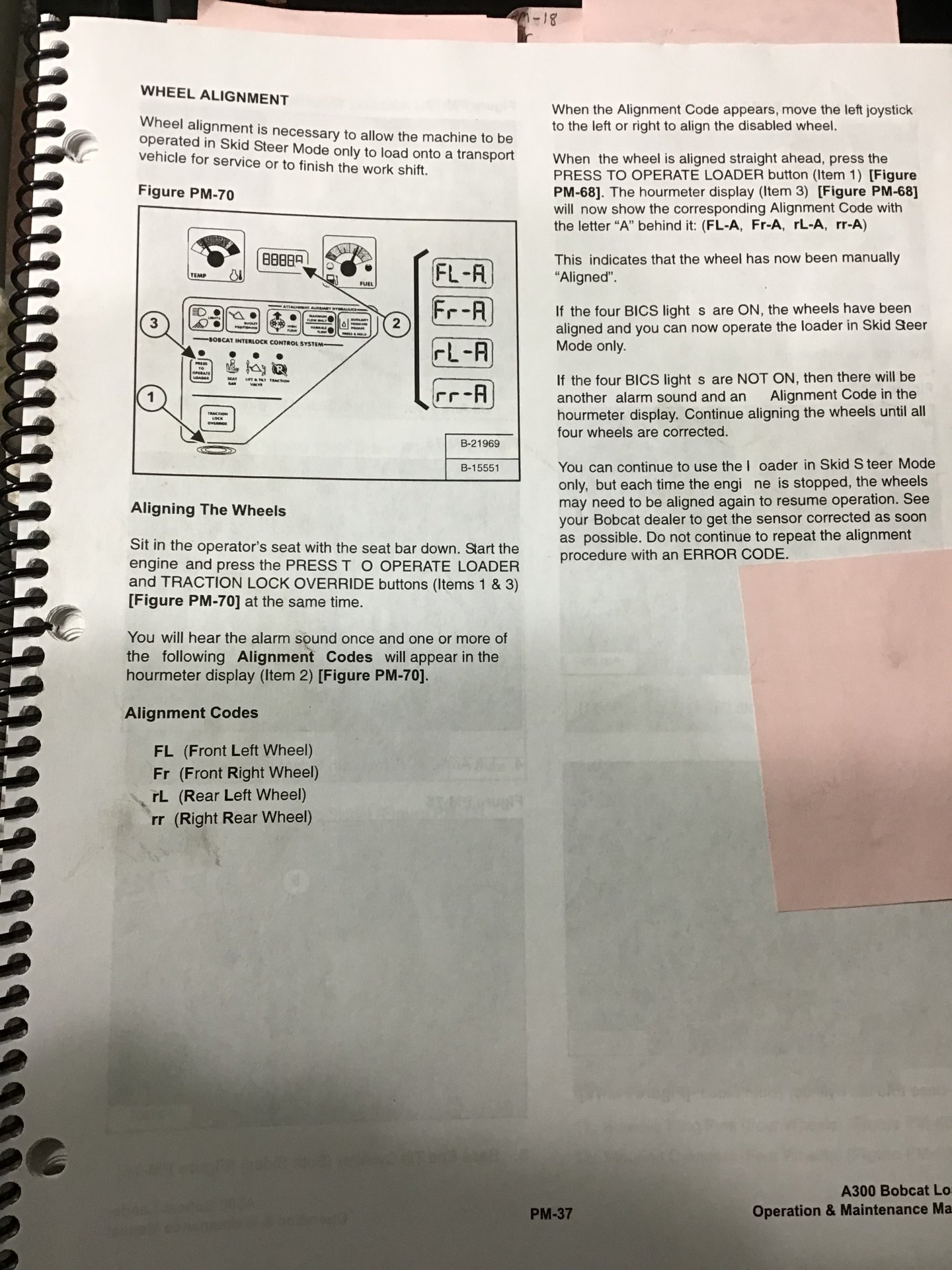

I know there is a way to control each wheel individually in case this happens so that the operator can get to a safe area.
You need to check your manual. I know that the procedure was in both the operators and maintenance manuals. I will check mine when I get a chance and get back to you.
Here are a couple of photos from the manual (my A300 is a 2005) that give the procedure for straightening out a wheel when there is a problem.
Sorry I can’t help with the actual problem but hopefully this will help when the problem happens and you won’t have to beat the wheel back into possition.
