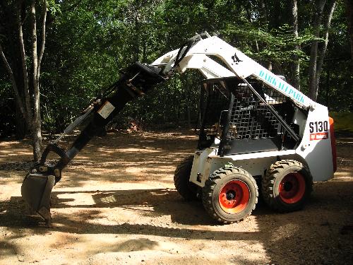

<blockquote data-quote="waggles" data-source="post: 29166" data-attributes="member: 3105"><p>Is the frame of the bob tach backhoe bent at all ? This could be forcing the pins back up when in use causing it to become looser as it wears. It looks like too much leverage is causing stress on the bobtach, you say the dealer has replaced it twice? Those pins are taking all the stress when digging , I dont believe it was designed properly for this to be happening . It needs to be bolted hard against the bobtach to stop the movement and take the load off the pins. Problem is then its not a fast change attachment, I would be talking seriously with your dealer about this not being up to the job!</p></blockquote><p></p>
[QUOTE="waggles, post: 29166, member: 3105"] Is the frame of the bob tach backhoe bent at all ? This could be forcing the pins back up when in use causing it to become looser as it wears. It looks like too much leverage is causing stress on the bobtach, you say the dealer has replaced it twice? Those pins are taking all the stress when digging , I dont believe it was designed properly for this to be happening . It needs to be bolted hard against the bobtach to stop the movement and take the load off the pins. Problem is then its not a fast change attachment, I would be talking seriously with your dealer about this not being up to the job! [/QUOTE]
