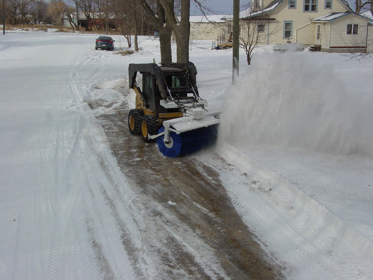

We actually sell more rotary brooms in the winter than the summer. If you get on the snow right away, they are great at getting right down to the base. If you wait too long, they bog down. You need a powerful one for deeper wetter snow. Not all brooms are created equal. Make sure the motor is adequately sized. A good broom can throw the snow.
Here is a snap of one that we sell.
www.skid-steer-solutions.com/Photos/heavy_duty_snow_removal.JPG
