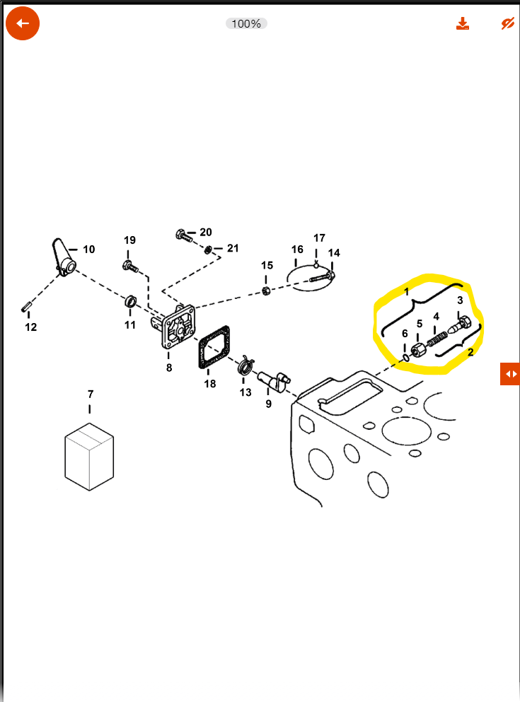

I think that i got everything squared away on the bobcat. I still have to get the air out of the fuel system and set the min and max adjustments on the throttle plate. But there is one more adjustment on the injector pump that im unsure what it does and how to adjust it. Its the adjustment screw/bolt on the backside? of the injector pump. Its part 1 in the parts diagram that ill try to attach and it says its a idle assembly. I do not know a good starting position for it as i purchased this bobcat with everything torn down already.
