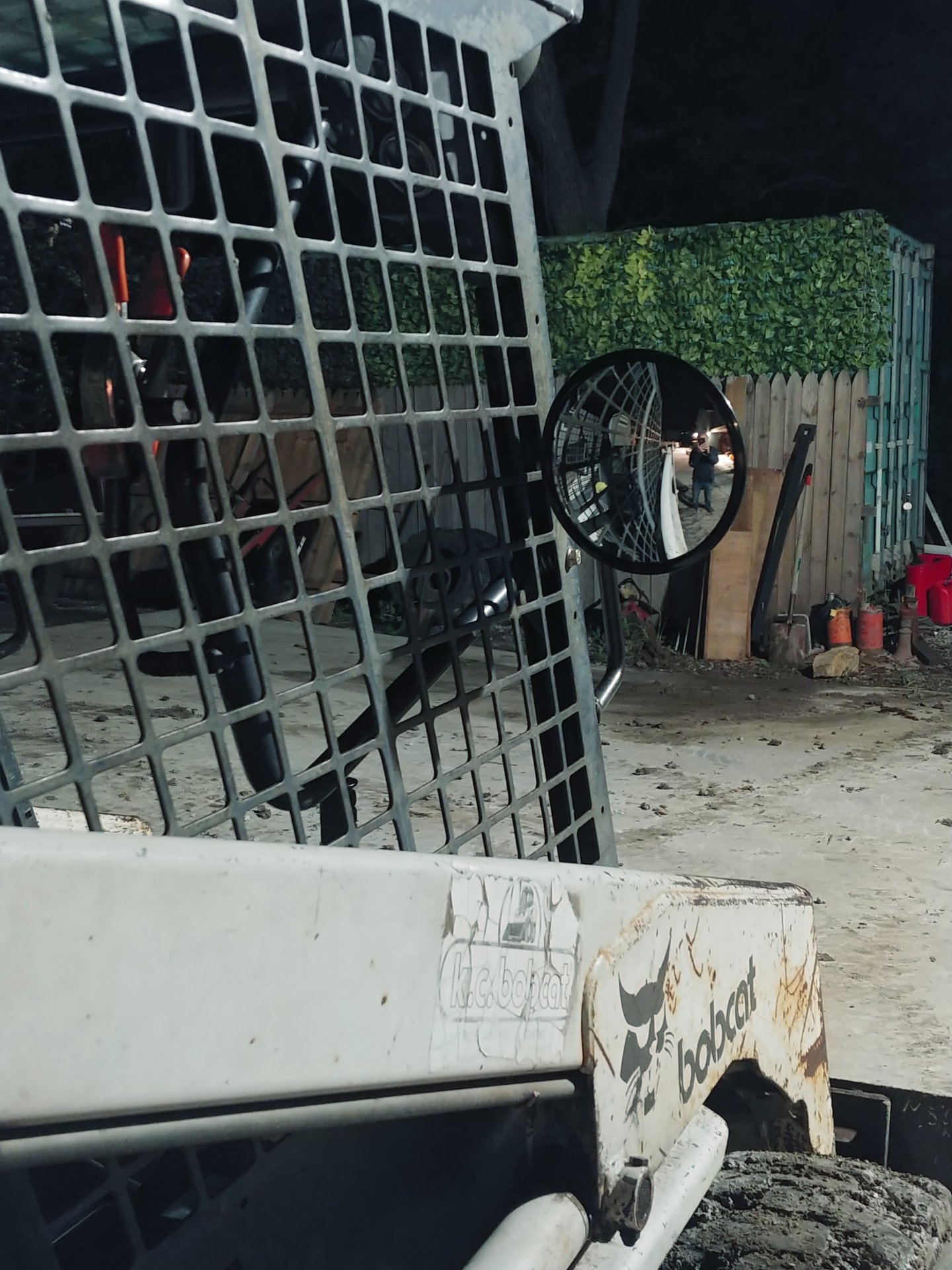

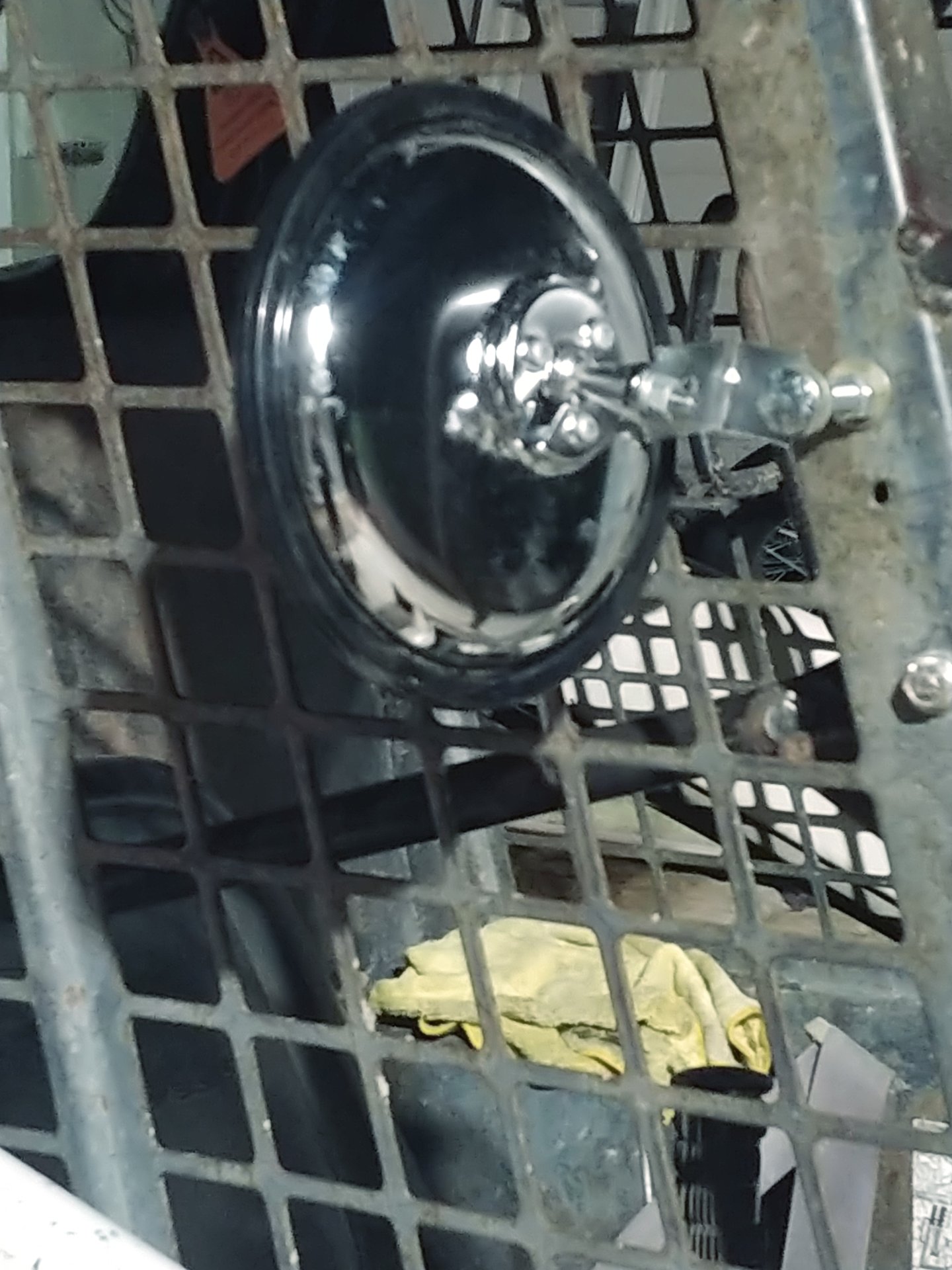

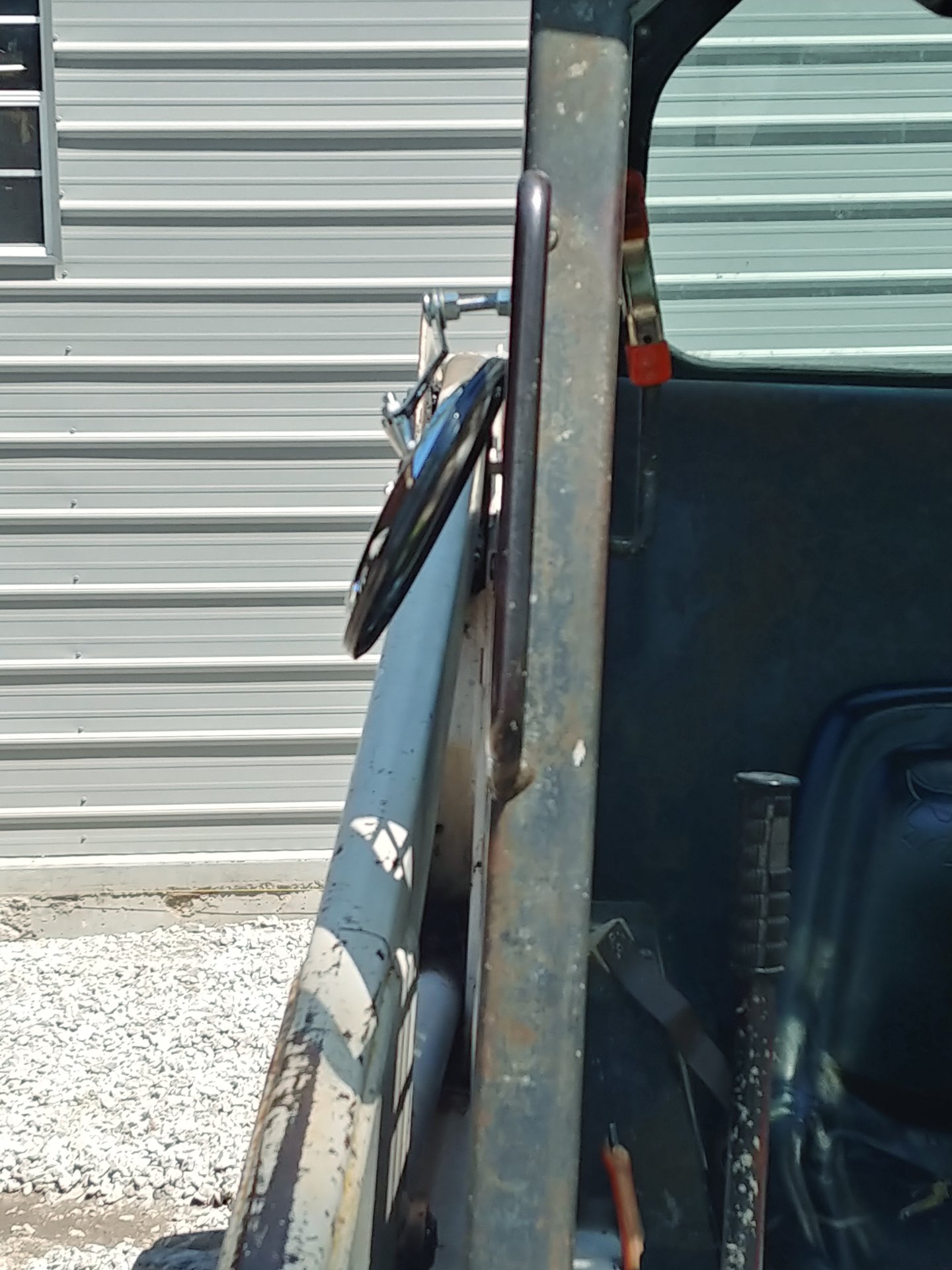

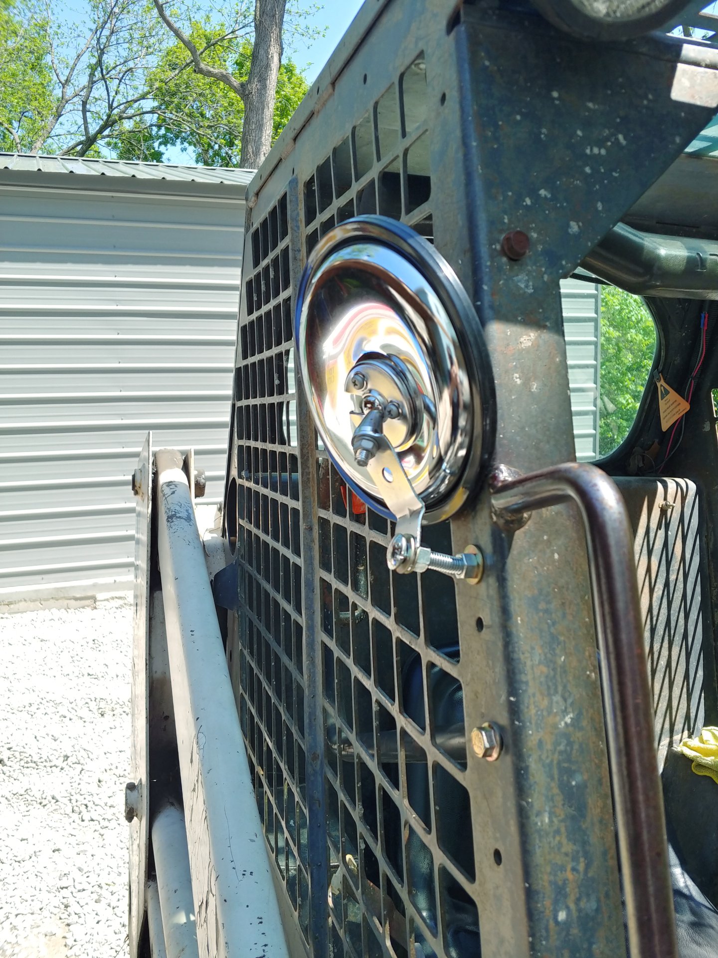

in case no one else is smart enough to figure out how to do this I wanted to share this genius idea of bolting a rear view mirror to the cage of a bobcat.
I would do a YouTube video to show how to do it and the results of it but I think it's pretty obvious from these pictures LOL.
before and after lifting the arms LOL
View attachment 6784View attachment 6785View attachment 6782View attachment 6783
I had mirrors on my 742B that were mounted to the inside of the cage in a similar position but higher. They worked pretty well and I didn't have to fold them in while operating the machine.

you are likely not the first to wipe a mirror off the cage, saw one years ago had magnetic mounts and stuck it to the top of the bucket, worked drivung around but first load of gravel they ended up in the pile.

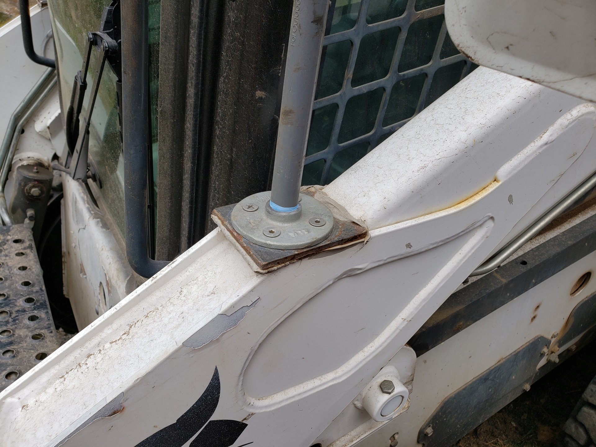

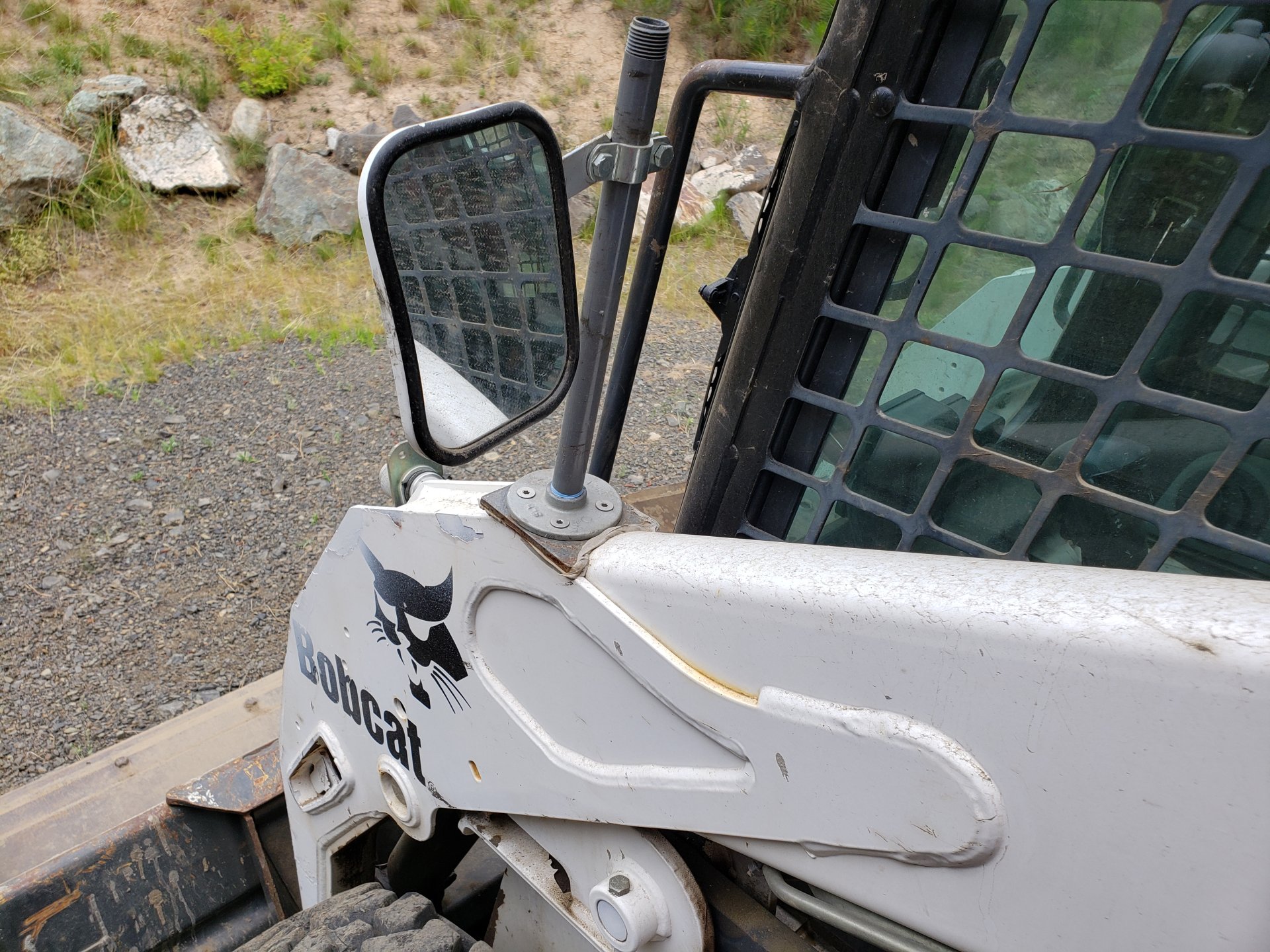

Here's a setup on the lift arms that I used for years. The mirrors are adjusted to work with the lift arms mostly down - that's where I do most backing up. The posts are just 1/2" pvc nipples rather than steel so they can break off if they hit something solid. Not a big deal to replace them. The baseplates are drilled/tapped to match up to the pipe flanges. The baseplates are glued onto the lift arms with one of the high performance sikka adhesives as the top of the lift arms are rounded. I'd be lost without the mirrors as I'm usually working at the edge with a fill slope below.
