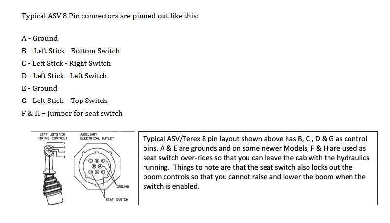

While the above wheel repair is happening i am ordering an after market mating 8 pin plug that will plug into the OEM connector on the ASV 60 machine that will allow me to joy stick control auxiliary cylinders for a hinged arm grapple for use with forks and eventually a rotator and log grapple.
This is the plug i just ordered and pins that will plug into the ASV female plug already on the machine.:
https://www.digikey.ca/en/products/detail/te-connectivity-deutsch-ict-connectors/HD36-18-8PN/6600329
The solid pins to install in the new plug to receive wires
https://www.digikey.ca/en/products/...deutsch-ict-connectors/0462-203-12141/6566689
I plan on using SAE connectors { down stream from this ASV aux hydraulic plug } to run hydraulic solenoids. I will likely use something like this if i make a small housing to hold the plug..
https://www.walmart.ca/en/ip/Solar-...3UVD&offerId=CC87F5F71FF14A0C96F144EDA18FC03A
lastly... the pin out chart for the oem 8 pin ASV plug it is in an attachment.. not sure where it will show case in the thread
