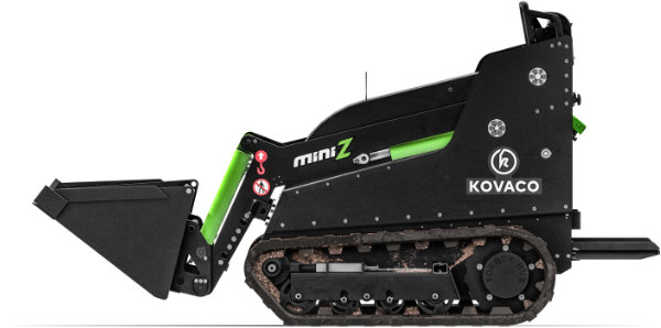

Good morning, Sorry I'm late to this, but, you could try the Electric Skid steer from First Green with a width of just 31.9" and 400 kg lifting capacity. The mini Z electric skid steer is available to hire or buy from https://proarb-machinery.com/product/hire-miniz/
Please let us know if you have any questions
