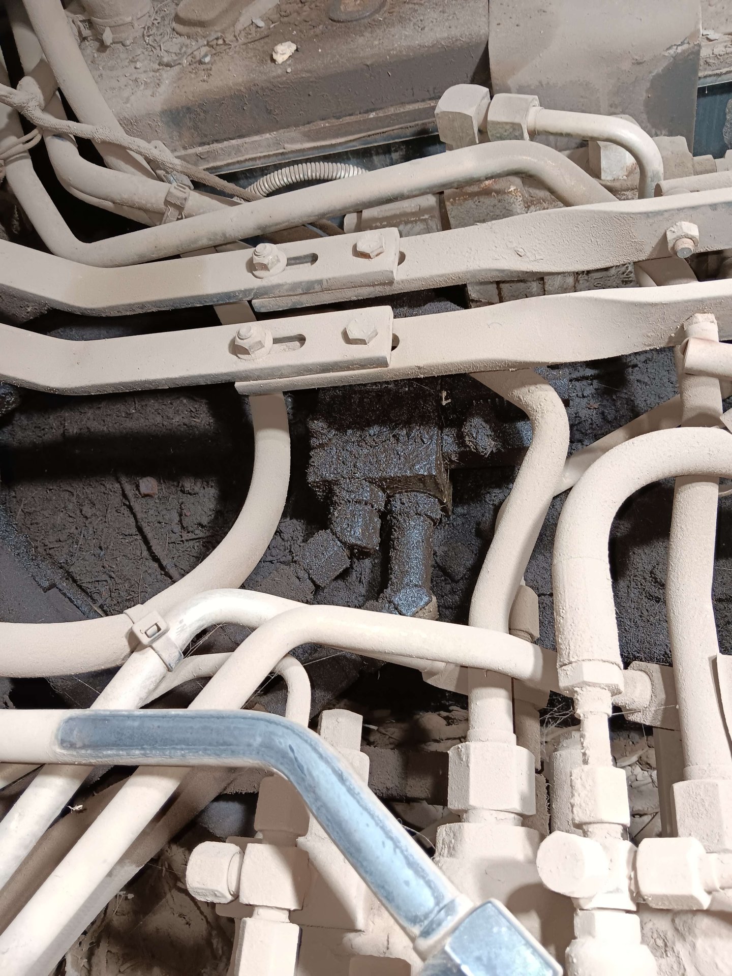

Hi all, I have a S205 I bought 3rd hand. Had a few very small leaks, then suddenly dumped 300ml+ of hydraulic oil through the centre bottom (as in, apparently not a wheel drive gasket issue). I'm an ok mechanic on old tractors, but can't afford to eff around and find out with a skidsteer. I had a look under the seat and this is the photo. Whatever is on top looks pretty leaky. I was going to have a mobile mechanic out and I'm wondering if I should try and clean this up with some degreaser and then idle the machine just prior to the visit? Or should I just leave it as is? Thanks in advance, Cheers bobcat2.jpg

My .$02 - I am a mobile mechanic and I work on skiddys. I would always prefer dry flat ground, sunny day, and lemonade served by the Tropicana Girls Bikini Team. I almost never get my way. Yes time is money so anything you can do to make his job faster saves you bucks. That said, a word of caution on the cleaning. He's going to have to clean it, so you can do that ahead of time IF the leak is apparent. Sometimes the dirt is a good indicator of the leak's location. If you clean it, and the leak's location does not reveal itself, that may create a problem instead of solving one.
as a mechanic i will disagree to a certain degree, yes i agree with having a clean loader, definitely makes thing nicer to work on, but when it comes to hydraulic leaks, especially minor leaks its a lot easier to find a leak if u leave it as it was, if everything is clean i have spent more time trying to locate leaks
personally do a good job of pressure washing and make it clean, let it dry and dust with a fine powder such as flour, start it up and the leaking area shows up quickly, I would clean it well, go over the hose fittings some couplings have O rings that dry up and weep,
bringing a mechanic on site is expensive so cleaner the better especially as time is money
one can also after cleaning add some dye to the system and that tends to help find leaks faster as well,
