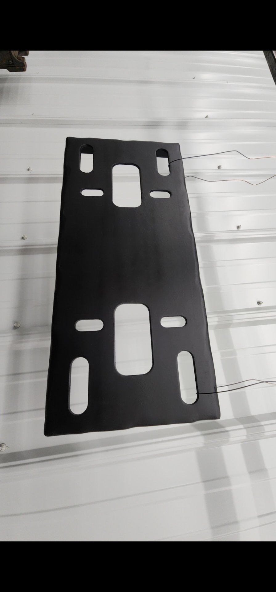

I designed and fabricated a fully adjustable engine mount on my CNC plasma table. The goal was to make a mount that could be precisely aligned and securely bolted down.
Here are the key features I built in:

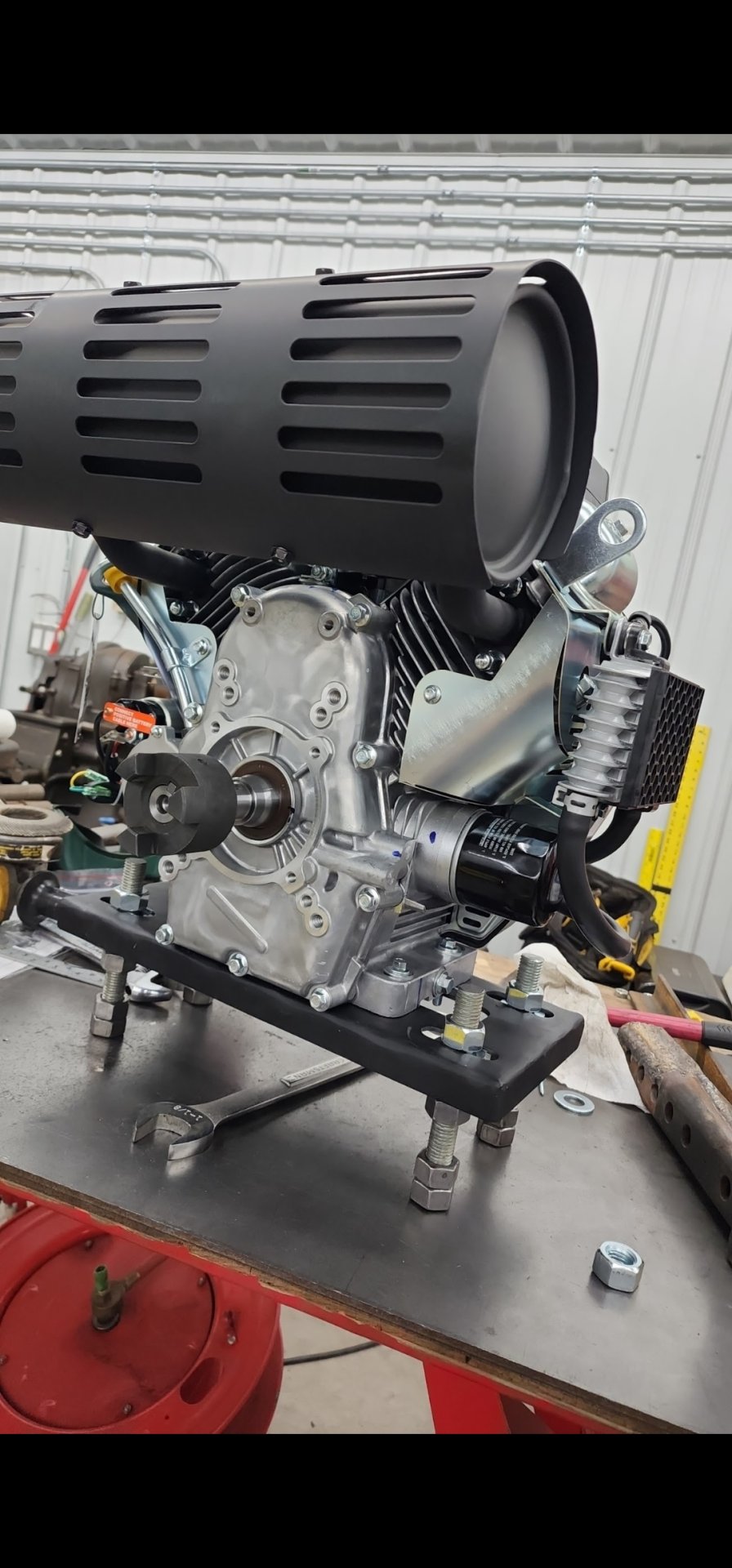

· 3-Axis Adjustability: The engine can slide side-to-side (X), in-and-out (Y), and up-and-down (Z) for perfect coupler alignment.
· Pitch and Yaw Adjustment: It mounts on four 3/4" threaded rods, so you can also tip the engine to correct for any angular misalignment.
· Industrial Rigidity: It's not just a flat plate. It has 1" sides bent down to be welded to a base for incredible stiffness, preventing flex under load.
· Practical Touches: I even added holes for oil drainage so you can do oil changes without making a mess.
Here's a shot of the mount right after I cut and bent it:
On the work bench you can see the four threaded rods that allow for all the adjustment:

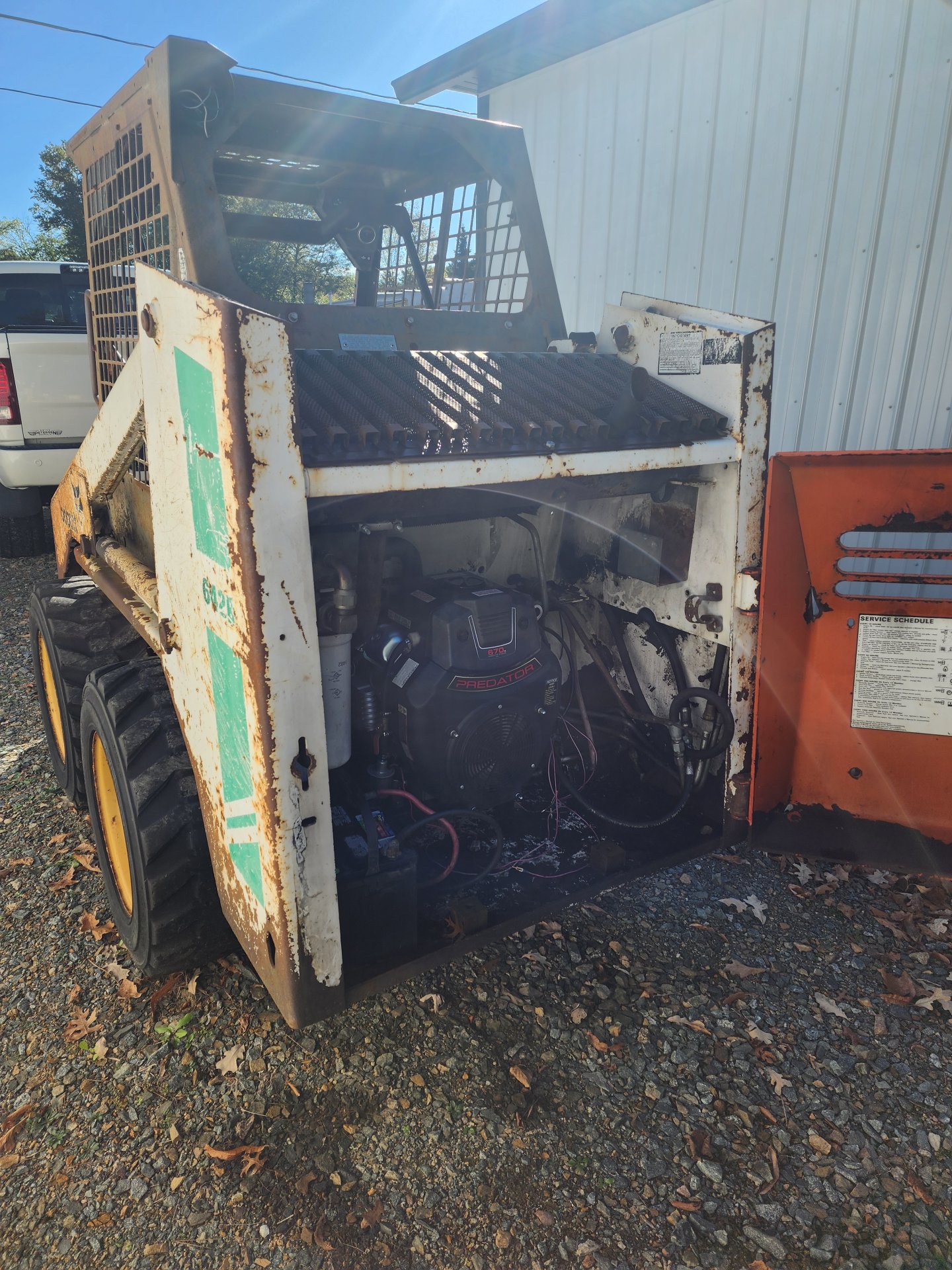

And here it is installed on my skidsteer
The result was that I had the engine perfectly aligned in under 10 minutes. No shims, no frustration.
