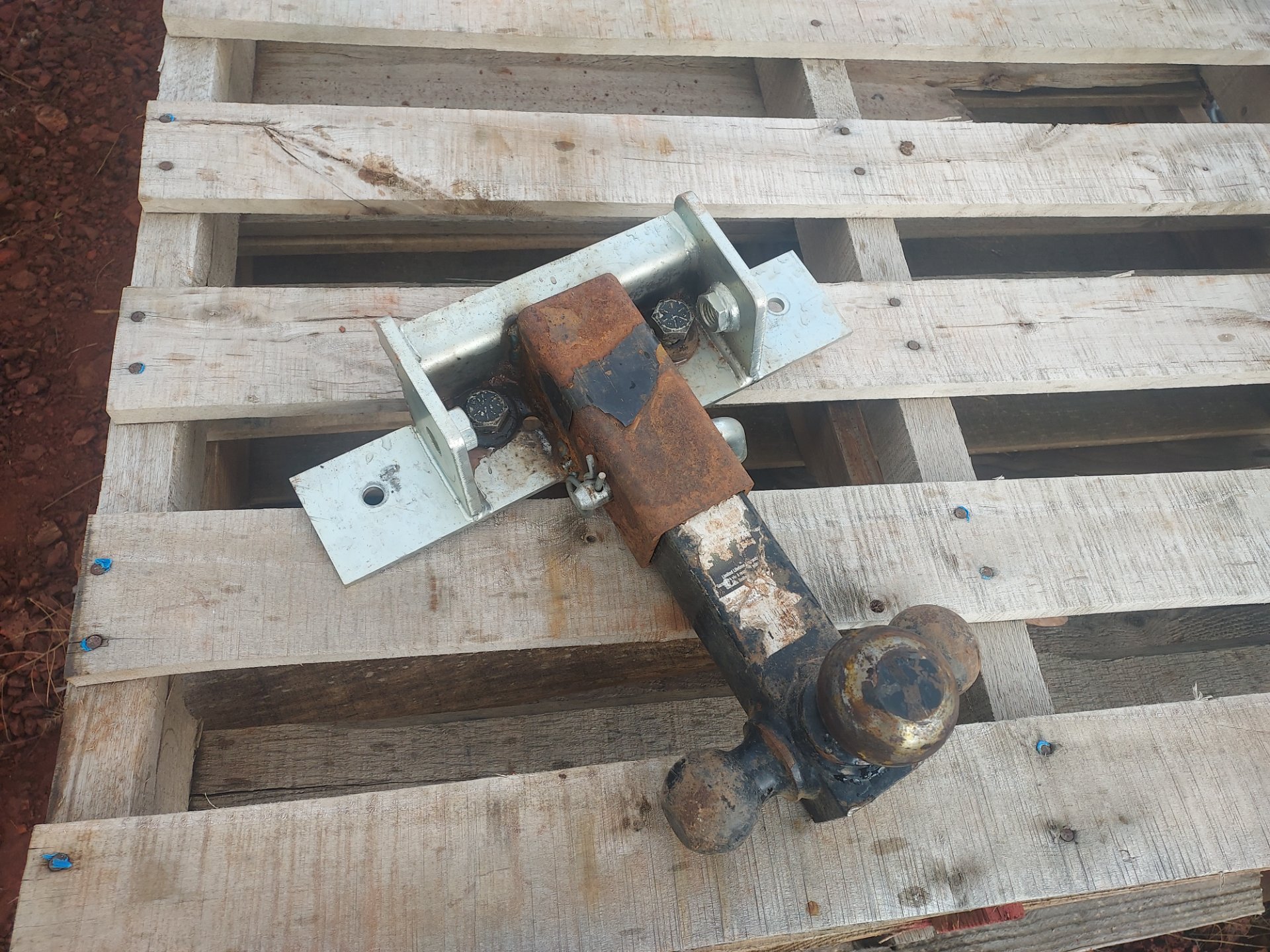

Mine is a 2½ to 2" hitch adapter welded to a piece of 1/4" angle. I drilled holes through the angle and the carriage. I used some 5/8 bolts with washers to mount it to the carriage. Just stuff I had laying around.

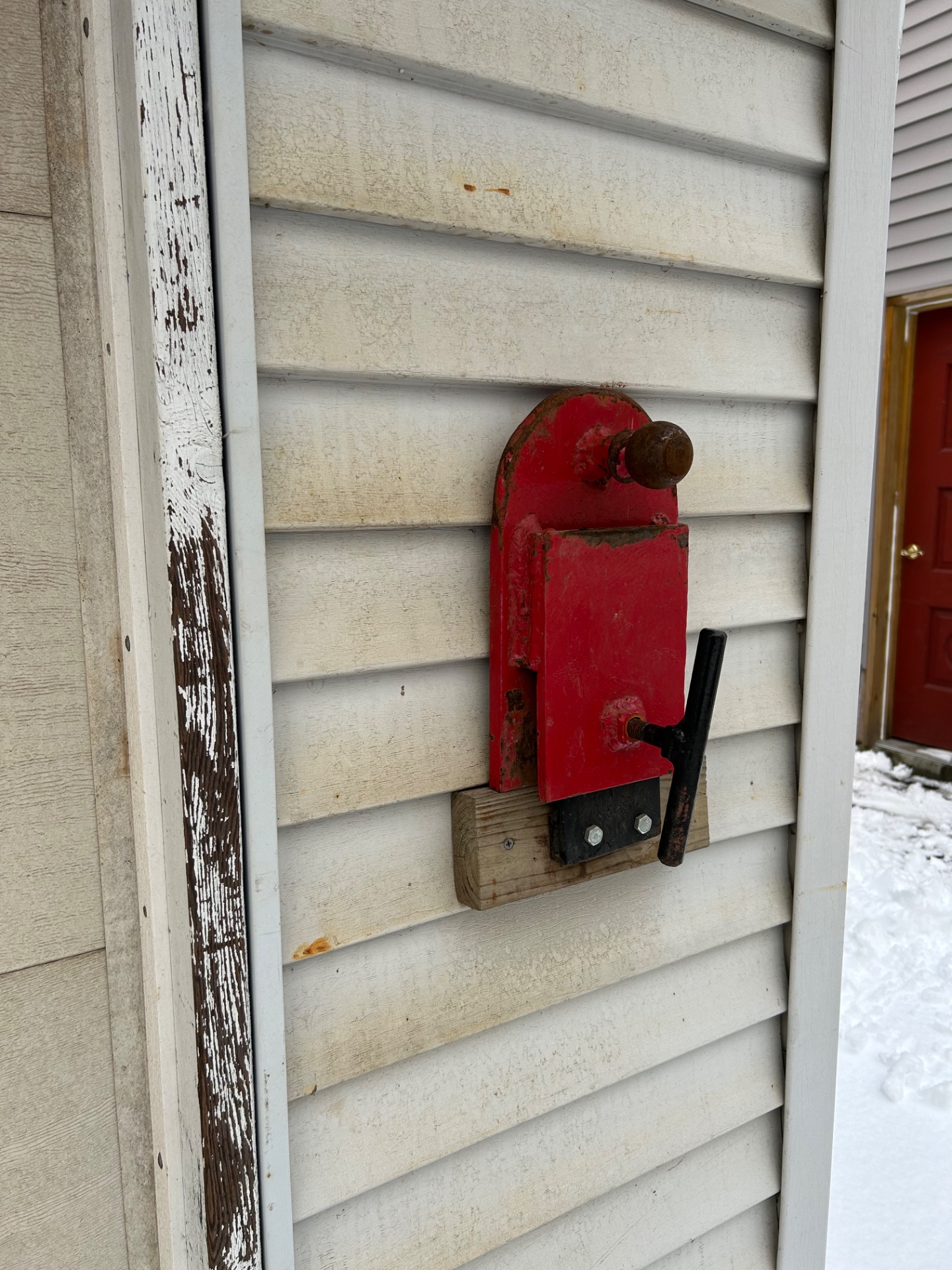

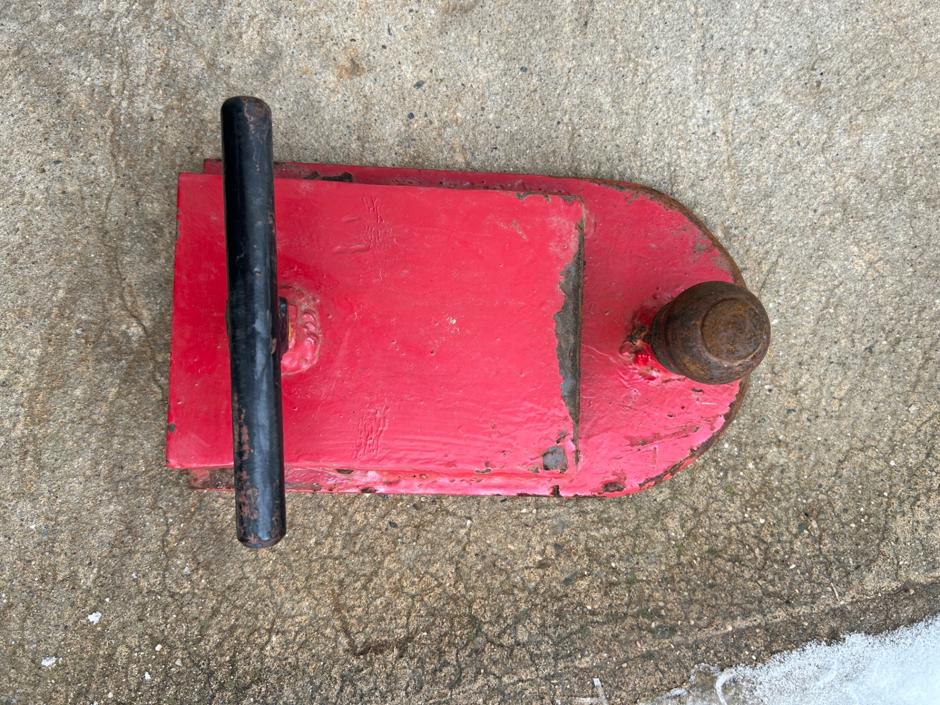

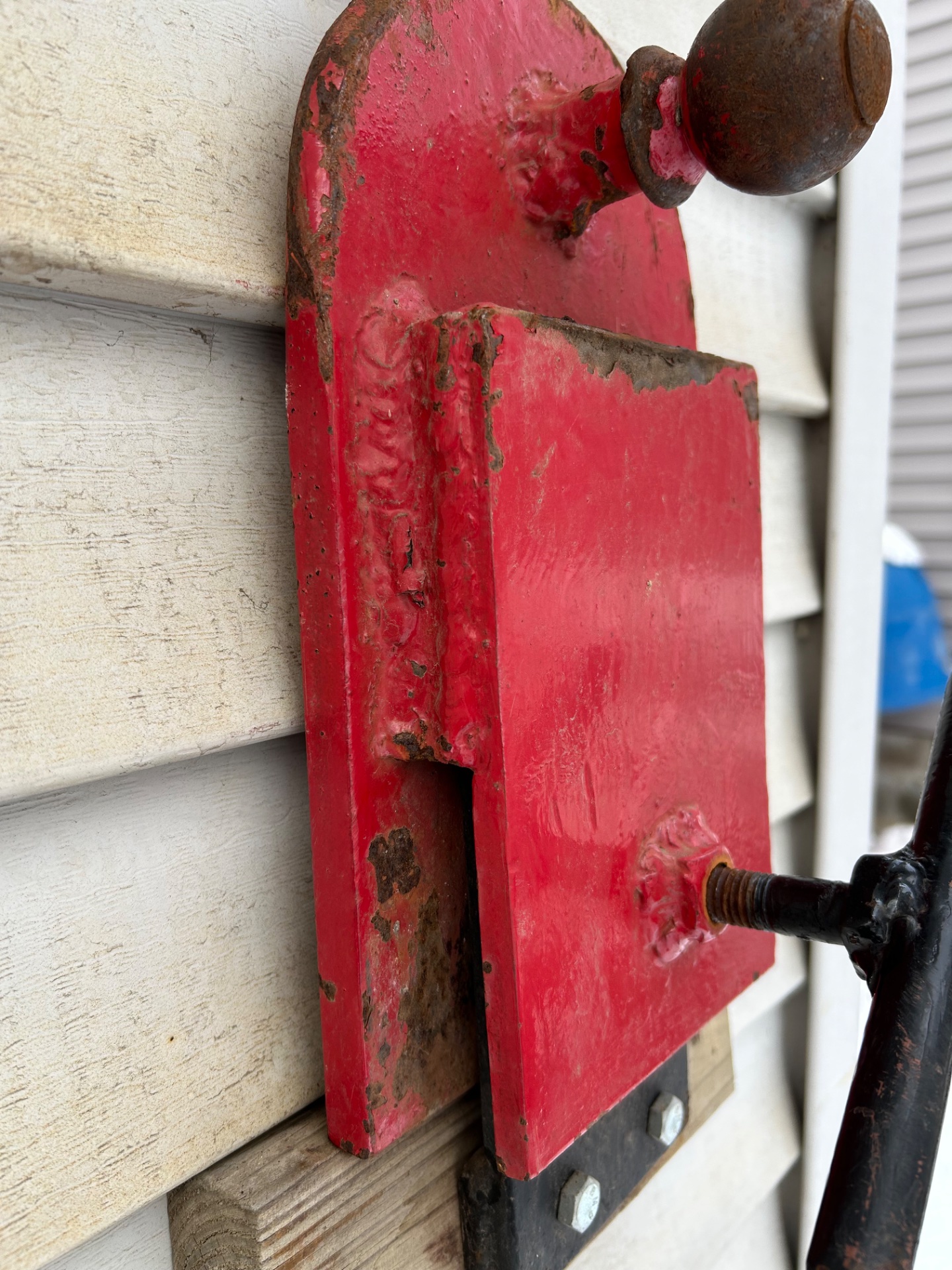

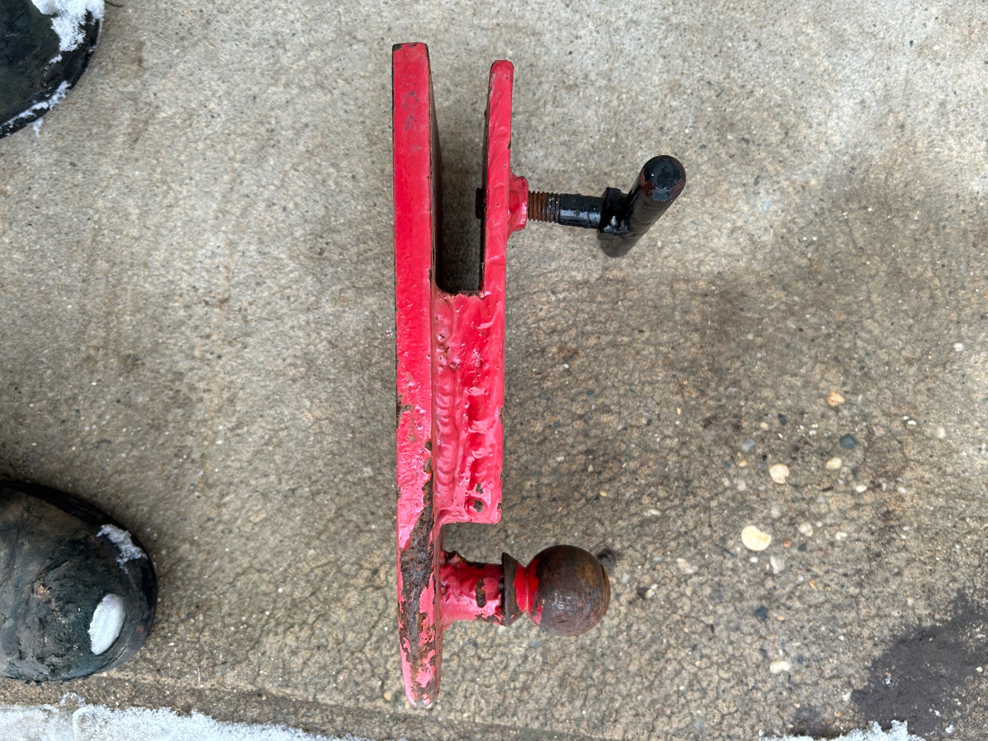

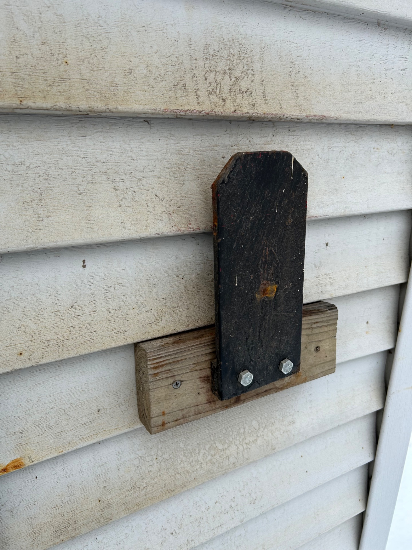

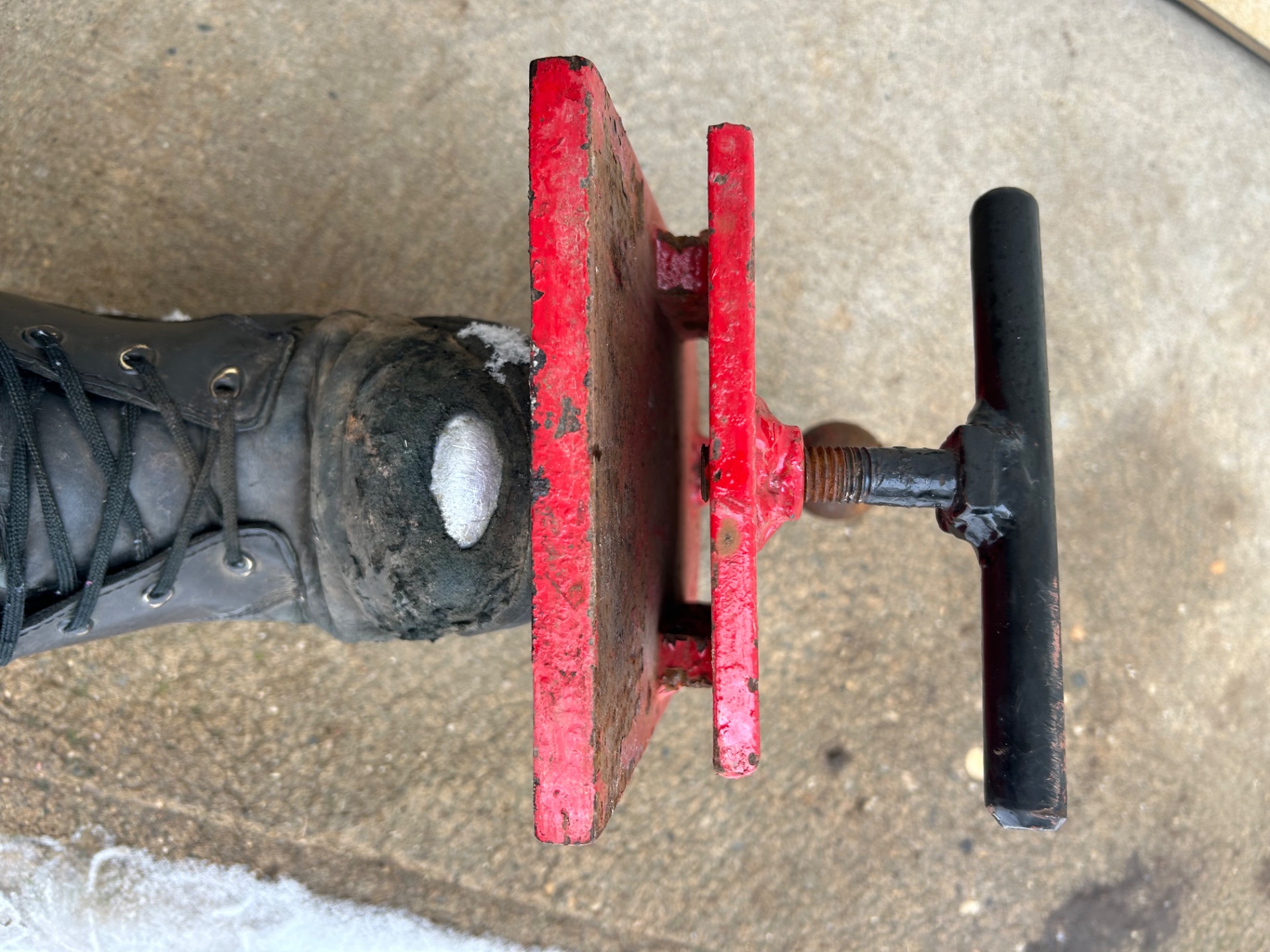

Use it all the time. Smallest ball I had so it fits all size trailers and my Pintel hook. Fork butts against ball to stop it from sliding down the fork. Top and bottom plate extend about 4 inches so I can slide it on my bucket too. T handle to tighten down on Fork/bucket. Makes it easy to kick loose after it tightens up on you. Through bolted a piece of flat stock to my outside garage wall to store it at the ready. Scrap metal welded up with a sacrificial trailer ball, a nut and bolt. Can’t say the weight rating but empty trailers are a bunt.
Just saw you want to move a 24 ft TT. I have a more substantial 2 inch receiver tube welded to a flat quick attach plate I made that I would more likely use for a TT. I would still try my small fork adapter so as to not be changing attachments. I believe it would work. Slow but steady. Great on maneuverability.
