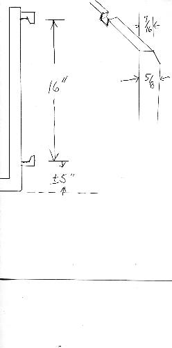

I was out today and got some measurements on my forks (Hyster H50H 48" 5000lb forks). I was right about the chamfer, not sure if it's only Hyster or across the platform, but here are some rough dimensions.
Go by the forks that you have, you'll want as much face contact as you can get on the slides. When you're laying things out, make sure the forks can rest on the ground with the boom lowered all the way, my forks rest on the ground with the bottom rail about 5" up, hopefully the quick attach plate is big enough that you can get the positioning right.
