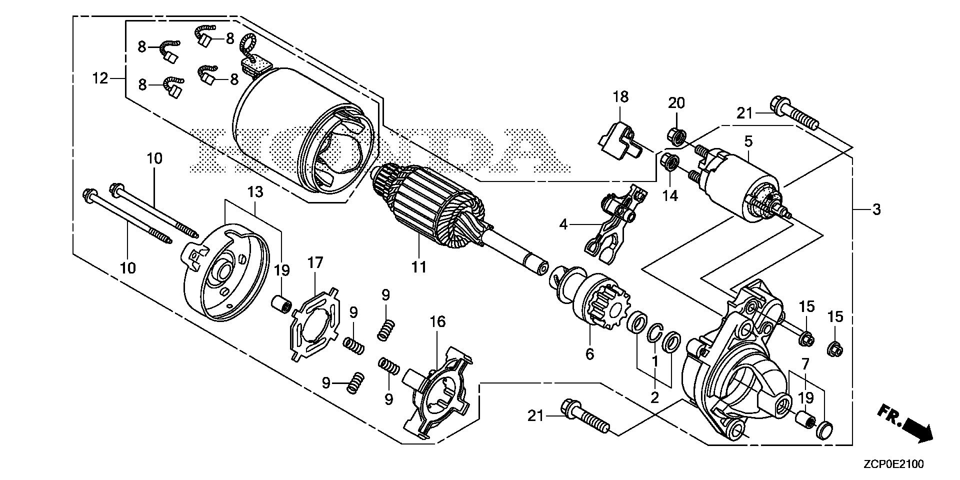

Dont honda engines run counter clockwise? Perhaps the person that installed it thought he needed to reverse the ground for that. In any case if the engine did start and run in the wrong rotation (would run poorly) wouldn't that prevent the starter drive from disengaging? A starter that cannot disengage will burn up quickly. I have seen many starters that have splined grooves in the armature shaft to retract the starter drive. Rotated the wrong way they will force the drive to stay engaged. That starter does have the splined grooves. Pic below.
