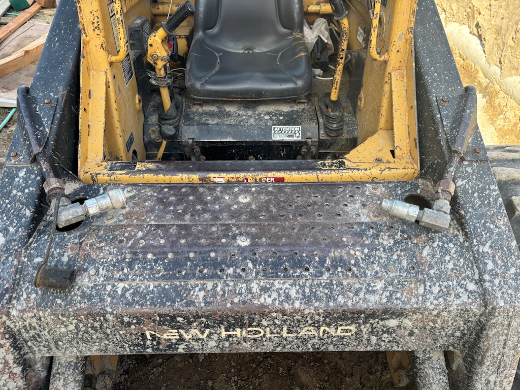

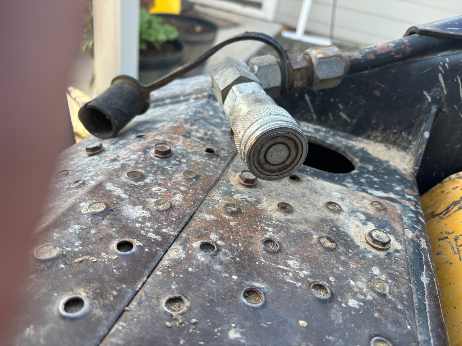

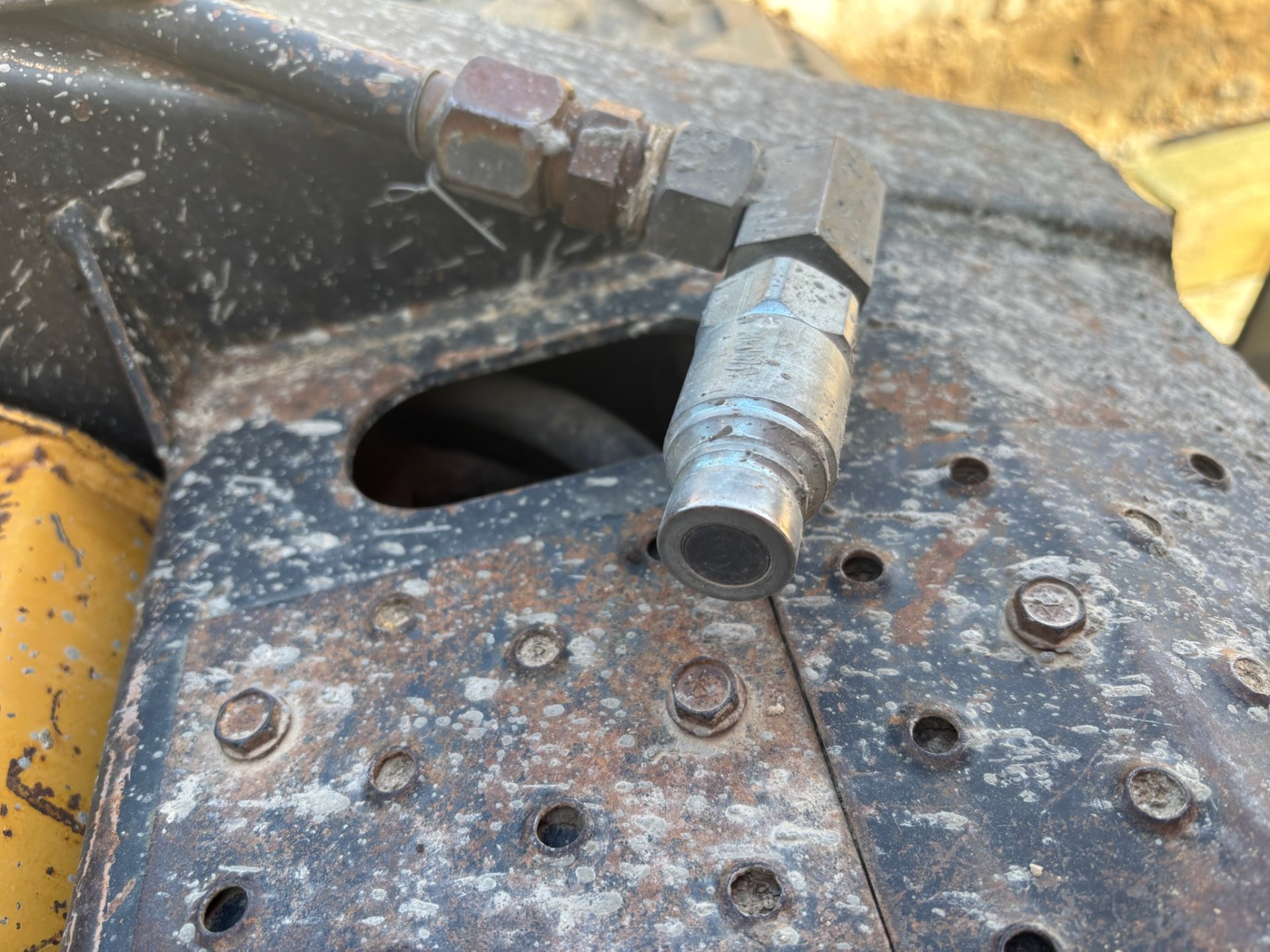

Any thoughts would be greatly appreciated, have included couple of pictures of my hydraulic connections.
1989 NH L785
Thank you.

things to consider will be, what the GPM of your hydraulics are now, and then making sure you get attachments that have rates below what your machine makes!
flow rates on new machines are many times way higher than on older machines, thus, many modern attachments will not be usable on older machines, a mistake many make and find out after buying something
also, you have to make sure your quick attach is of the modern type, I say this, cause I know some older machines had a different set up from factory, they do sell adapters now and conversions, , but no clue what your exact model has,, so making sure you have the modern design is important here as well
next will be hydraulic fittings and or electrical connections,
some implements will have there own needs to be used!
Attachments with just a push/pull hydraulic cylinder will probably be no issues.
attachments with motors, as stated above, look up your aux pressure & flow specs first.
also, some attachment motors need a connection for a case drain in addition to "pressure & return". The items you mention should not be an issue with weight, but some of the brush cutters & drum mulchers get pretty heavy, so you might also want to check weights just to make sure.
From the photos, your hydraulic connectors appear to be the "flat face design" ( newer than what was on my LX865 ), but they are just fittings that screw off & on.
happy thoughts, CE
