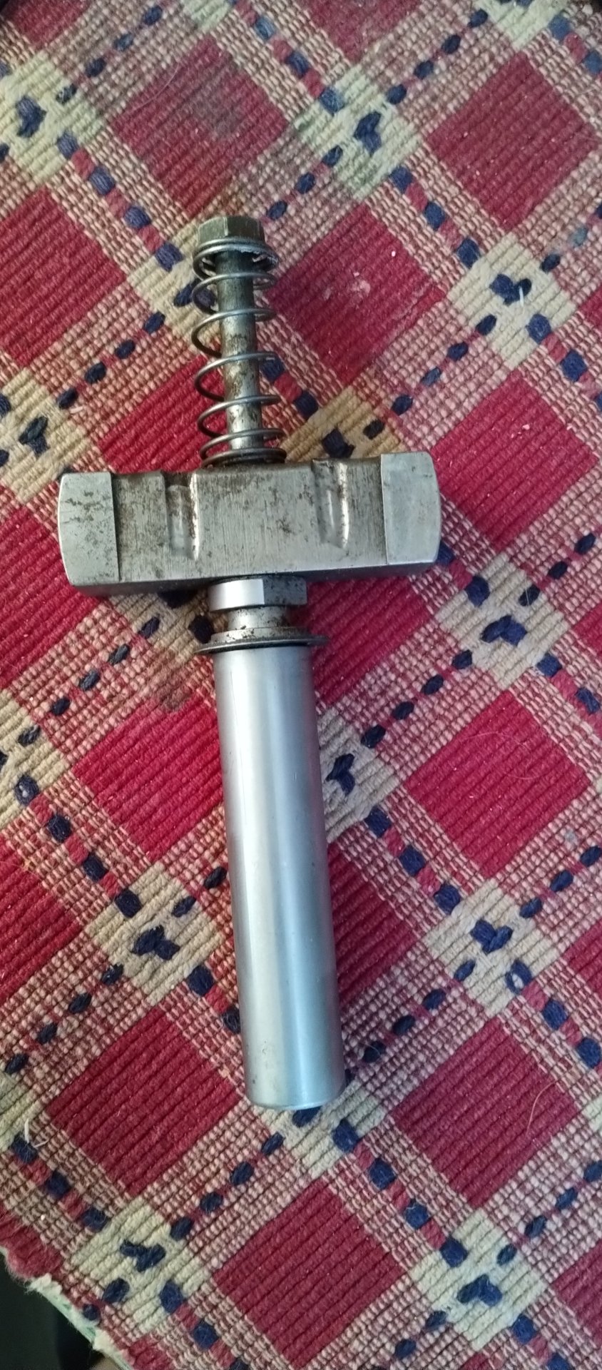

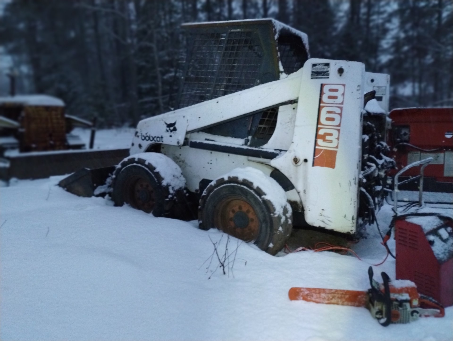

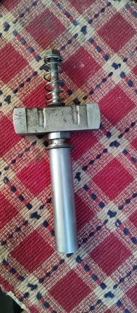

Hello this is my first 863 bobcat I was gifted this loader and have few questions! one of the drive motors was rebuilt or replaced I'm not sure. I have to push one handle further than the other to go forward is there an adjustment I can make? the other is that I was given a brake part and said that it needed to be put back in and i needed an elec. park brake selenoid? I have some pics. the best i can tell its a 1991 but as I said I'm 100 percent new to owning one! thanks ahead of time and i really appreciate it!

First of all here is a link to the Bobcat parts catalogs:
Enter in your serial number and search "brake".
Yes the levers are adjustable. Make sure that there are no cracked, broken or loose linkages before trying to adjust them. There is a post on here that someone has to a video on adjusting them.
