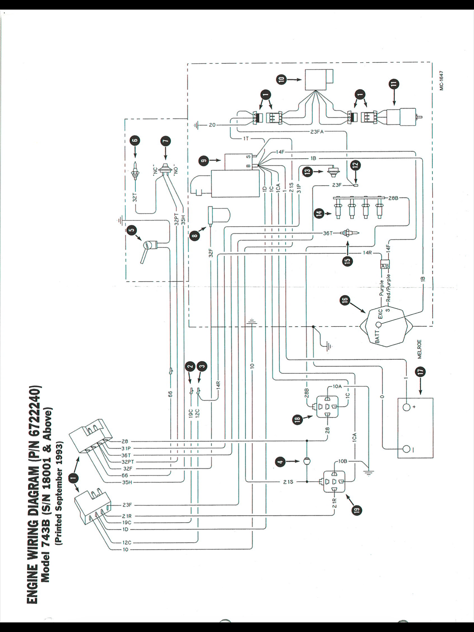

I put a new selenoid on my 743 bobcat, the wire for the glow plug broke off, I did take pics of the before change but I can't really tell where it goes. My problem is I am not getting power to my glow plugs. Does anyone have a diagram that shows where the wires go.
Not sure what model you have but this is the wiring diagram that I’ve got.
