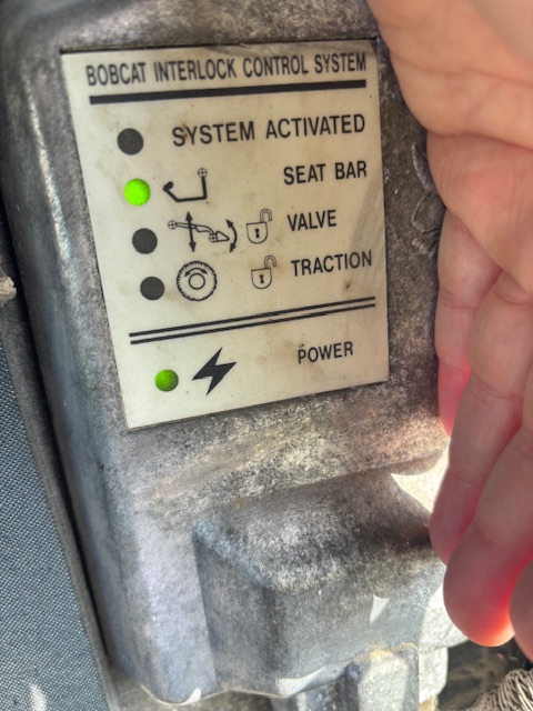

Hello, I am a new member in the forum from Hungary, landed here after purchasing a bobcat 463, and having some problems. Currently I have a BICS issue, tracktion lock and valve light does not come on, and of course the machine is not moving. It starts fine, engine runs, hidraulics are working, there is no blinking on BICS, only the lights are off (see photo). Appreciate any info or help

Hi there, look underneath your seat. Is there a switch? If yes, unplug and bypass with a paperclip and see if everything works.
Sorry, I was out for a while. I will check this switch and come back to you with the result. Many thanks
