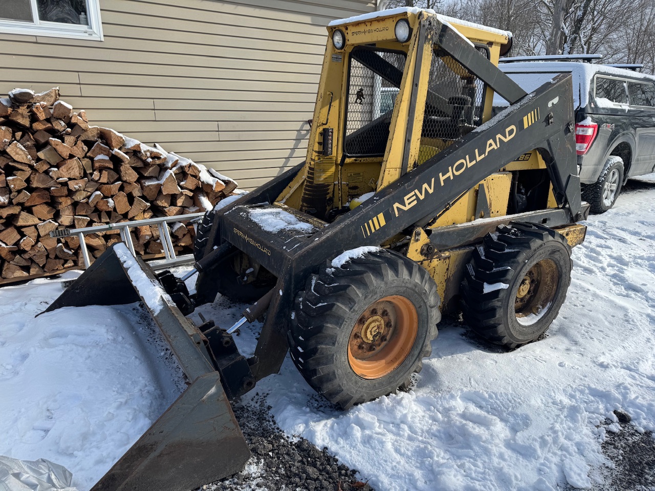

I bought an old 1994? New Holland L785 skid steer last year. So far it's been good. Starts and runs fine in the summer but It needs some maintenance, (filters and fluids). This winter I can plug it in to the block heater and it won't start. Last winter it worked fine but I guess it's colder this year or it doesn't work anymore. After tons of cranking I finally got it but this is not ideal. It was 15* outside. Where would I find the best manual for this thing. I need to learn about it a little bit. It's got a Perkins engine in it and about 5300 hours on it. Also where would be the best place to find parts for this model. Thanks in advance…

Nice pic of the machine think you could add a shot of the block heater location on it. Ild love to add a permanent one to mine.
