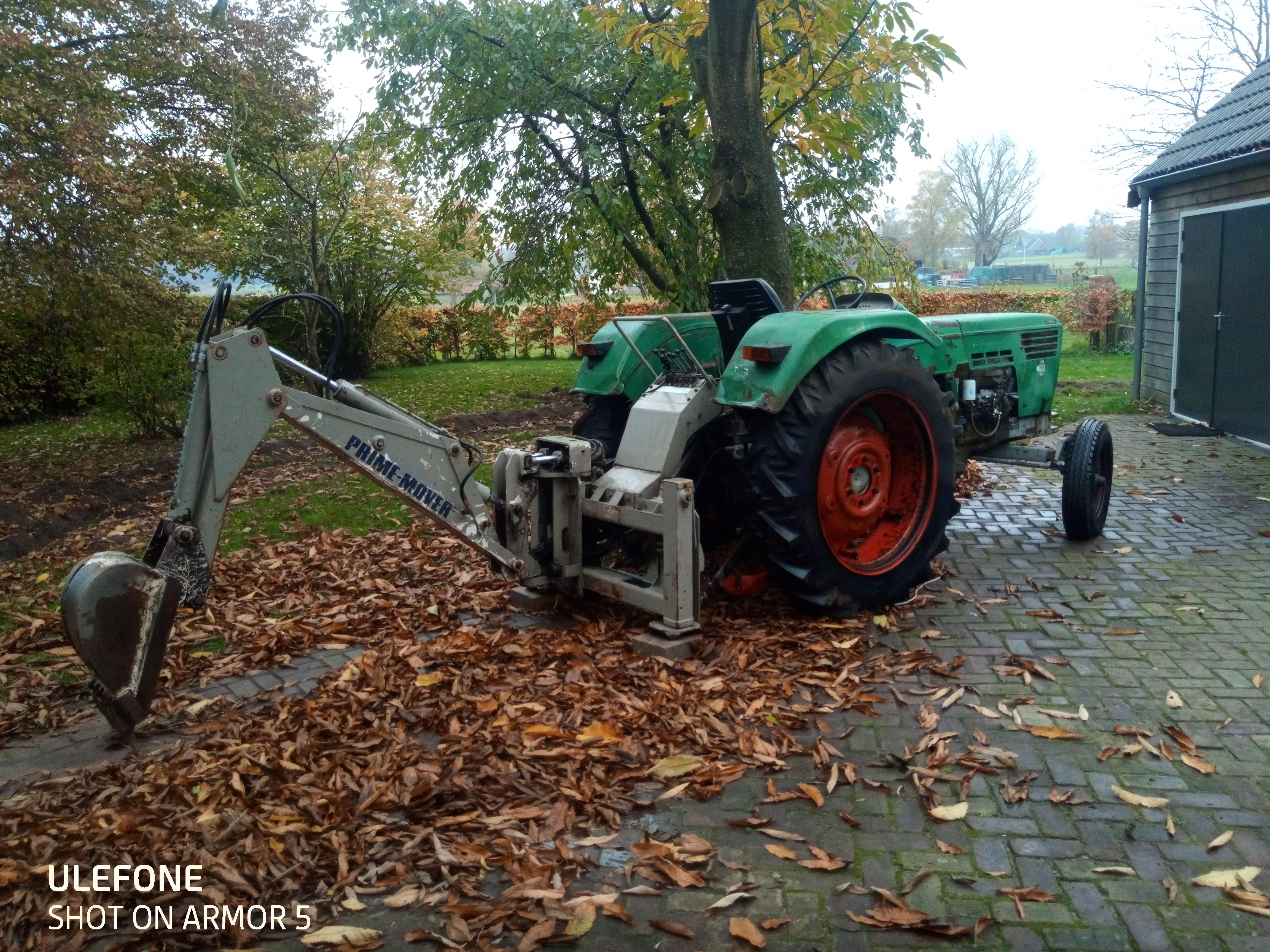

The reason to look for this one is that I already have a Prime Mover Backhoe. At present the Backhoe is attached to my Deutz D4006.
The Deutz can lift the backhoe easily, but I am wondering if the LS75 can lift it. The thing weighs about a 1000 pounds I think.

The specs I found, suggest that the LS75 only lifts about 700 pounds, but I would be more worried about the size being out of balance with the backhoe, the LS75 is pretty small, and likely lite too. From what I have seen, the soil in the Netherlands is pretty sandy, but if you get into tree roots and what not, you might be going for a ride. Then again, that can be true with bigger machines too. What is your price range? I have a good t190 with highflow I picked up in the Netherlands for around 17,500.00 a few years back, so there are some good deals out there, and the 190 at 3800kg and little over 900kg lifting won't have a problem with the backhoe. Hard to tell from your pictures, does the backhoe have three point mounting only or an adapter plate from skid steer mount?
