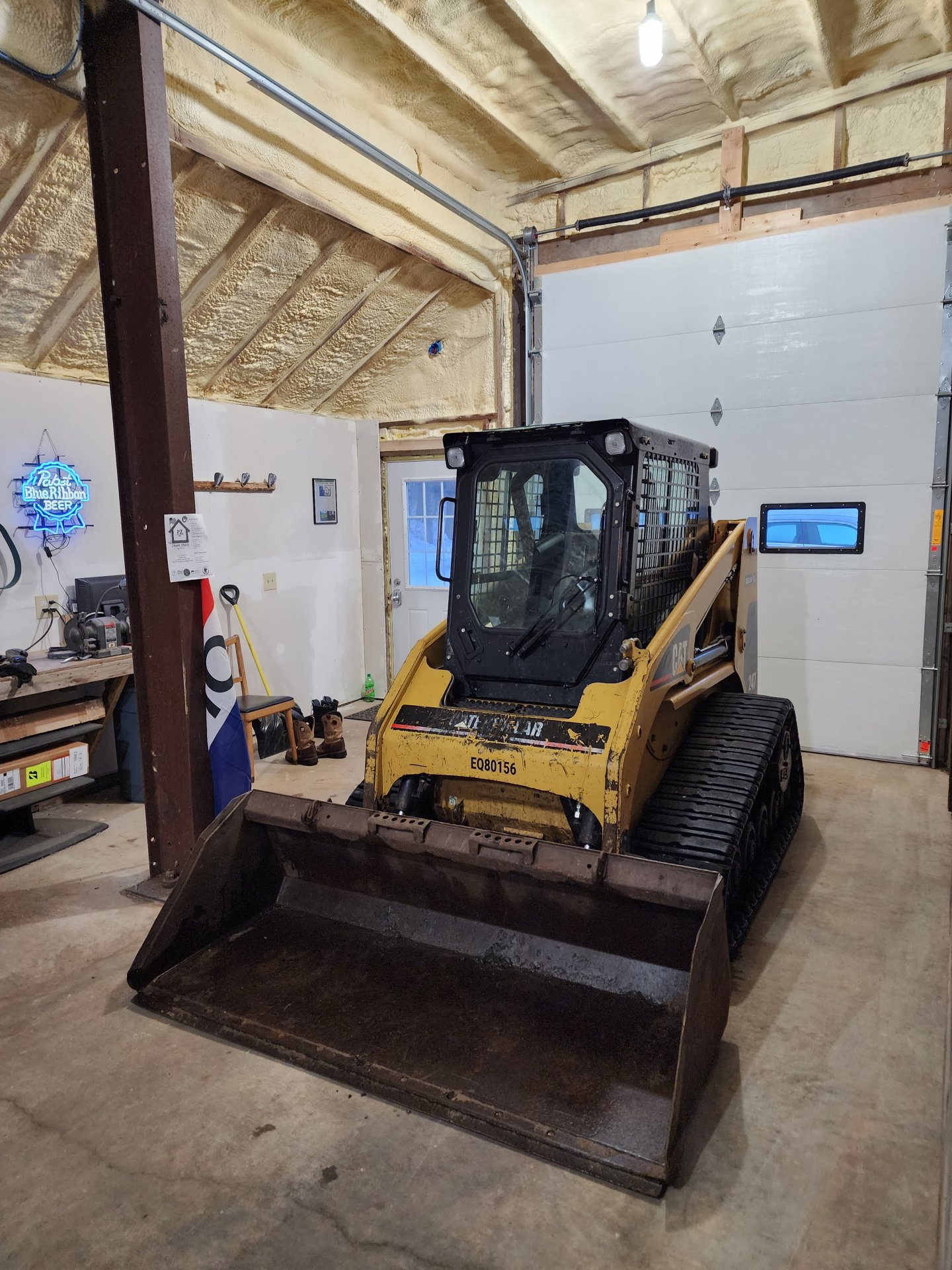

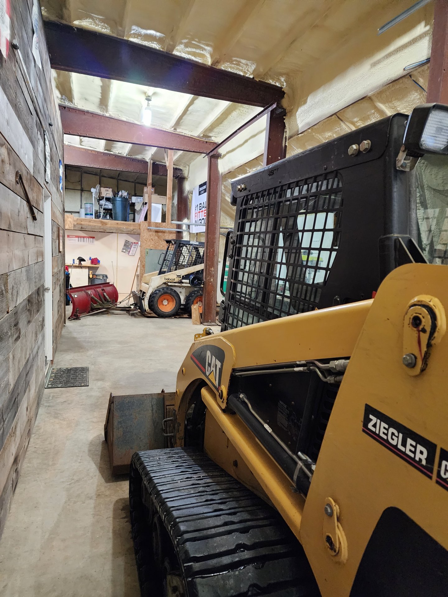

I did a thing ... Made the choice today and picked up the Caterpillar 247.
    481.5 KB
    497.5 KB
I have 2014 289 .
Good machine .
Check drive motor hoses where they go through side frame under tracks they rub get cut on metal black plate . I blew two lines 3600 hours .
Change final drive planetary oil and keep tracks snug .
I lost tracks on side hill turns . Easy to get back on .
Your year doesn't have DPF Regen teir 4 like mine.
CAT ET scanner is a good investment. I have a 308 excavator also and fix my own equipment.
Good luck

I checked the hoses for chafe all look good. Don't know what et scanner is...
