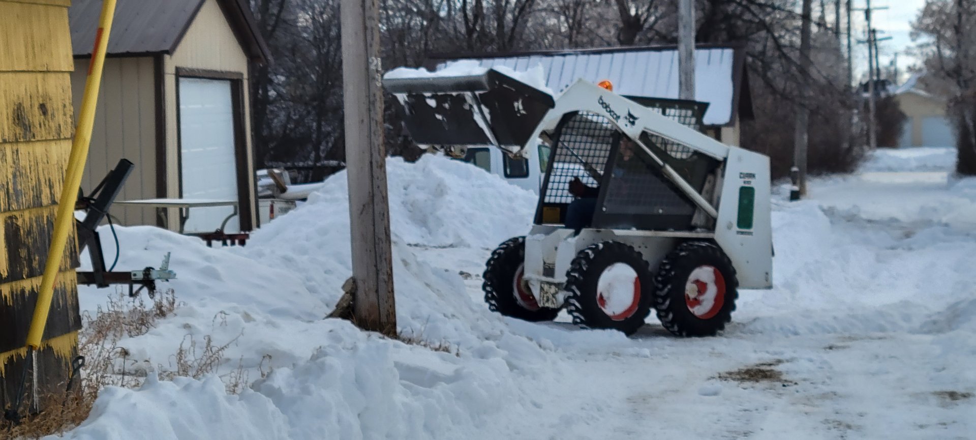

I have a Bobcat 632 to do exactly what you're looking to do. I love mine. They are a labor of love, but I'm just tickled with mine.
My 632 in action with my son at the controls.
I like the older models... Less electronics to go bad and get in the way.
That looks awesome. Thank you for the input, gives me a good idea on the size machine I'll need.
The 632 is perfect for me... It isn't as high a capacity as the 7xx machines. But IMO it's significantly better than the 5xx units. The 600 and 610 machines are older than I'd want to use, and I personally prefer the gas motors over the diesel, but that's cause I'm not a diesel mechanic. In the cold cold north, I'd rather not have diesel gel issues. A 632 came available in my area and I jumped on it.
Now, the little kid in me LOVES the 632 machines. It's looks like the machines I watched as a little boy... And turns out! When I was little, my machine WAS the machine of choice. So, I got a "mid life crisis" Bobcat! (Ugh, I'm just realising what I did *hangs head*)

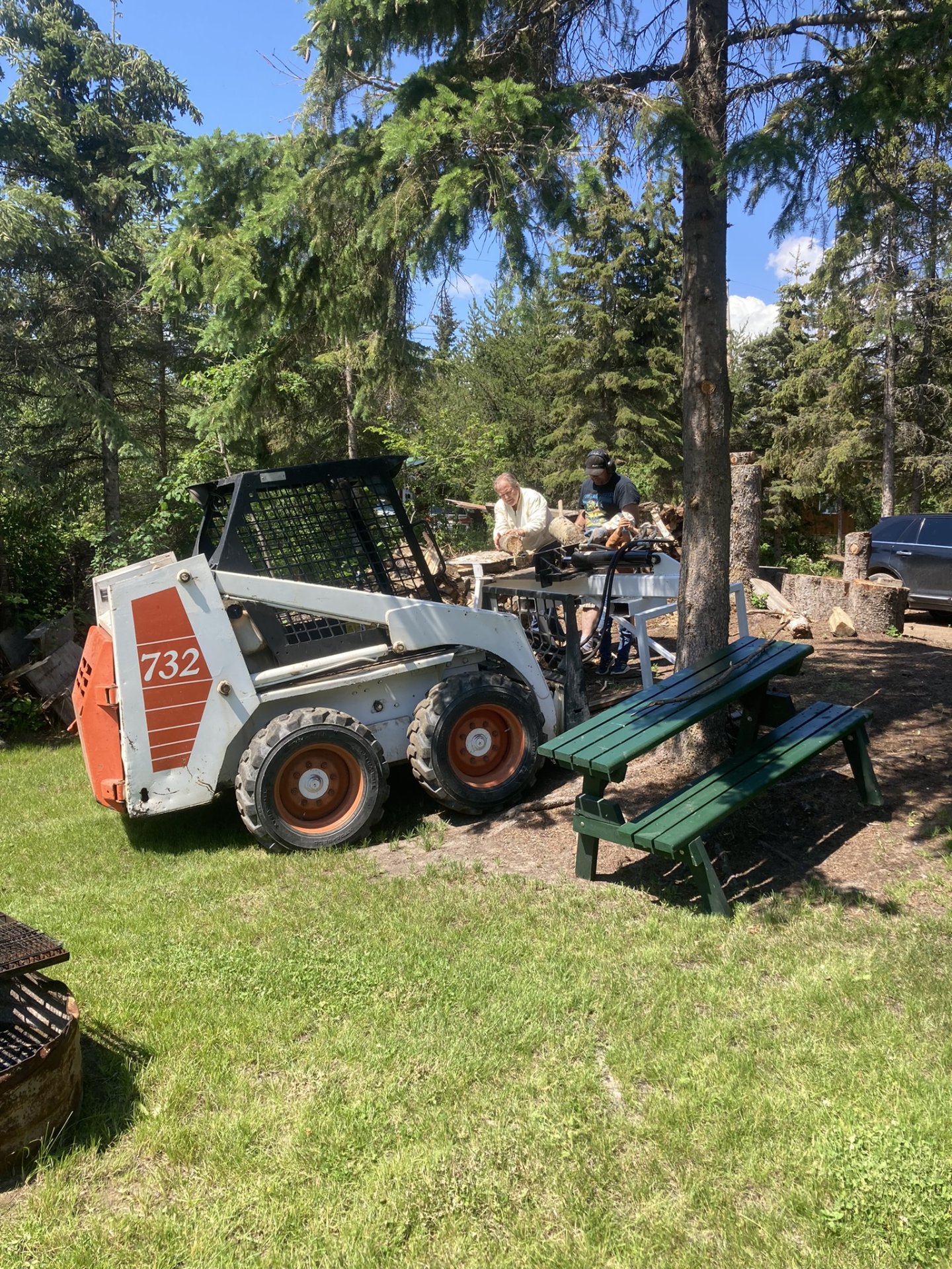

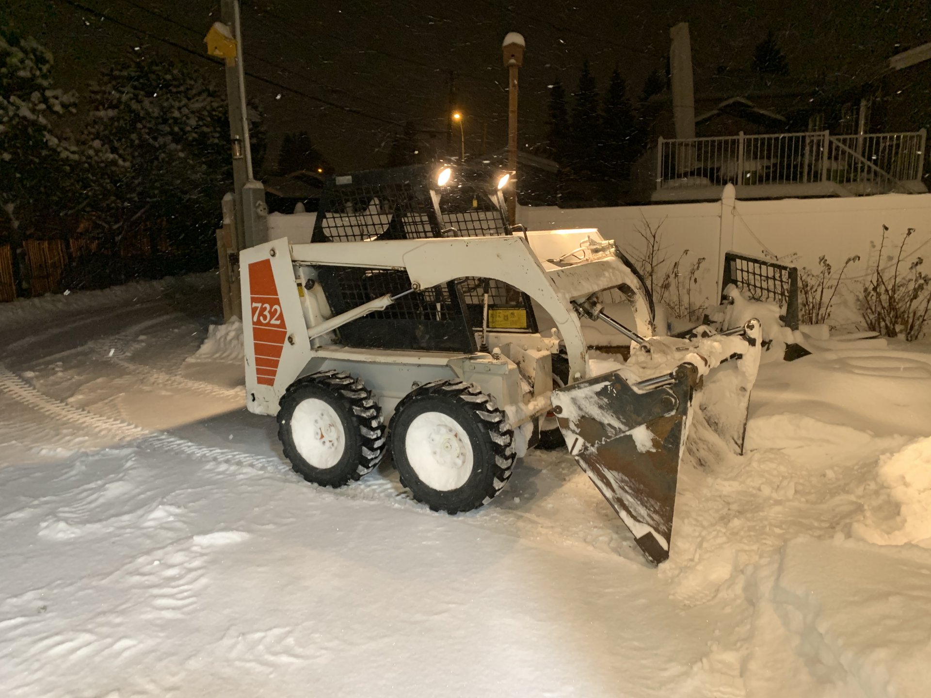

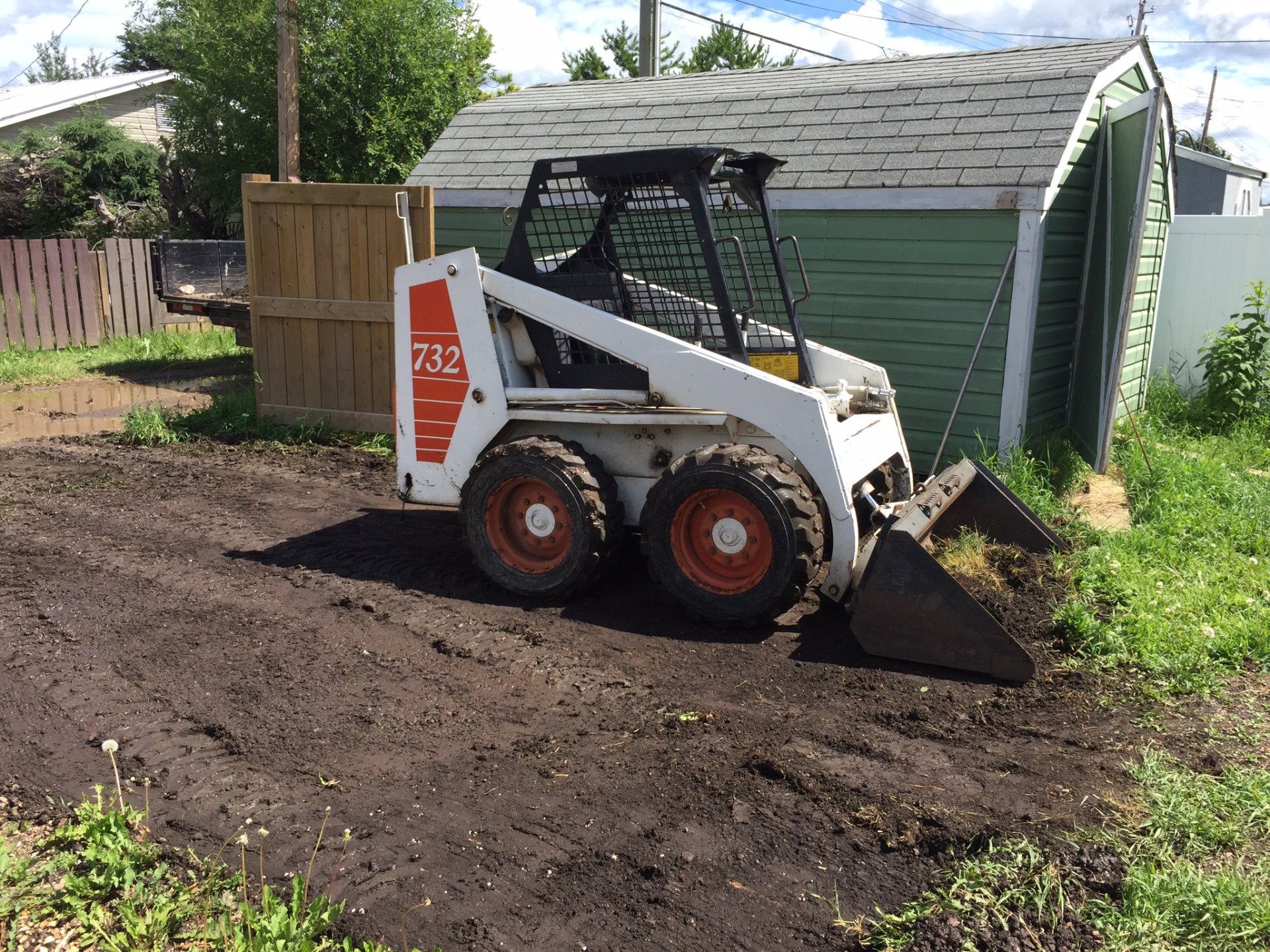

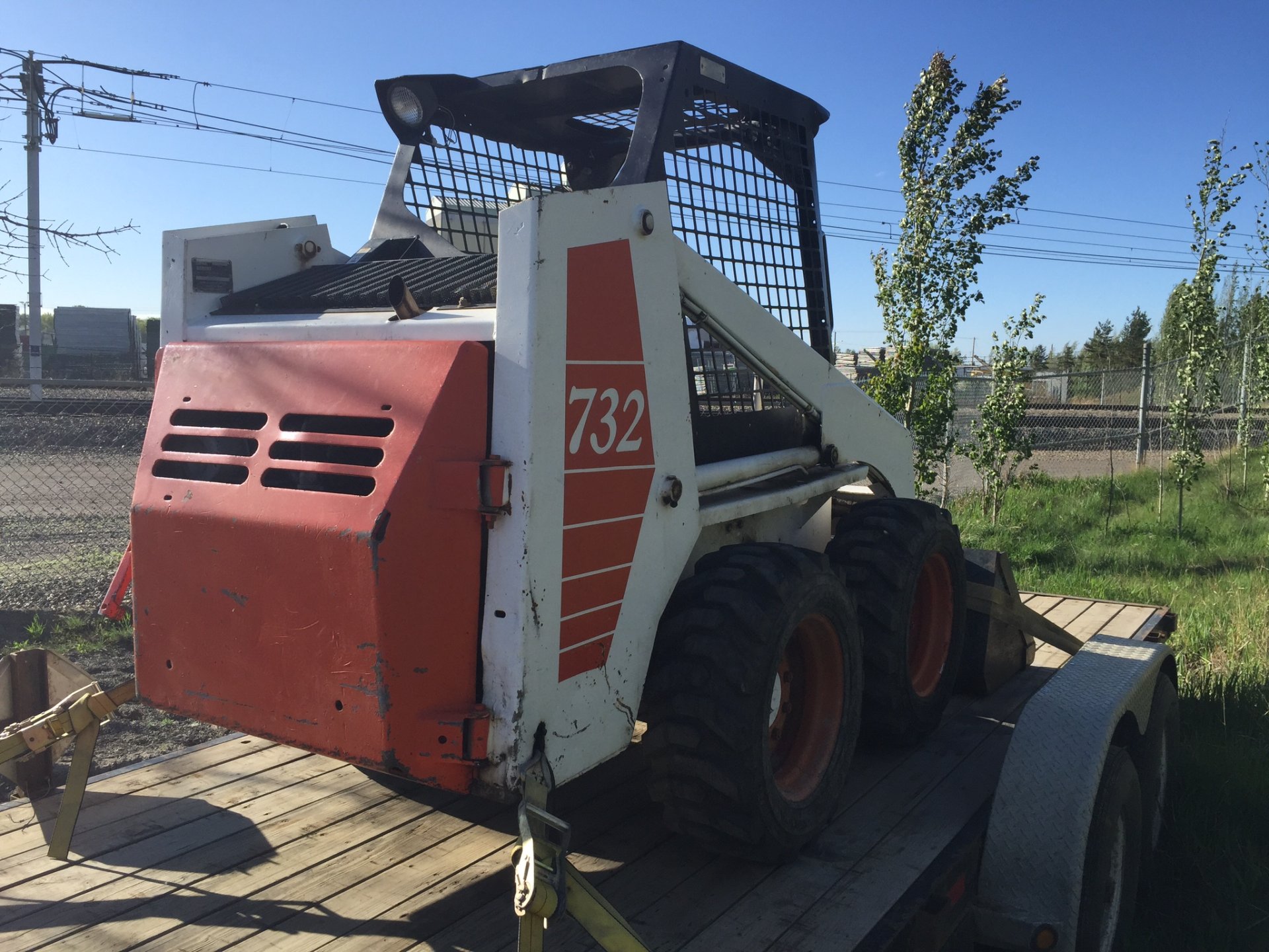

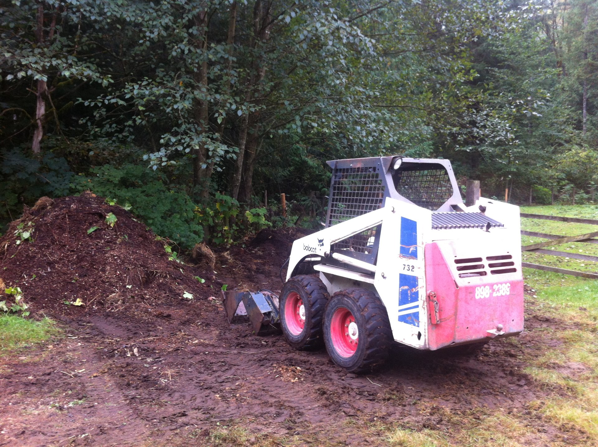

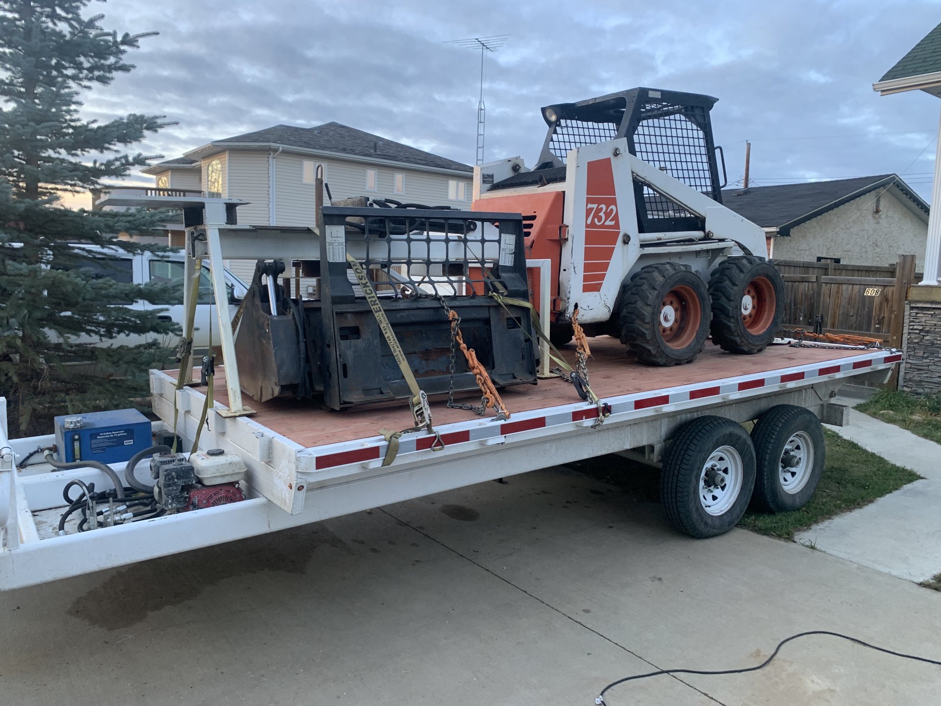

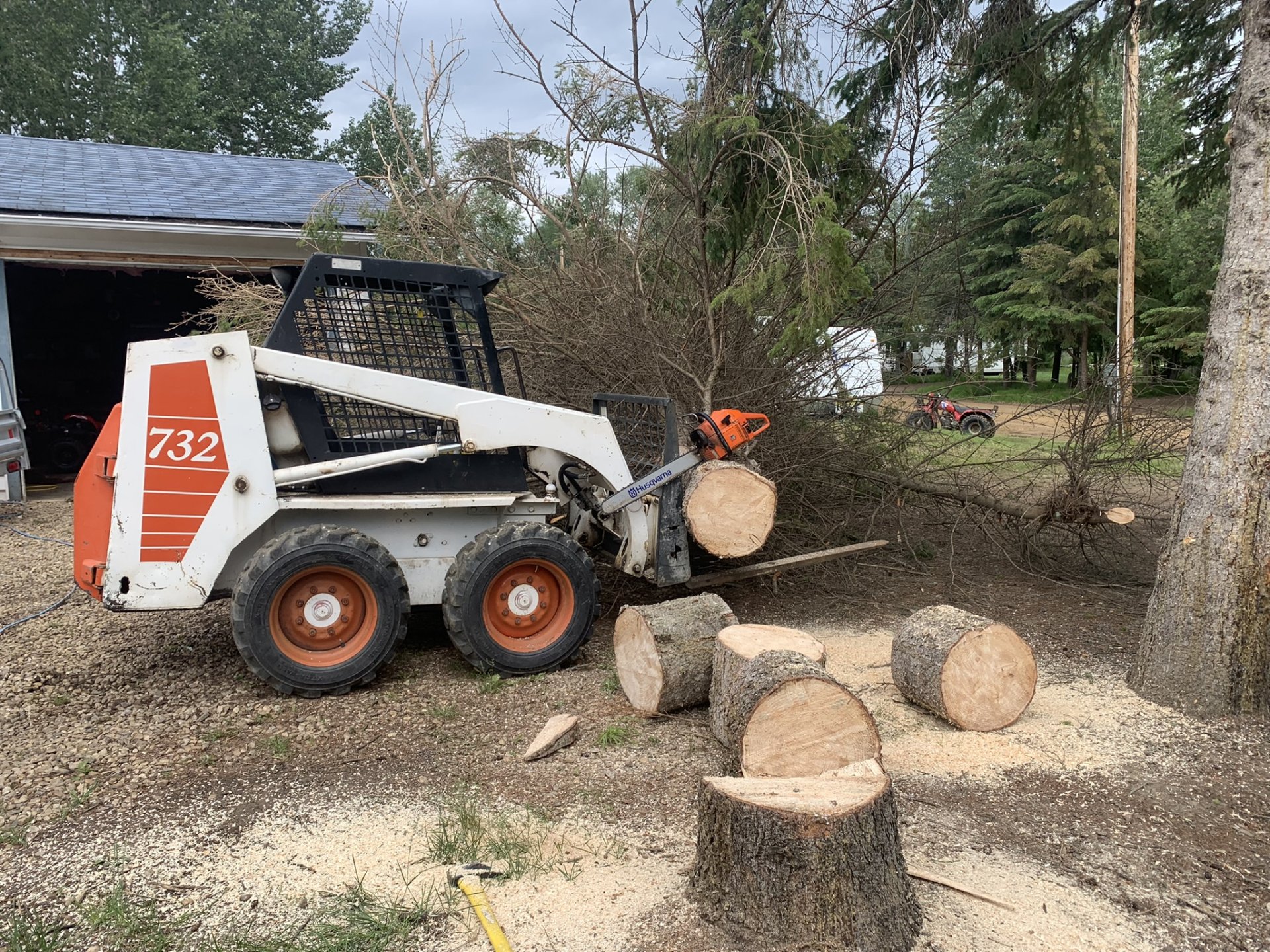

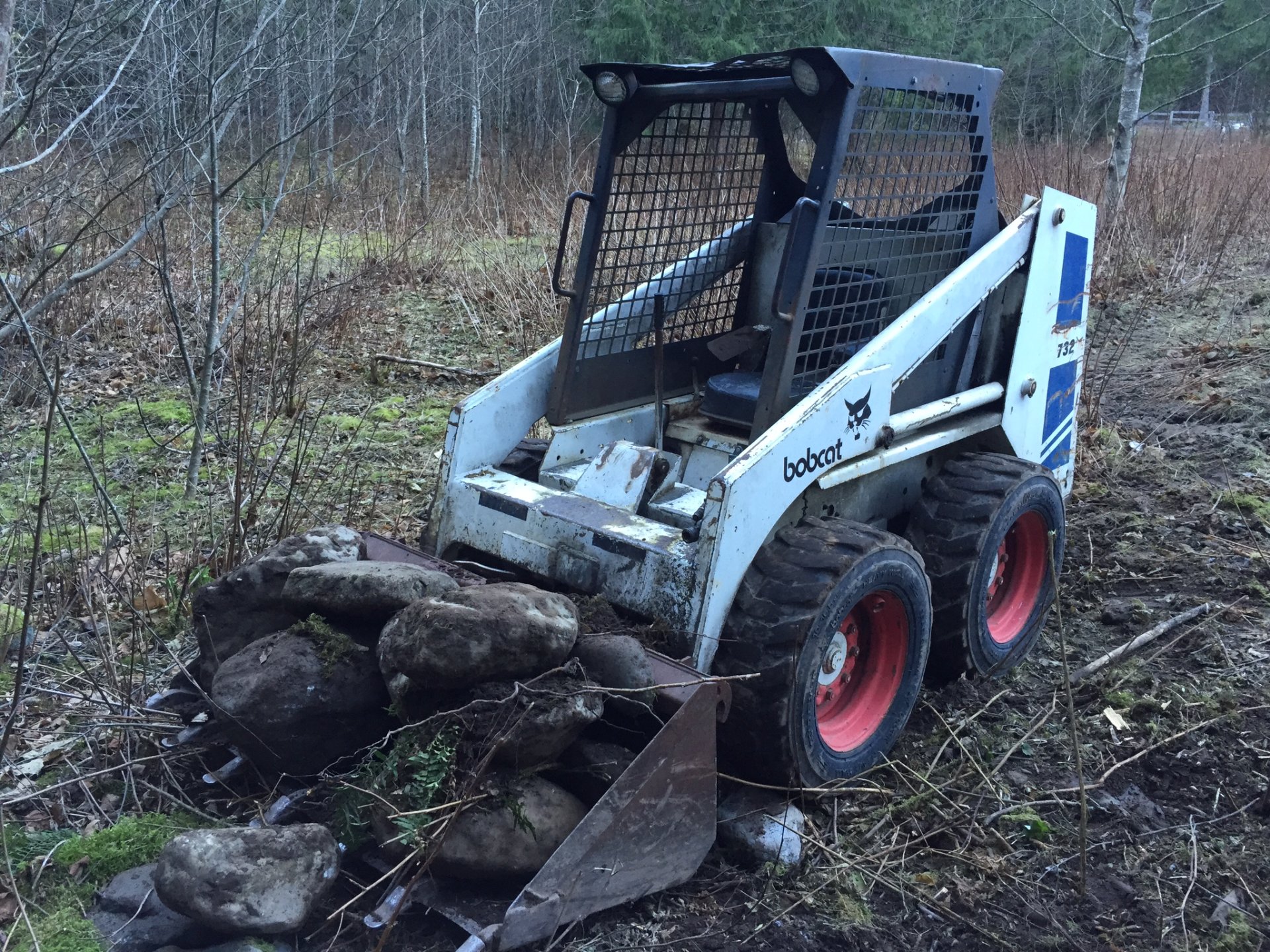

I have the 732 which is the big brother of the 632, same engine but a bit more lift capacity at 1300 lbs vs 1000. I use it for absolutely everything. My dad bought one in 1989 and it’s been in the family ever since, and I bought myself another about 7 years ago. Great little simple and very reliable units that even though they’re over 40 years old still do the same job a new one does but cost a lot less! I have a few handy attachments for them, the most useful I find is the combination ( aka 4 in 1 ) bucket. With that you can do just about anything! I find the 732 the perfect size machine for most applications plus it’s still easy to haul around!

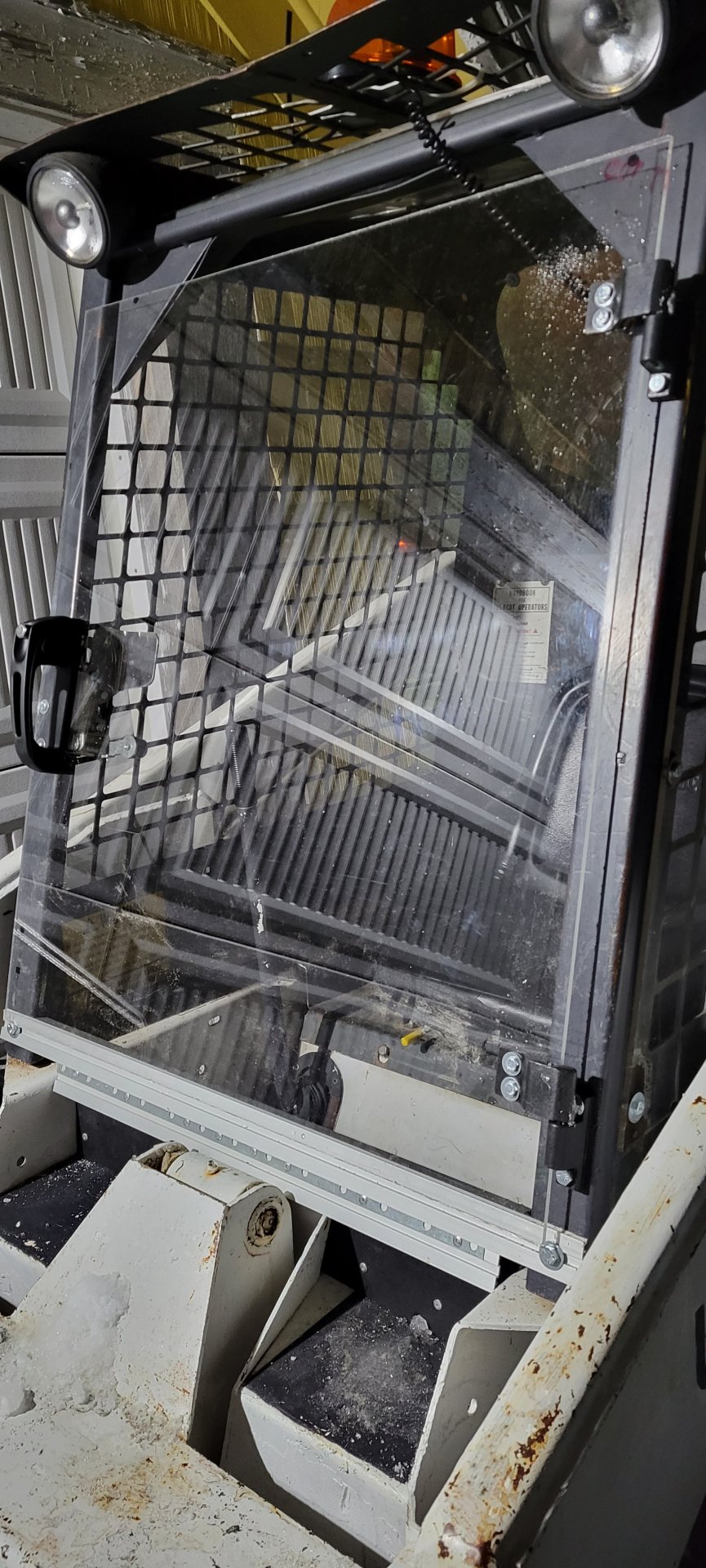

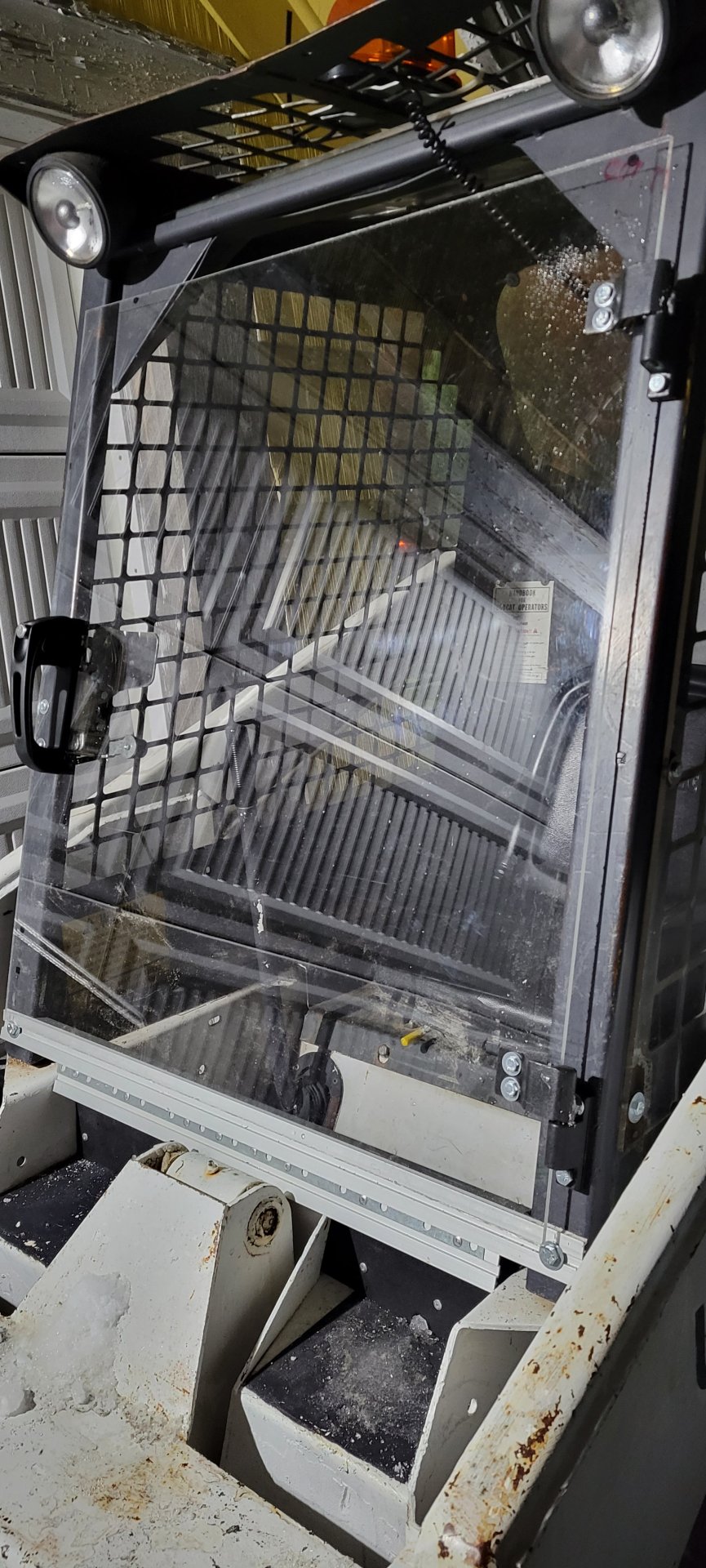

Nope, my back window is a hardware store plexiglass that's held in with fender washers grabbing the edges of the window opening.
Edit: I found a picture on my phone, and if you zoom in you can see some of the bolts and washers.
But, I looked at it tonight when I hung my homebrew door, and if I wanted out bad enough, I could probably kick that clear.
I would make that back window removable from the inside. Maybe hinged top or bottom, and held closed with heavy duty Velcro. but it's your call.
