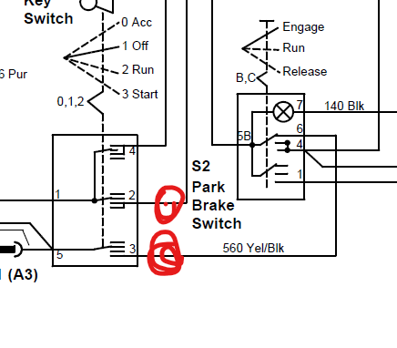

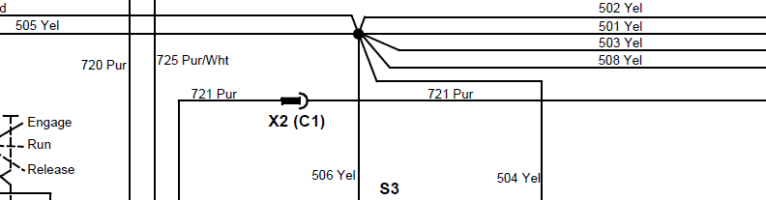

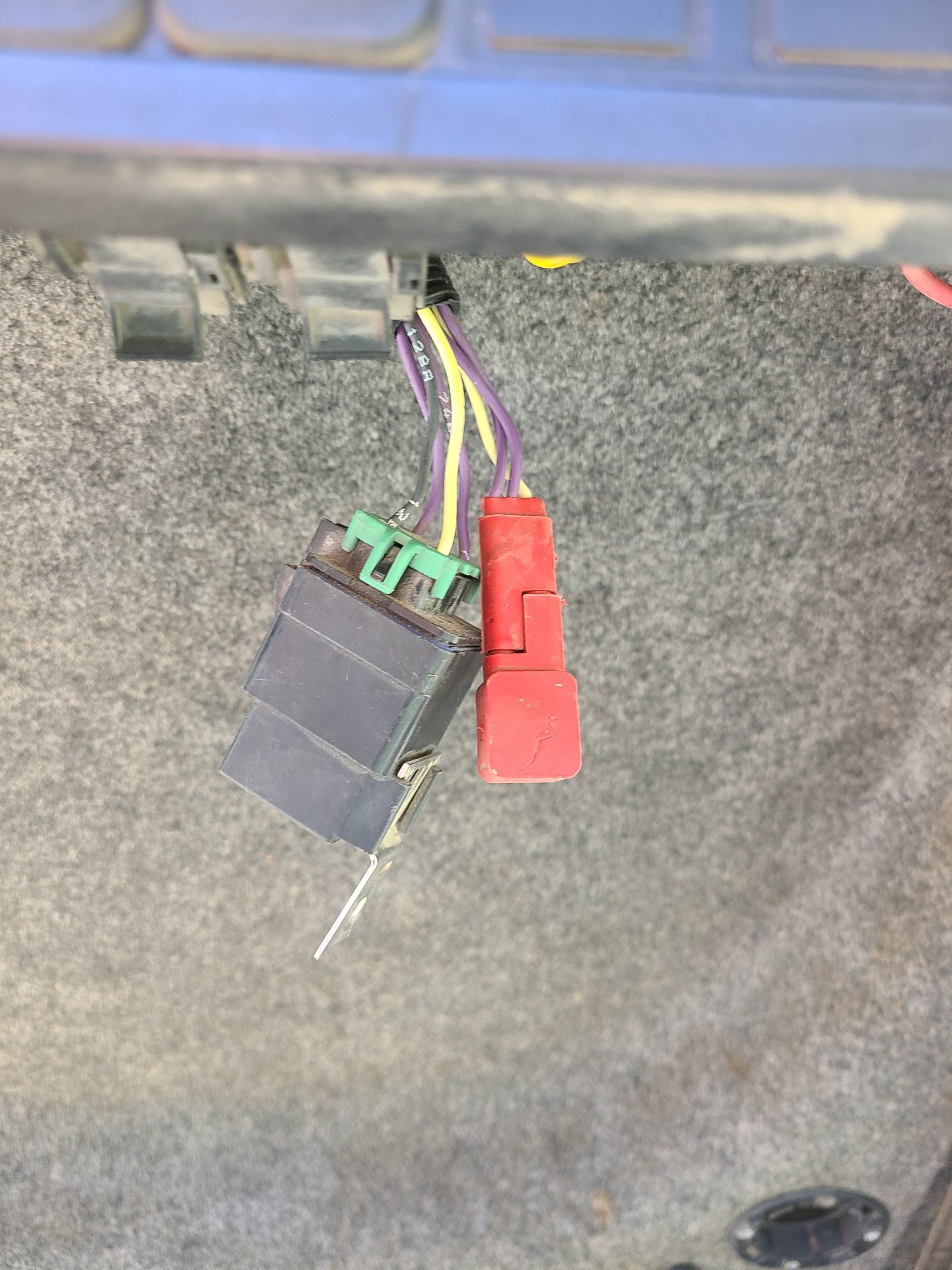

Hey guys! So I am having a problem with a John Deere 250. Went to start it, and as soon as you turn the key it is blowing the fuse. I am seeing that 2 of the wires going into the back of the ignition switch are toning to ground. Bothe end up going to a junction of a bunch of yellows. It has no Auto preheat, no high flow, so I know it is not those. I did however find a relay (that is not in the manual), with wires going to it 740AA, 740AB etc. (That are also not in the manual), and a strange red what looks like a jumper (but doesn't tone that way). I cannot figure out what these devices control. The 12VDC is definitely direct shorting. Does anyone have an idea do what to look for?

I think the red one is a diode, but the unit does not have High Flow, so it isn't that (and the wire colors/numbers don't match with the manual). Same with the really. Those wire numbers are not found anywhere in it.
I have no real clue what the relay is exactly for, or even if its original, or added on later
like maybe to run a flashing light or something, a previous owner installed
