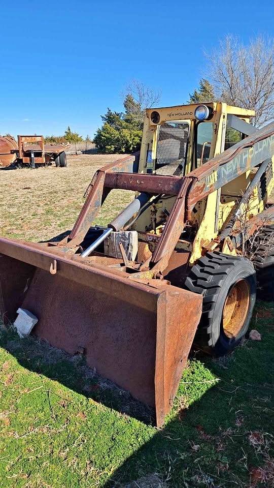

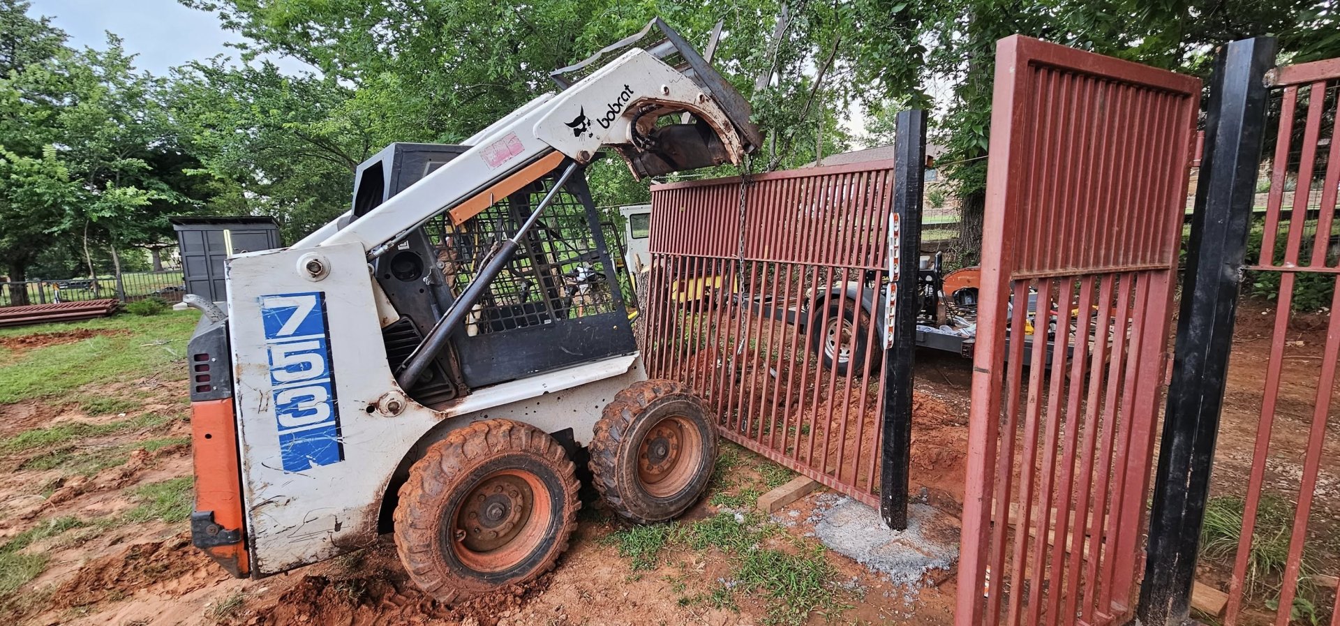

Hey there, I'm looking at picking up an L455 with no engine.
I have zero knowledge on skidsteers, but I have slept at a holiday inn, that coupled with youtube and i'm pretty much an expert.
I am currently using my neighbors BobCat for the past year and while he doesnt mind, and i repay him by doing all the maintenance and repairs. I do want to have my own.
I have a couple of acres of land, here in Edmond, OK and i'm always doing some sort of project that requires some skid steer assistance, mainly because i've got a bad back so i'd much rather the machine do the lifting.
Back to the L455, assuming that is even the correct model. I have yet to pick it up and verify the model and year. Hopefully I will go today, just waiting on the seller to confirm he can borrow his BILs FL to help load the L455.
My thoughts, my first thought might be crazy and it's probably just going to stay a wild idea.. but it would be cool to do an electric motor to turn the hydraulic pump, the electric motor and batteries would help with all the weight. but i also have zero knowledge in electric setups. Not that I couldnt figure it out...
My second thought is to put a v-twin engine in it, either a gx690 or a predator, i actually have a spare B&S v twin, but it has a conical shaft so maybe even that engine would work if i can fabricate the linkage.
I'm not afraid to weld and fabricate brackets, so in that regards i should be able to do the conversion.
So if anyone has any suggestions please let me know.

Hey @Dragos28 welcome to the Skidsteer Forum. What a great introduction and dating profile. lol Great photos too. Well, please feel free to use the search for anything you need and post all your questions in the forum so it gets more visibility. Looks like you've got a lot of work to do. Knowing how to weld is a plus!
first off , welcome to the site
I enjoy seeing folks restoring, fixing and using older equipment, rather than it just getting scrapped!
BUT that said, are you sure this is a project you want to take on? and please don't take this as a negative, and NO bash or likes meant here!
just offering some thoughts on things before you go into it!
as these older machines are getting much harder to find parts for them, as most all have been discontinued a LONG time now,
and I believe this model doesn't even have the modern quick attach, so finding implements , or having to add an adapter will be in the need, adding to costs!( I could b wrong, too hard to tel from your pic;'s)
add in the crazy prices hydraulic hoses have come to, and you can very easily sink a ton of $$ into a project past what its worth or ever will be!
so it will end up having to a project for fun, and not practical use here, is this what your after!
if not, I might suggest finding a better candidate to start with, that in the end will have you a useful machine for yrs to come and not end up with a machine that 's not worth what you end up in it!
best of luck to you no matter what!

Thanks, i traded a walther p22 that ive had for over 15. years for it. so worst case scenario, the tires are new so i can sell those, if i want i can part it out or scrap it.
my first attempt will be to power it up and see if the hydraulics work. if it does than i can give it more love, if it doesnt then i will decide to either pull the pumps off and scrap it.

Thanks, yeah i do hope it runs. i'm assuming the previous owner wouldnt have put a new cylinder on the bucket and new tires if it was running poorly. from what they said, they had it revved up really high and blew a rod out the block..
I think once you see the ridiculous new/used cost of replacement parts for these machines you'll want to start with something a little more complete and newer. These machines are nothing but money pits!
That may very well be the case. But im going to try and if it fails, then ill part it out and scrap the rest

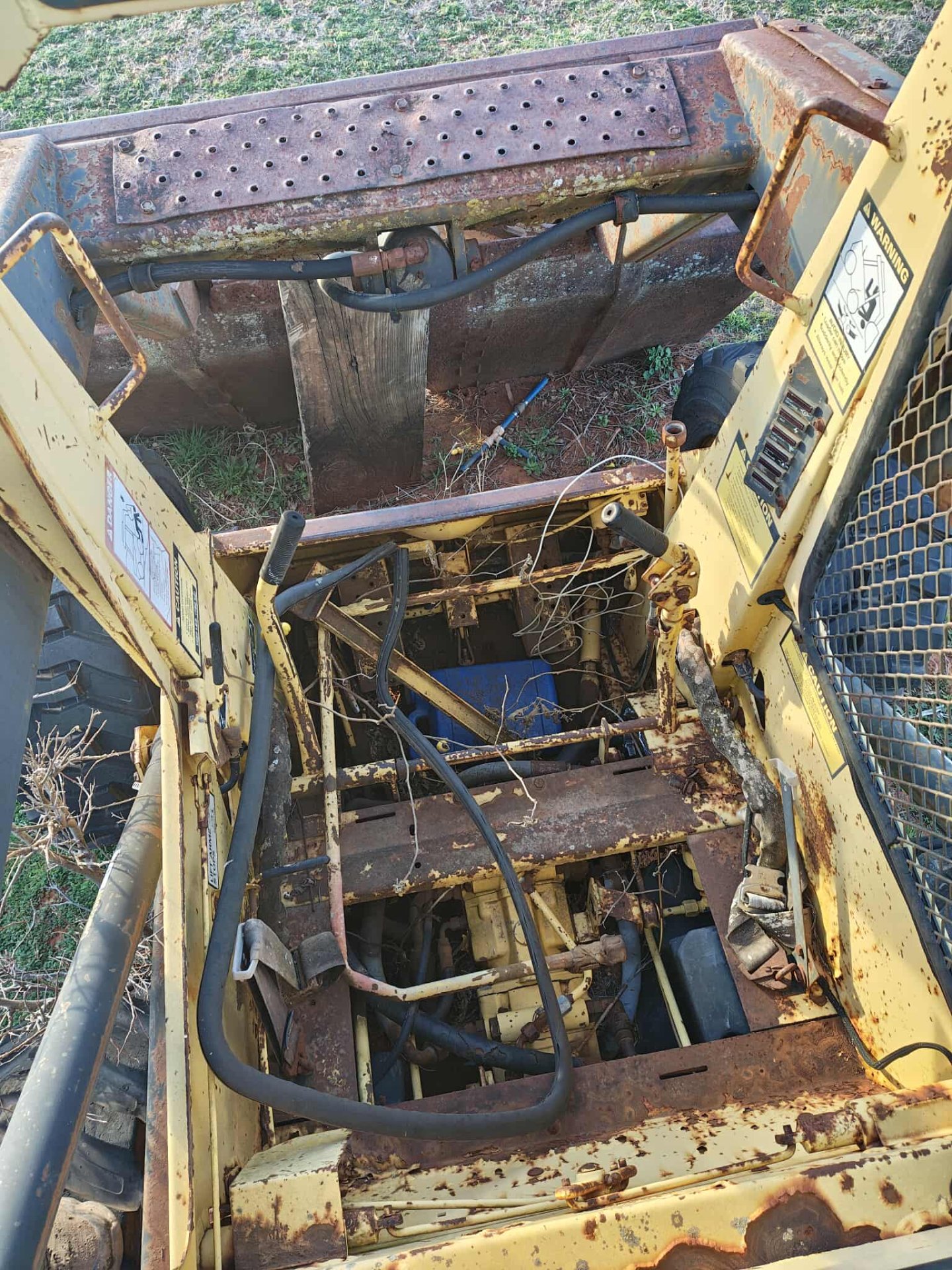

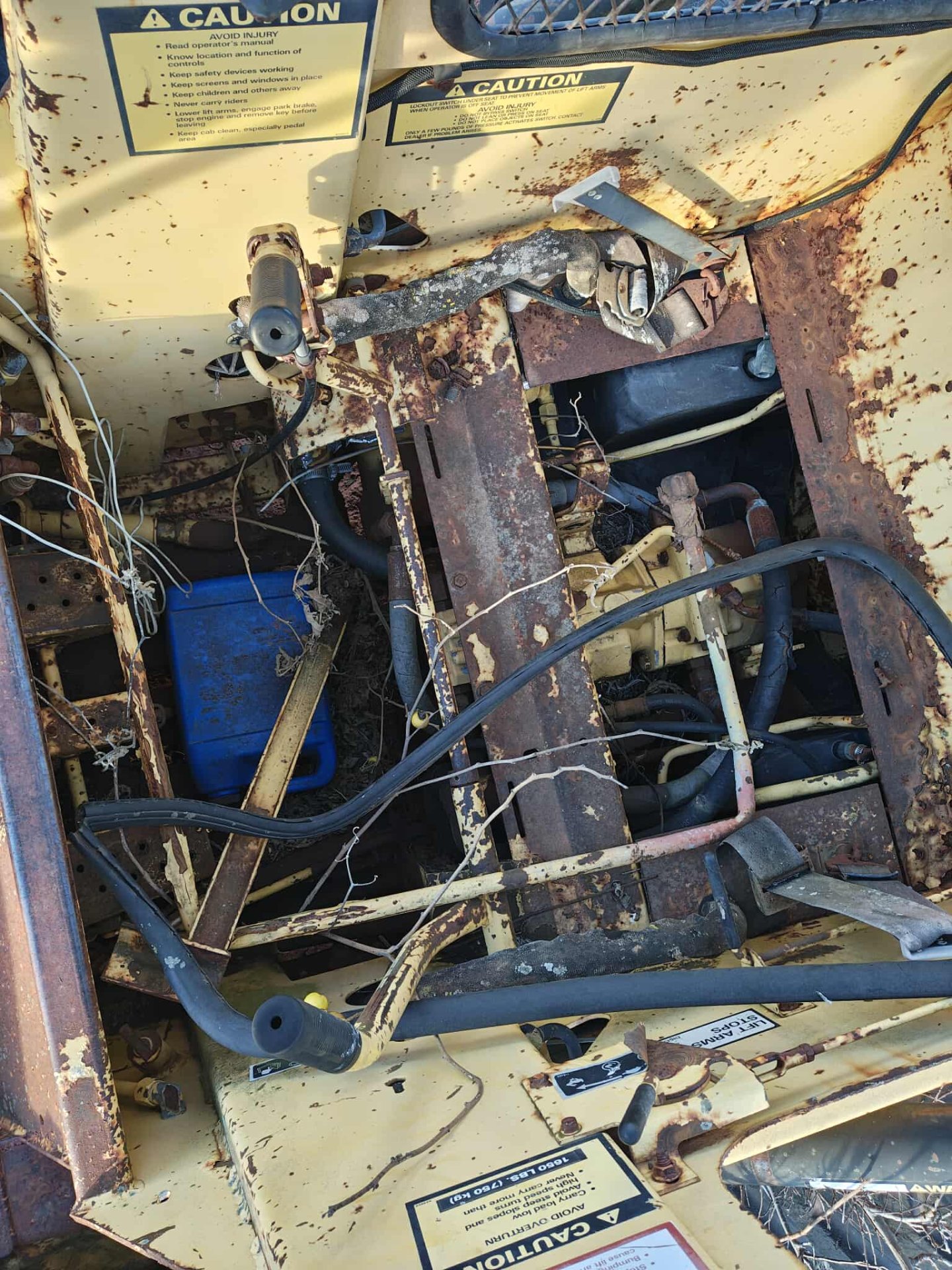

3) Based on pictures alone, I would replace all the hydraulic lines that are difficult to get to, I just replaced all of mine (minus the boom and bucket hydraulics) while I had the pump out for new seals, no it wasn't cheap at $1,000 but it was worth not having to pull the pump again.

Unfortunately not much progress other than degreasing and cleaning. Got most of my components in for the engine to pump linkage but ill need to use my neighbor's lathe and hes going to sell it to me! after he walks me through its basic usage. Ive always wanted a lathe!! He used to build and race stock cars and hes in his late 80s so hes actually wanting to sell off all his tools so I maybe getting a lot cool old-school fabrication tools.
