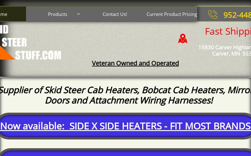

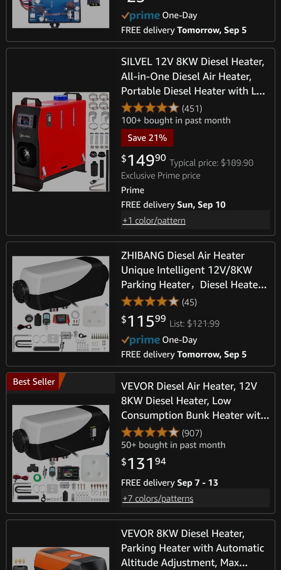

Do you have a link to the 2k heater your talking about?
This is just the first I pulled up
