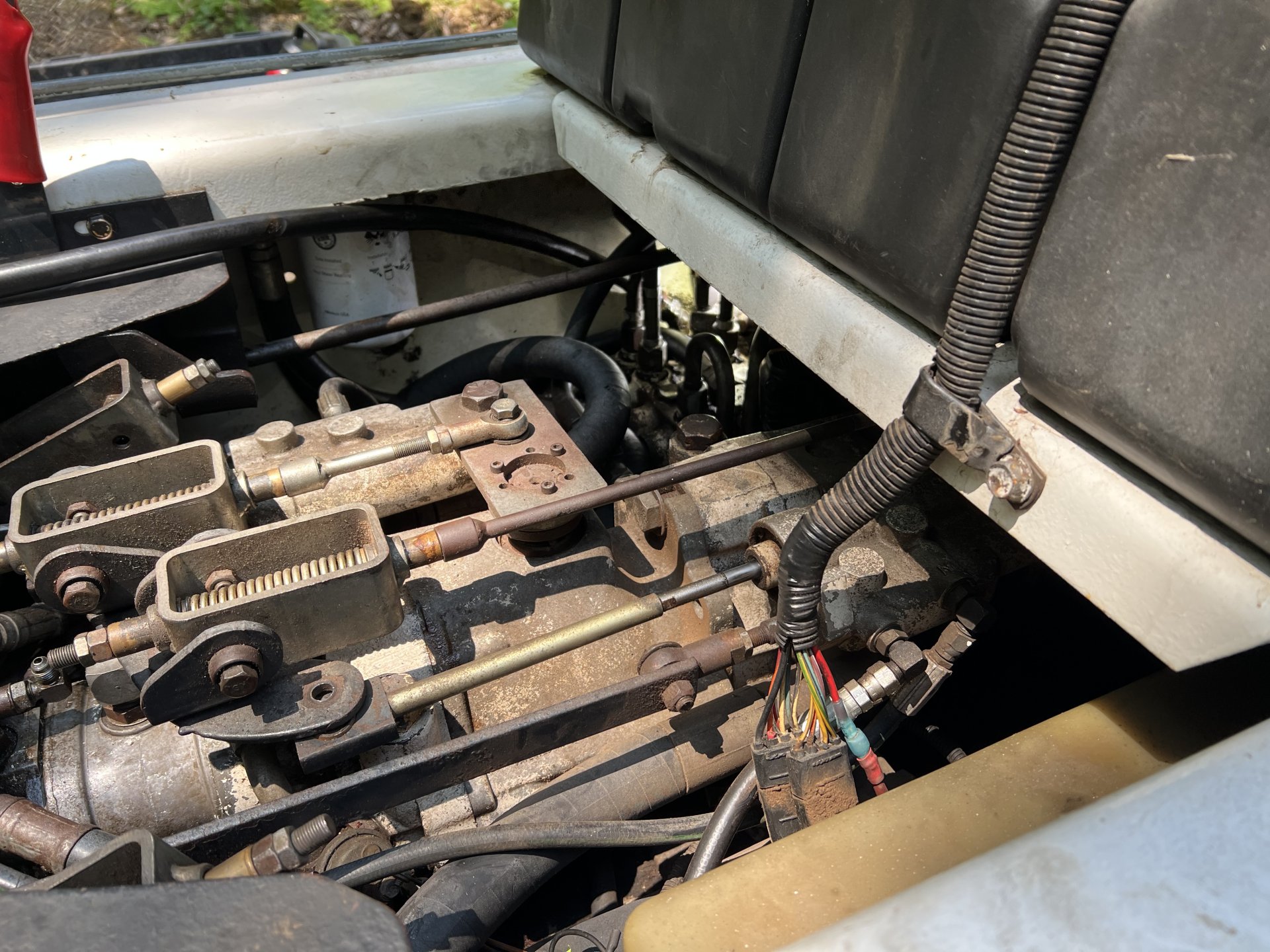

Boy I tell you what - I imagine the old machines are worse in this regard but I just had to replace the main hose going to the main control valve stack on my late 1980's Bobcat 843 and it was a nightmare (for a hose). I was starting to think I'd have to pull every other hose and hardline out just to get to it, but I bought a set of "service wrenches" at Harbor Freight and was able to get one on it after cracking it with a crows foot+extension+ratchet+wood-block which took me a half our just to pry out the crows foot... could get one finger on it.
Definitely don't underestimate the difficulty in servicing from a tractor - especially old non-ergonomic machines. I'm not a mechanic, but I'm 56 and have never paid someone to fix any of my cars or equipment, and this thing is a hassle to work on. It's just about access really - getting in position and reaching the thing you need to fix.... it's not that it's built poorly or overly complex.

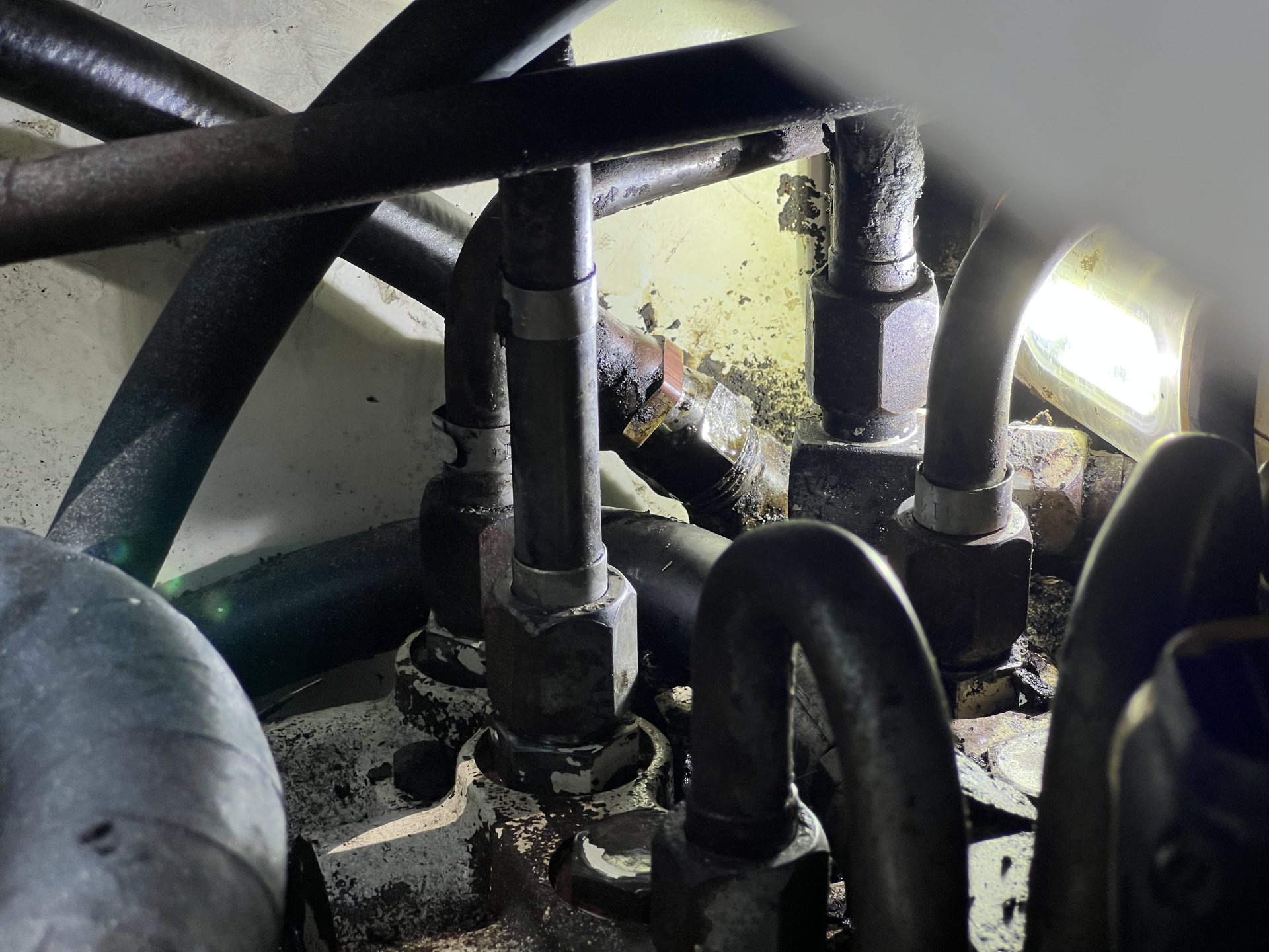

Yep, got an 89 bobcat 642 with the Ford gas motor. A couple years back I needed to replace 2 hoses under the cab. Pulled the motor and replaced all of them. Why? Two reasons. One was access, as I needed to pull other hoses to get to the ones I needed to replace, and two, at 68 years old, I'll not have to replace them again... Though my son might

Ugh - the motor? Was no surprise this one hose was the most chewed up and old of anything on the machine. I think P.O. gave up and decided was time to sell before he had to replace it. Finally popped on me, so I'm changing it out in the woods of course.

One of the tools I always keep handy for skid steers is a “sink basin wrench”. It was the only tool that I could get to some of the hoses on my A300. They are pretty amazing even though a last resort. The head swivels and the jaws are spring loaded. The handles can be pretty long also.
