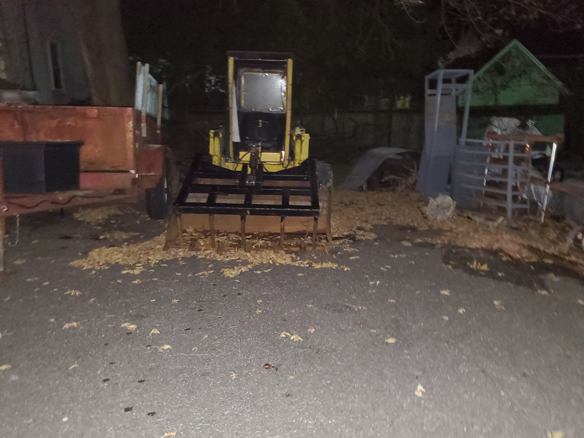

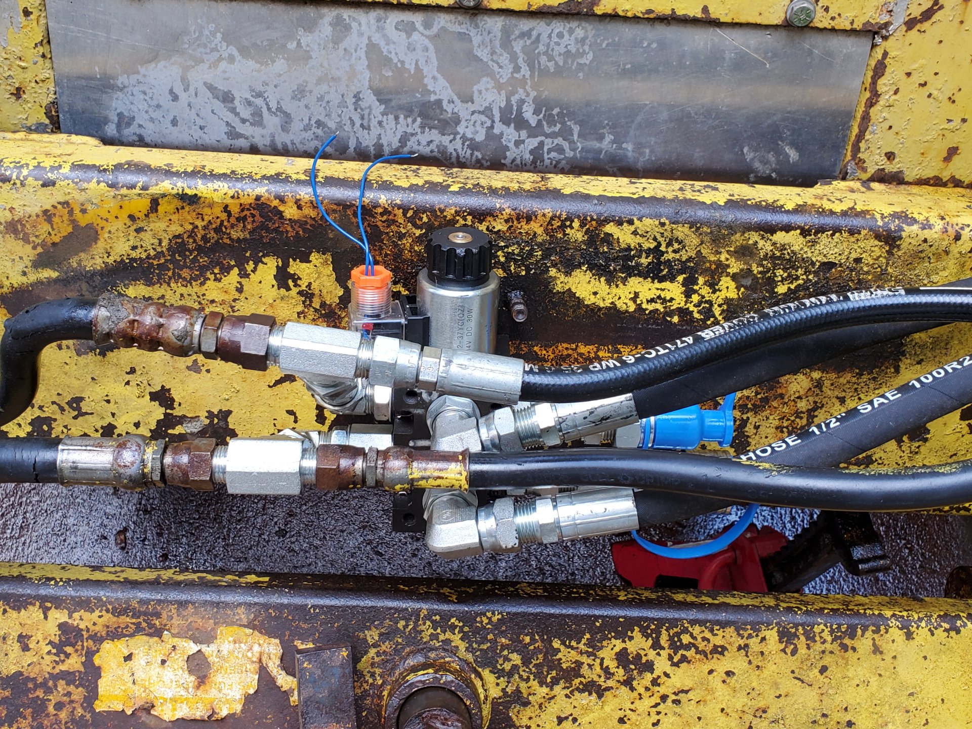

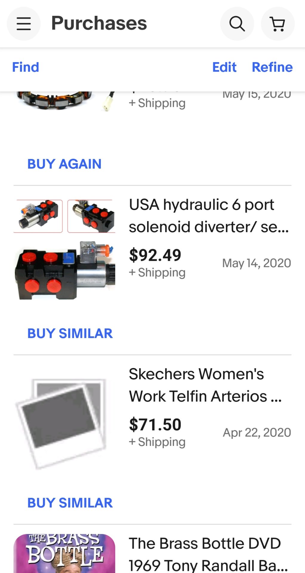

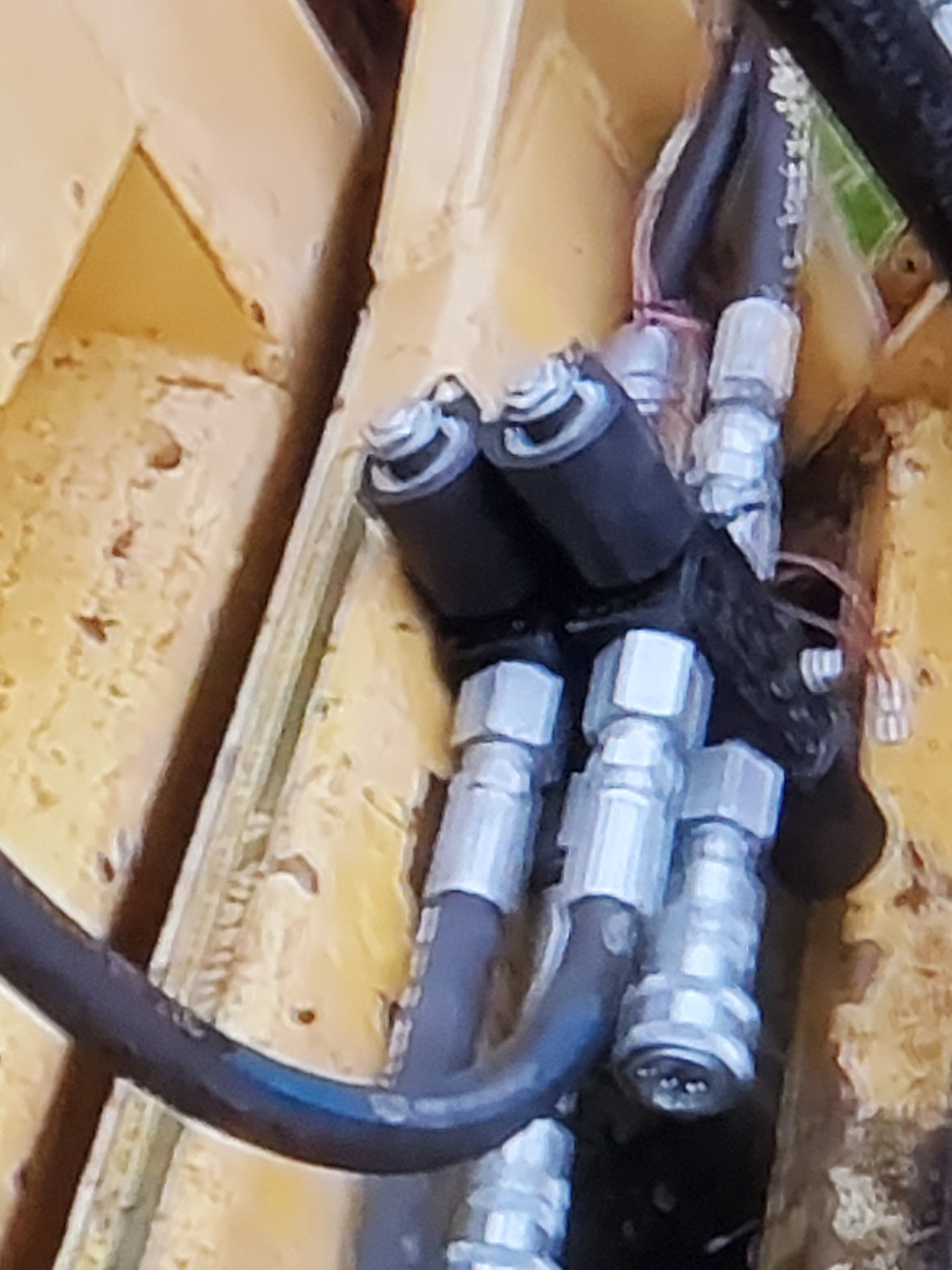

Mustang 345 .Third function installed was easy. I used a 6 port hydraulic block with a electric solenoid. 1 button and two wires + and - makes it work. The fastest and easiest way to get third function. You still have all the power and most of the volume of your system .I now have a GRAPLE. That works great. I don't know about running a hydraulic motor but a hydraulic cylinder works great .
