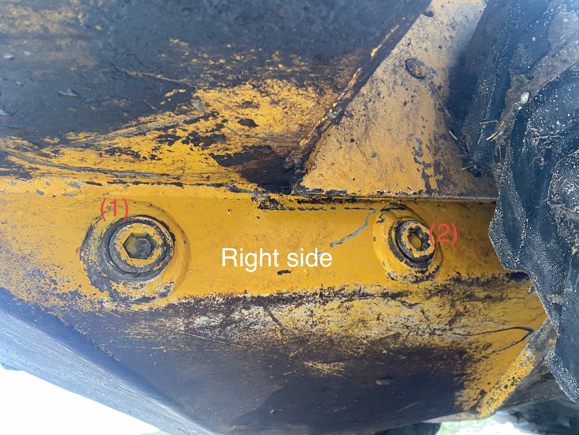

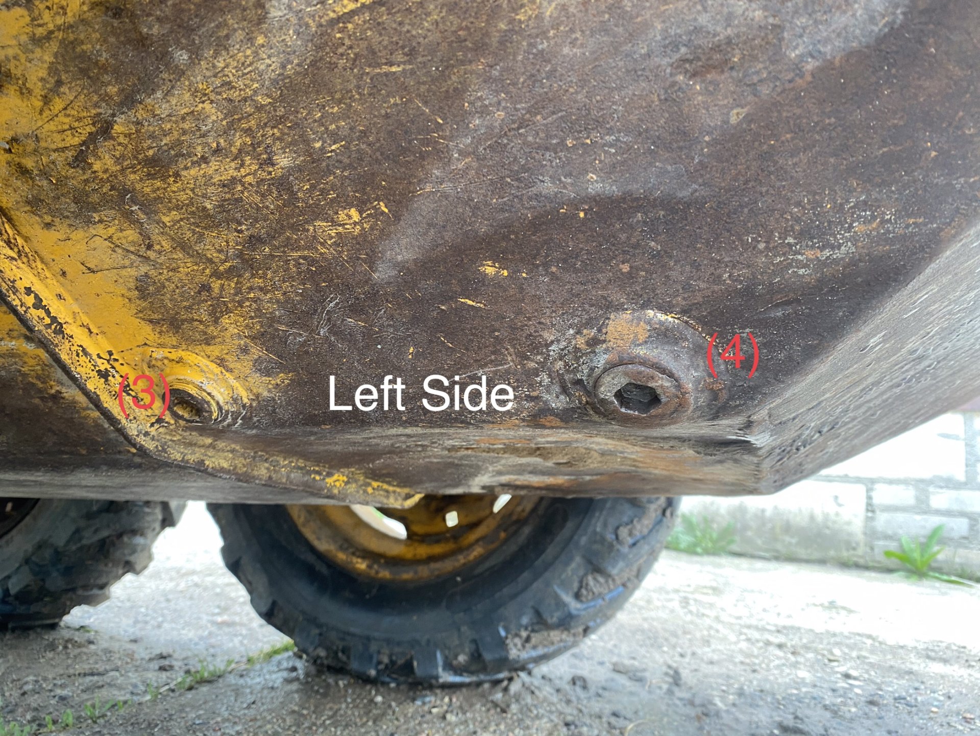

1. how to drain all hydraulic fluid from system? I see 4 bolts/ pins- two on the right side on back, one on the left side on back and one on the left side on back under skid steer

plugs 1,2,3,4 are to drain from hydraulic system ? I have to open all of or only 3 and 4?

you need only 1 of the bottom left side plugs to drain it doesnt matter which
chaincase & hydraulics different reservoirs
