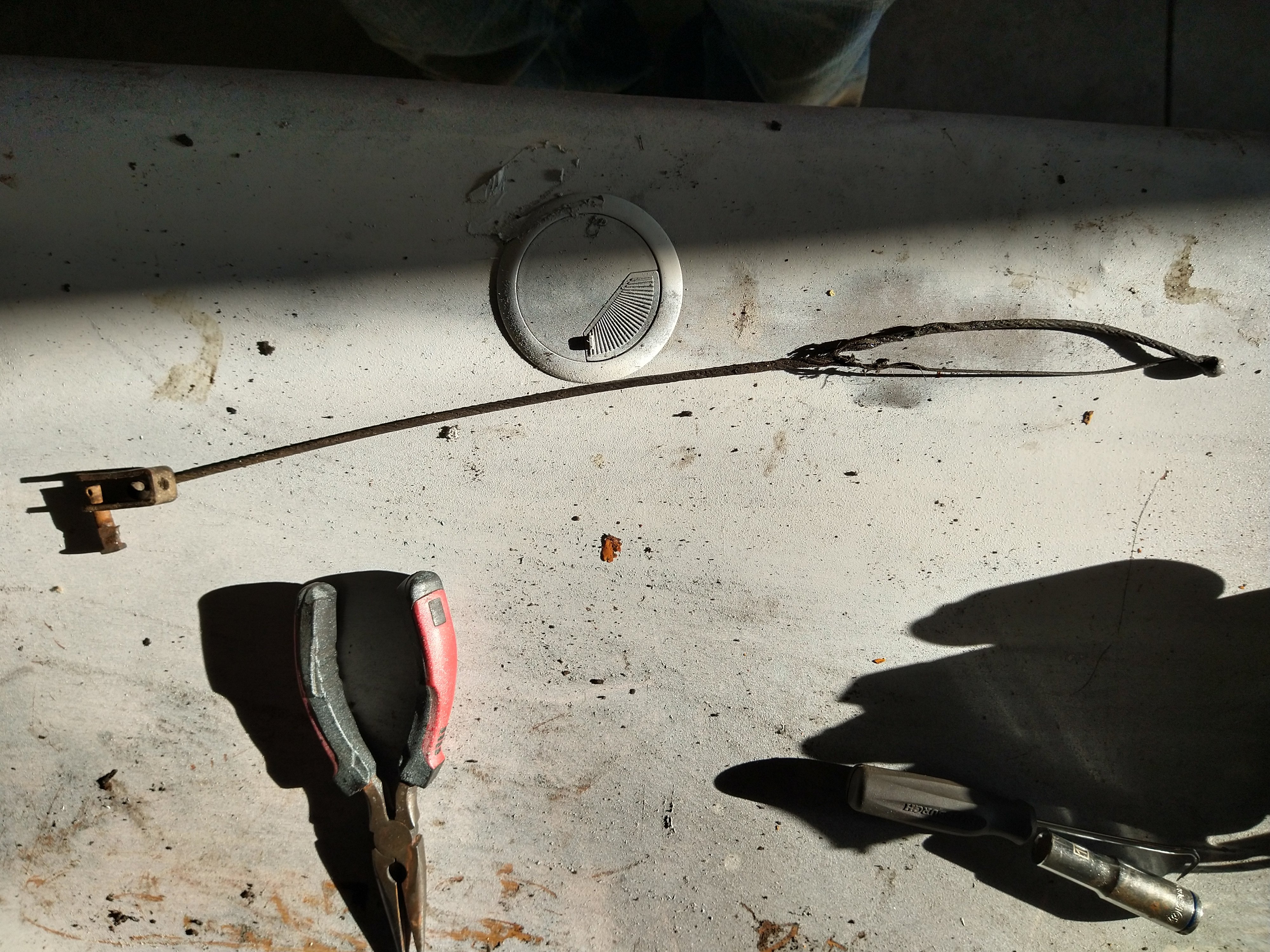

Well this is my luck, got my engine running great, new belt put on, and then my shift cable for the hydrostatic drive just broke...Anyone know where to get one? The cable that connects from the shifter to the pulley to engage the hydrostatic drives.

Cable # Is 050-29341 lindstromequipment.com should b able to help they show having several
Thanks!! btw how did you find the part #? I looked everywhere and couldn't find a diagram or anything, or perhaps I should look for the Gehl or John Deere version instead of the Mustang version?
I Worked At a dealership & repaired some of the older models, i have my own shop now, actually have a parts book on that model
mustang built JD for several yrs the 320 is same as a JD 90 U should be able to get on jd parts web site
and look up the parts for that, they used the mustang part numbers but added 2 letters to the front if u have a gehl or mustang dealer local give them the number they should b able to tell u if its available, i'm not sure how much is available at JD anymore
