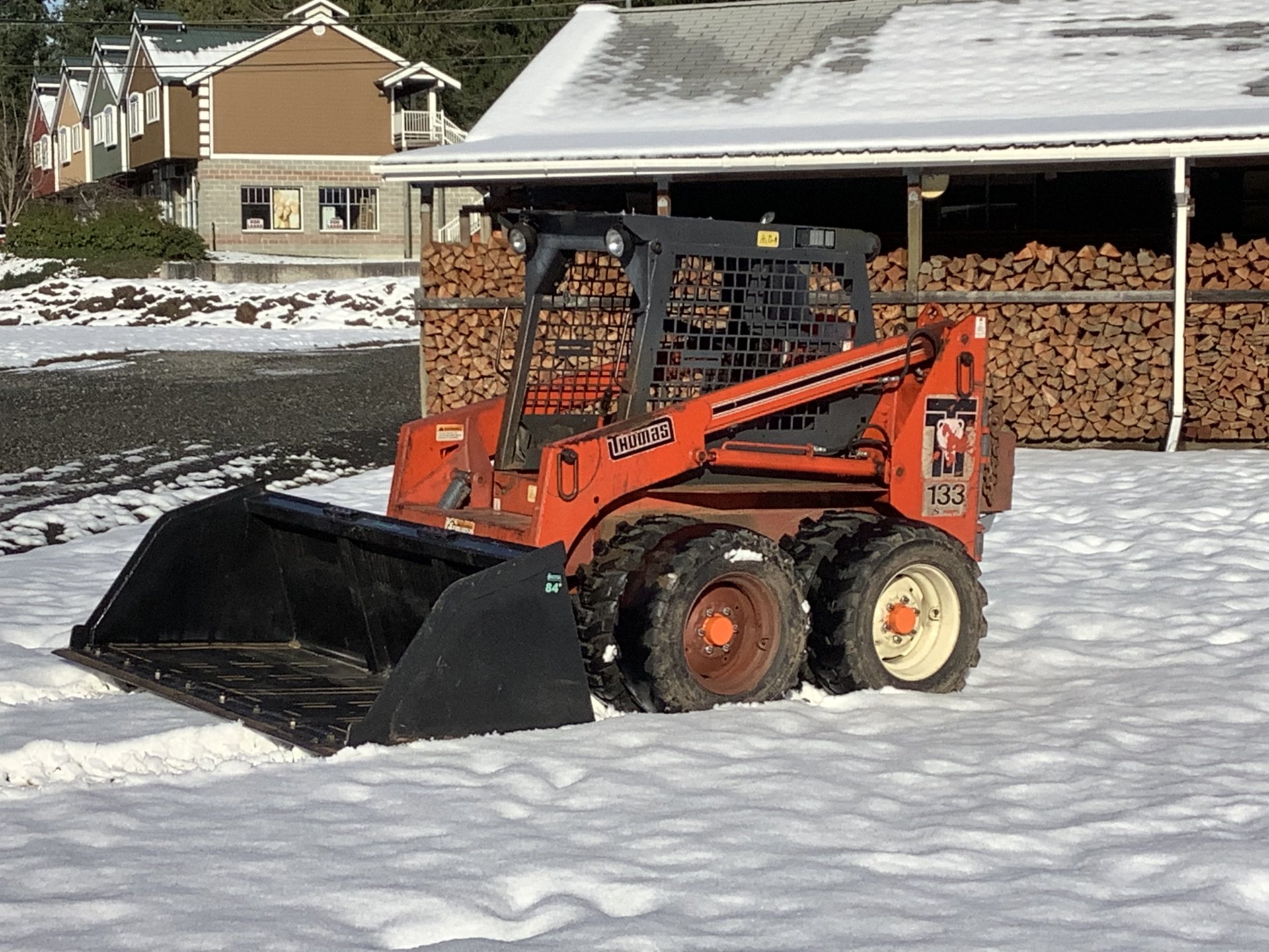

Does that have 6 lug wheels like my Thomas 1997 T-133S? If it does, all the after market wheels are actually put on backwards. Or that is the way I have to do it to make the offset work on my Thomas. Here is a picture of the dual set up I made a few years ago. I have a set of standard skid steer tires and a set of deep lug snow tires all bought just a few years ago. You can not put duals on a Bobcat because of the narrow design of all their machines. Works great for moving snow. Never seen anyone else try to do this. Have fun and be safe!

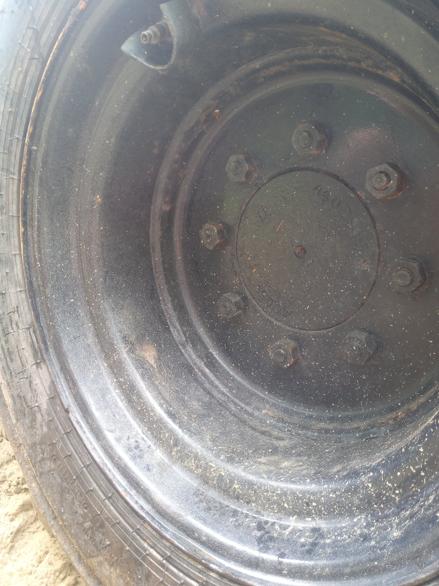

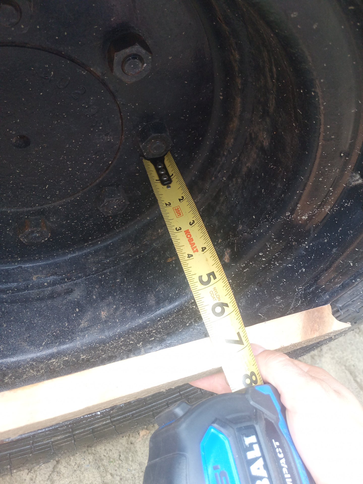

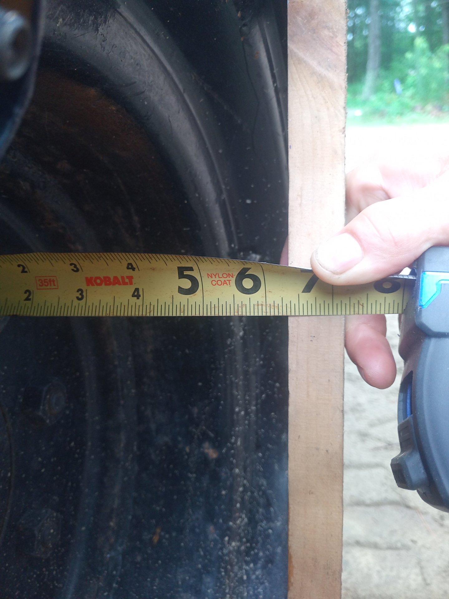

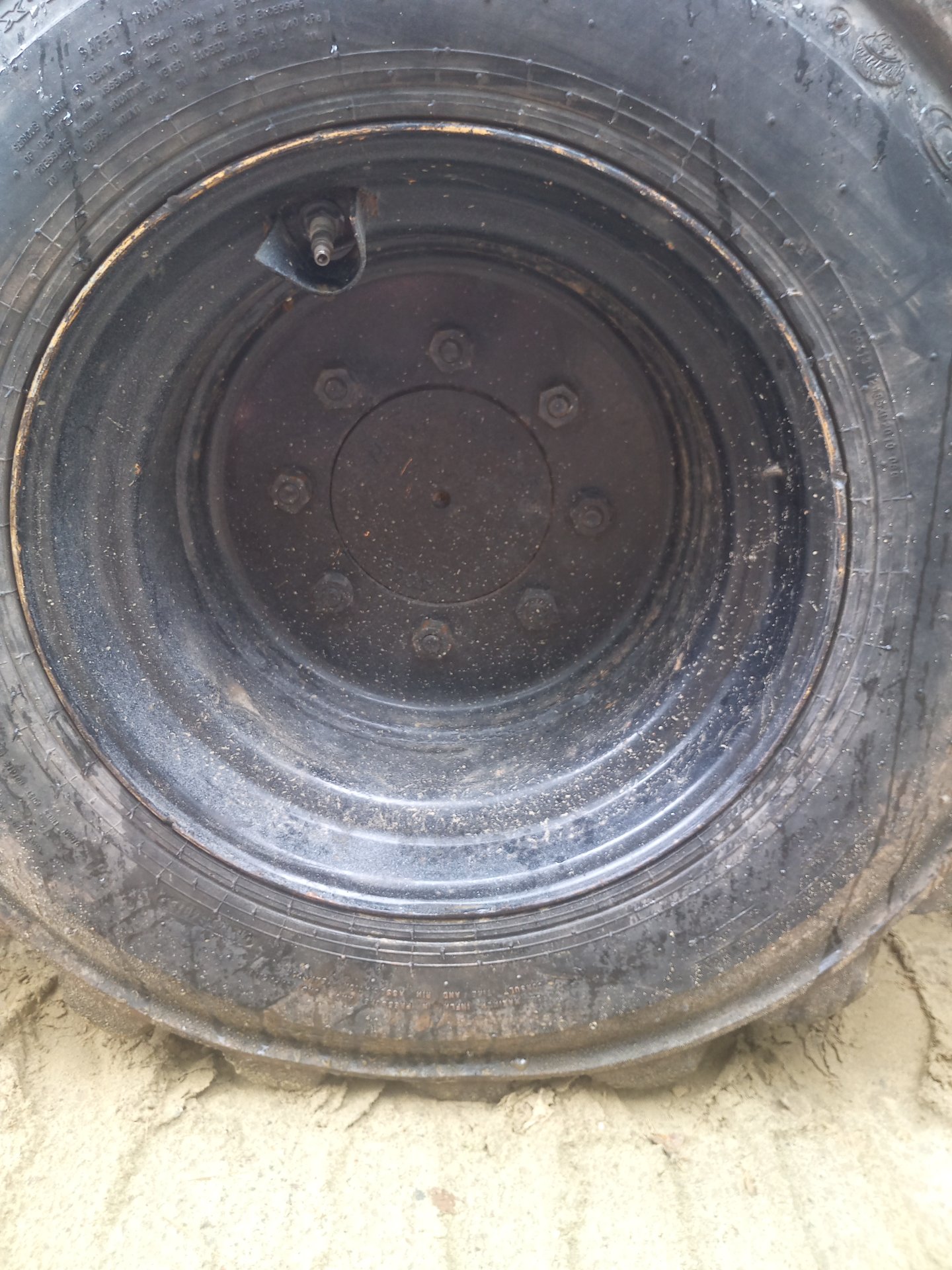

feast your eyballz

look like the Hd to me, they do not have a stamped center like std duty but actually had a center made of roughly 1/4 inch plate steel
